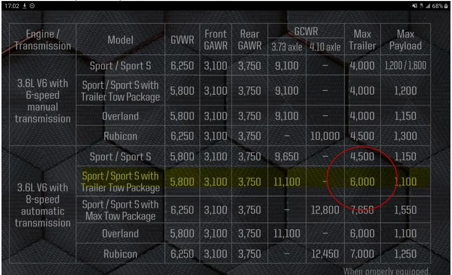

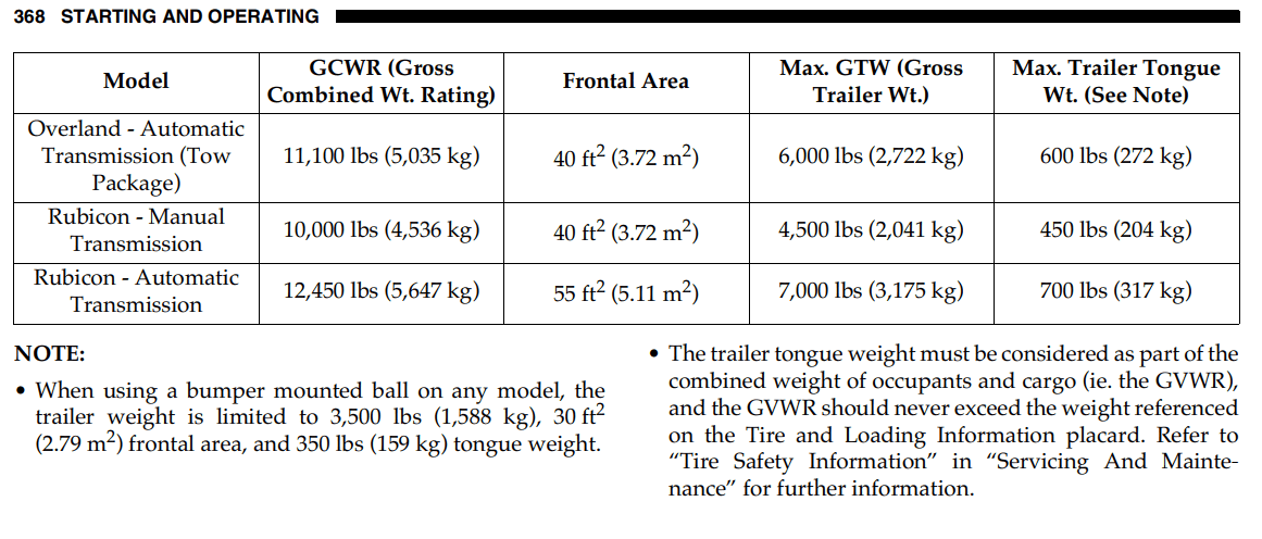

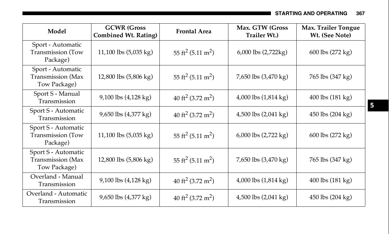

Towing capacity is well known and defined on these and found in the owners manual, Jeep dot com, and their sales brochures.
This is found in the OWNER MANUAL, this is from my own owner manual -
Jeep Gladiator Tow package and Max tow package are NOT the same! 1641861648249
Jeep Gladiator Tow package and Max tow package are NOT the same! 1641861690729
