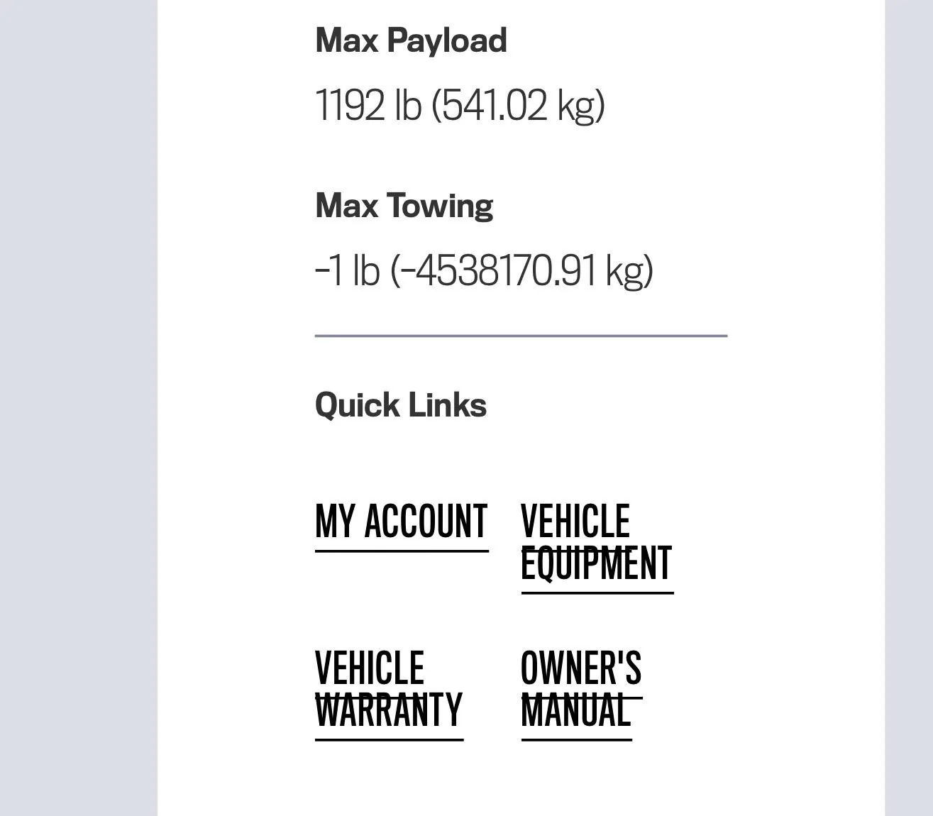

Anyone else get this on mopar site. I have a Mojave and it lists my tow capacity as -1lb or -4.5 million kg?
Jeep Gladiator Tow package and Max tow package are NOT the same! 5F4B0337-008F-41DB-AA53-932F5B3DE218
40,496
54,011
Ignore that site. Don't know why folks are putting any stock in that since so many come up with such bogus numbers. Some have -1 and others have crazy high numbers.
The door jamb sticker are the only numbers that count.
The web site says mine will tow 6300 pounds - HAHAHAHAHA - I laughed at that, no way, not with the 3.73 ratio and that engine. That's 300 over what anything else says, and even 6 is more than what I'd trust a stock Overland with.
Since when is 1 pound equal to 4.5 million kg............
