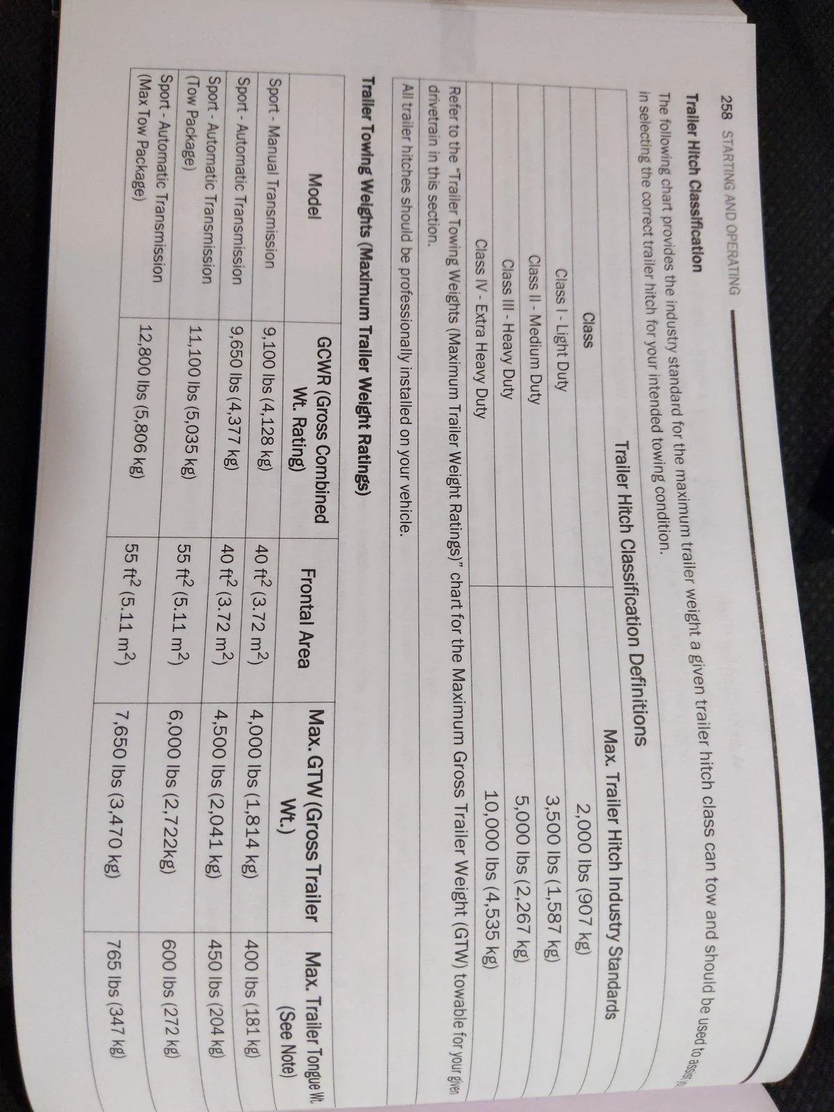

Jeep does a poor job with specifying the tow capacities for the various models, power trains and option packages on their web site. The only numbers I can find for the Sport S is with a manual trans., 4000# or max tow (w/ auto - which is the only trans available) @7650#. Based on other threads in this forum and non-Jeep sources it appears that the tow capacity w/ an auto bumps up to 4500# but is that with or without the standard two package? I've also seen reference to a 6000# capacity for the S (maybe auto w/ standard tow) - really confusing or maybe it's just me :) ? There is no official tow capacity table from Jeep, at least that I can find? Maybe they are trying to get you to contact or visit a dealer to get actual spec. numbers? Does anyone have the official numbers?
The owners manual says a Sport S with tow package (not max tow) is 6,000 lbs. You can look at your specific Jeep on their website and it shows its towing capacity. Mine is over 6,400 lbs and it's a Sport S with regular towing package. More than plenty of towing for my needs, and it's funny because when I asked the dealer he told me 5,000 lbs. I have no idea where they pulled that number out of.

This is listed in the Owner's manual:
Jeep Gladiator Tow package and Max tow package are NOT the same! 15999161051426724302653479508204
Sorry if you have to turn your phone, but clearly states Sport S Auto with tow package is 6000 lbs

I've built and priced various config's on the web site and I couldn't find a corresponding tow capacity - but hey, my eyesight ain't so good.
This is perfect - thanks! Why can't Jeep just include a similar tow capacity table - by model/ type on their web site and don't clutter it up with all the marketing BS!
The only place to find the legal and engineered capabilities of a JT AS BUILT, in other words, with your options and so on, is on the door sticker.
If anything happens, that's what the insurance company and perhaps even law enforcement, will look at.
You can't go by that web site if you are referring to the mopar site you log in to....... that's had some at 8,000 or even a MINUS 1 (-1)
It's way off base on my towing, but fairly close on my payload. Others it isn't even close.
The door sticker is the legal say.
