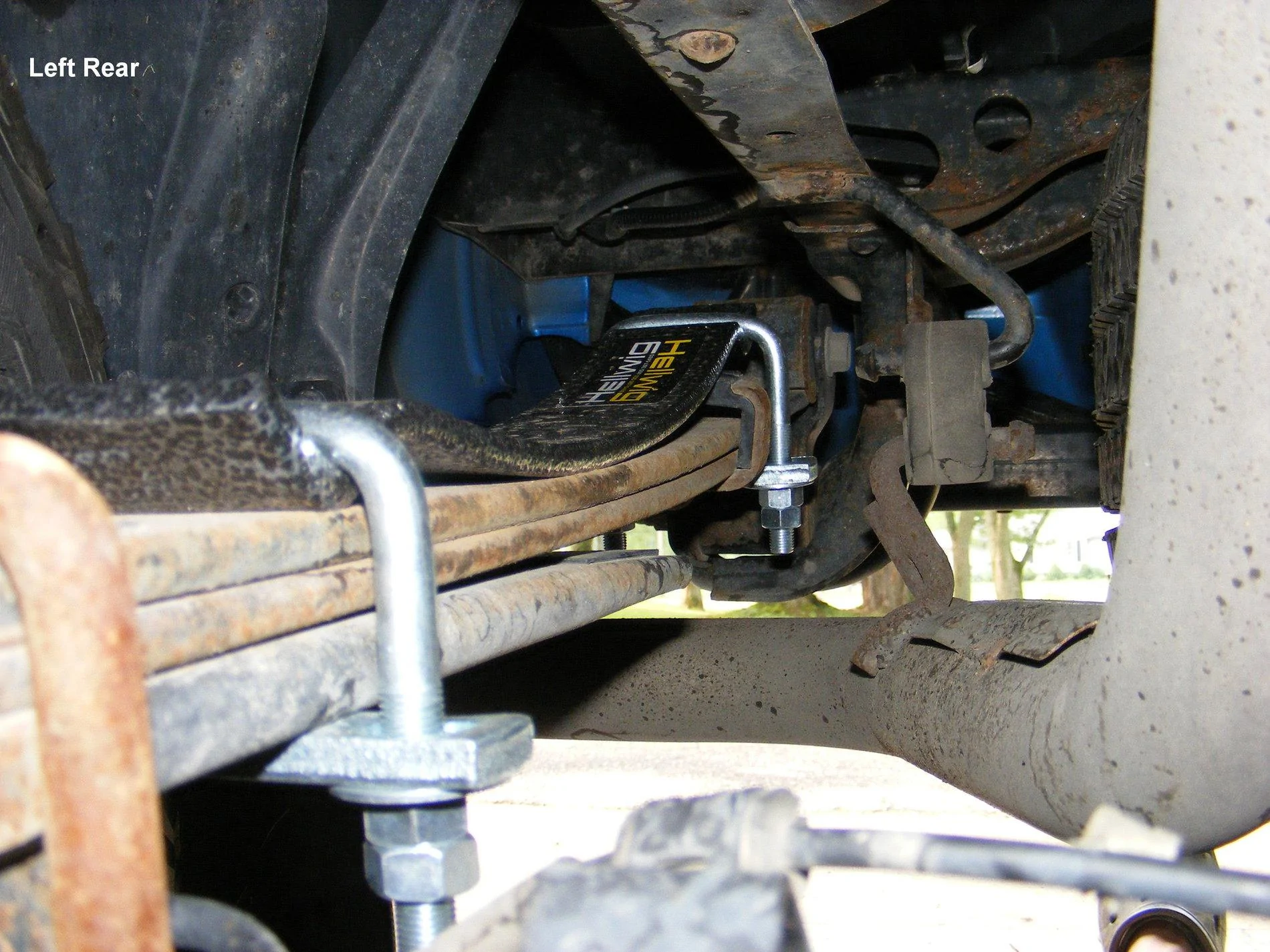

I've owned three 2nd generation Tacomas, a 2005, 2007 and a 2015. All three had a TSB call on the frame where Toyota "coated" it after inspecting, the last TSB I received after I traded it in on my JT. Also I saw a frame at a Toyota dealers that was there to be replaced on someones truck. I can't imagine the cost to do that at dealer labor pricing. It is obvious I liked the Tacoma, I just chose to trade them in before they rusted through.
See this picture I took under the 2007 Tacoma when I had it for two years. I was upgrading the leaf springs for towing load. Notice the frame rust after two years. At the time I had a company car and I barely used it in the winter.
Jeep Gladiator Max Tow Package Availability? Now a Max Payload thread Toyota Tacoma Hellwig 004
