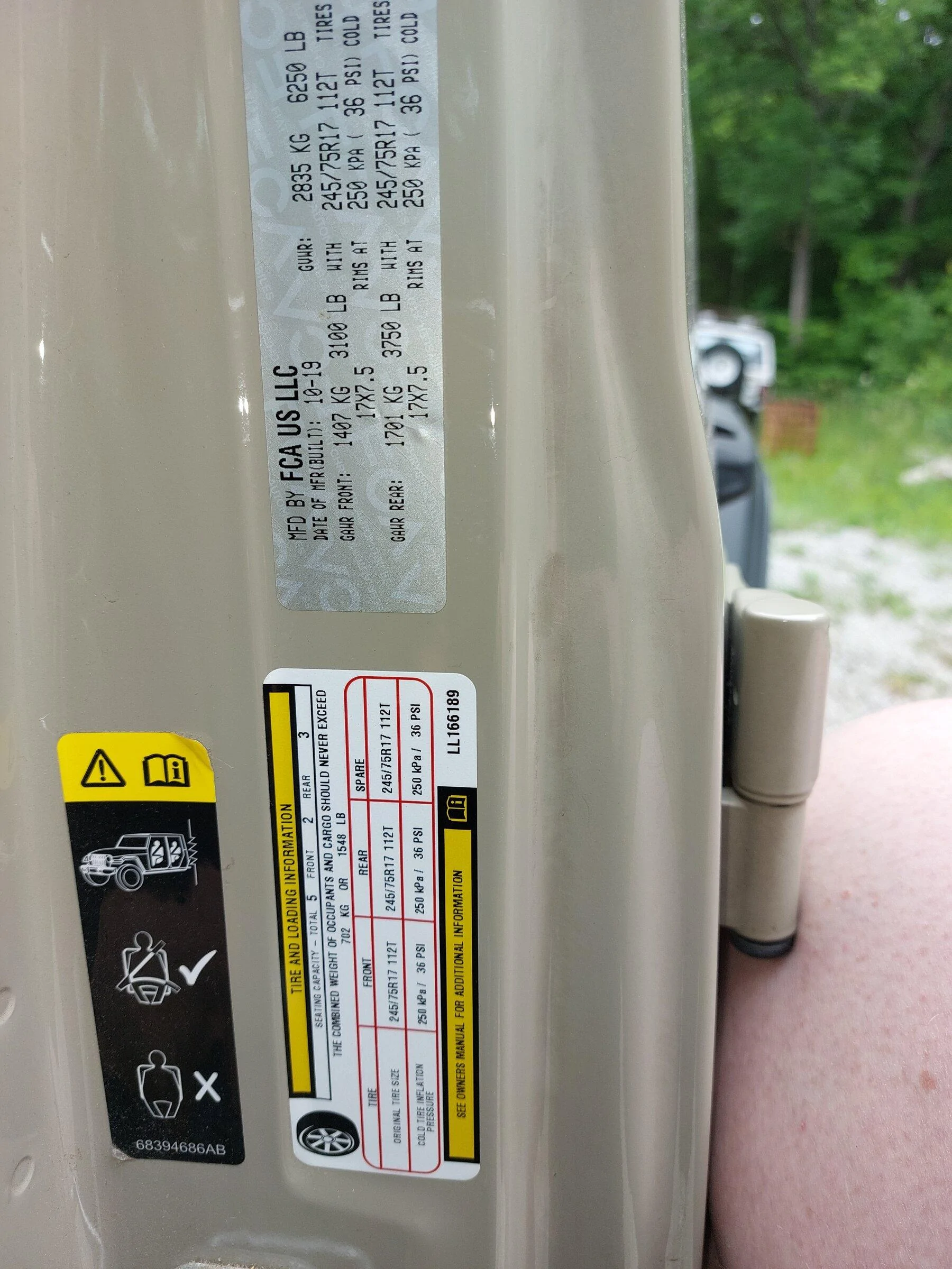

There is a chart on here somewhere that list the capacities of different trim packages. If your actual looking at one it's on the door jam stickers.
This is of my Max-Tow stickers. Tire and Loading one covers it 1548 lbs.
