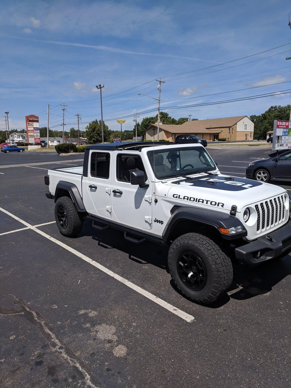

So far so good! Remarkably quiet up until about 70mph!
