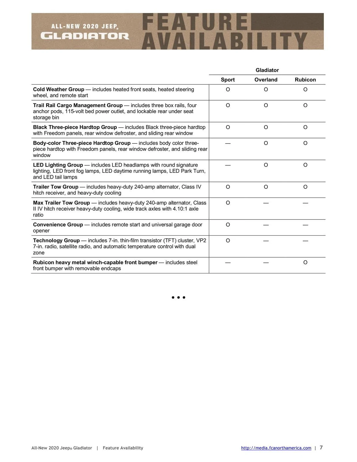

IF you are referring to the alternator for sale here for 100 - that's not the highest output. That's the one in the middle if I recall correctly. That's likely why it's still for sale.
Why do you keep saying there’s a difference between the tow package alternator and the Max Tow alternator? The max tow has the same 240 volt alternator as my Overland with tow package. Same cooling system too. I have the aux switches too, but it does change the alternator. It’s the tow package that gave my Jeep the 240 volt.
248
40,502
54,079
The one for sale is lower output than mine.
The one for sale is a 220 amp, mine is a 240. I believe the Sport has a lower output than 220 (non-tow equipped, that is)
I'll have to look at the charts I had saved last year.

Both tow packages get the 240 alternator you also get it with no tow package when you order the auxiliary switches, so if you get a tow package and the auxiliary switches you are paying twice for the same alternator.

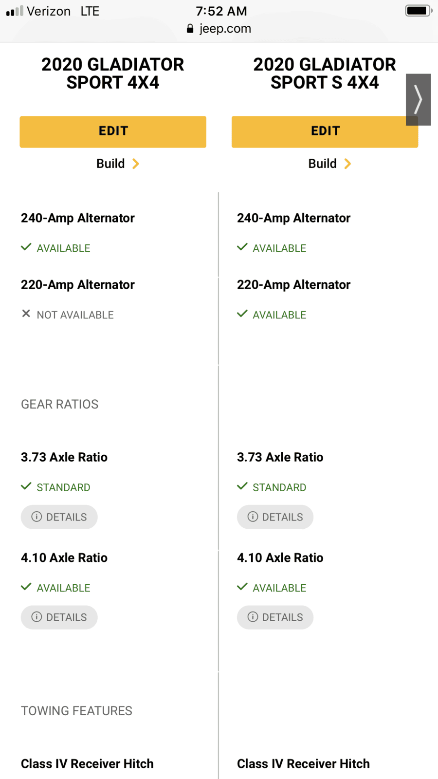

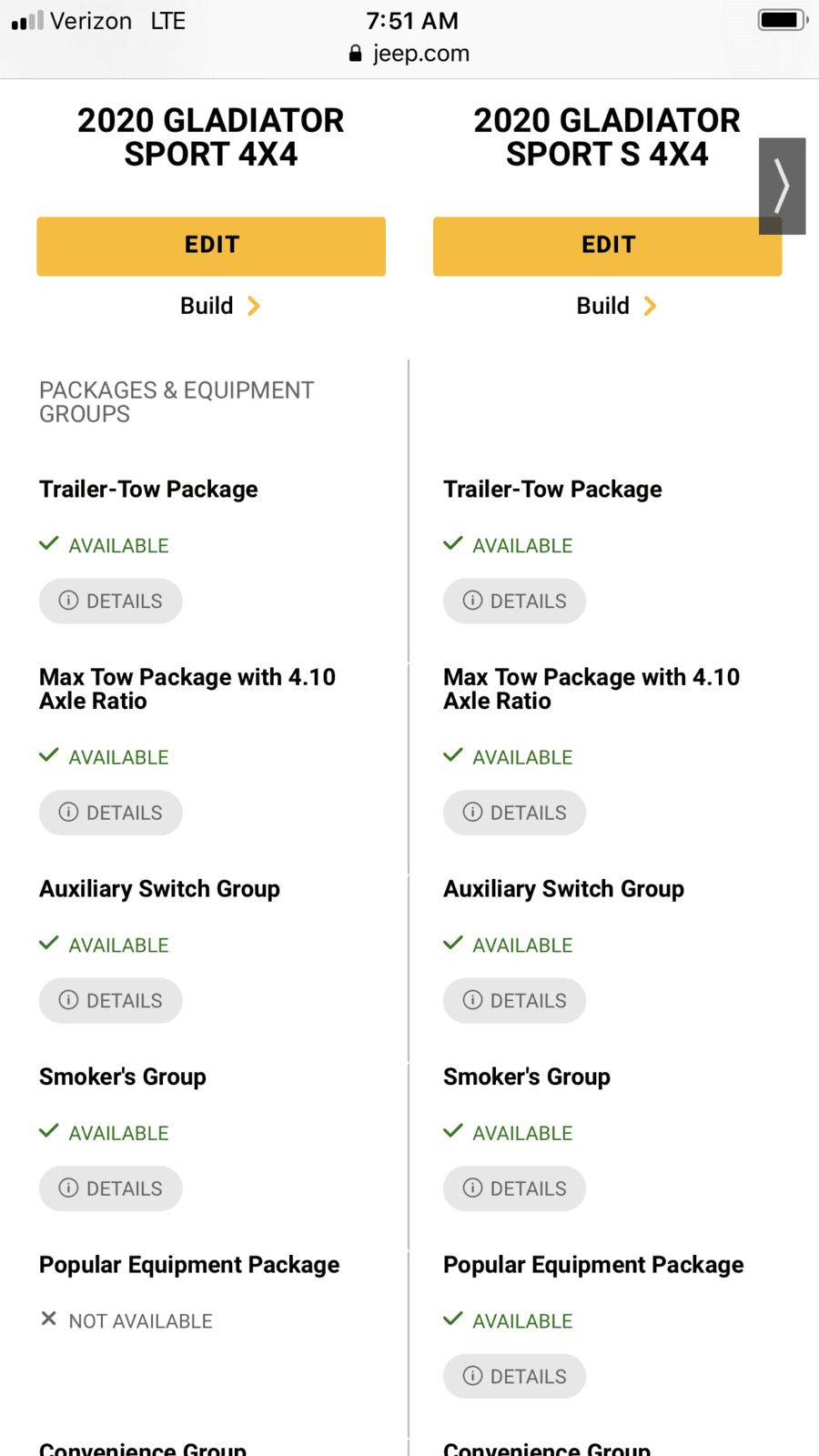

That's TOTALLY different than when I ordered. Back in October and November of 2019, "max tow" was ONLY available on Sport S - NOT Sport without the S. You couldn't get some of the other options, either. They've either made big changes, or, like I found out when ordering, the "build your own" was screwed up and WRONG.
The dealer showed me his screen and I showed him my printouts and the Jeep build site was way off on some stuff. Bluntly, it was wrong. We tried several things because I did it on the build site, but it could not be ordered that way.
In short, I don't always believe what the Jeep dot com build site says - if the dealer can order it, it's there, if the dealer can't order it, it's wrong.
And on towing - that's a huge change from just a year ago according to the screen shots above.
That screen shot also indicates that I was correct in that the Sport without tow package gets a smaller alternator than the 220 or 240. The dealer showed me the specs on that.

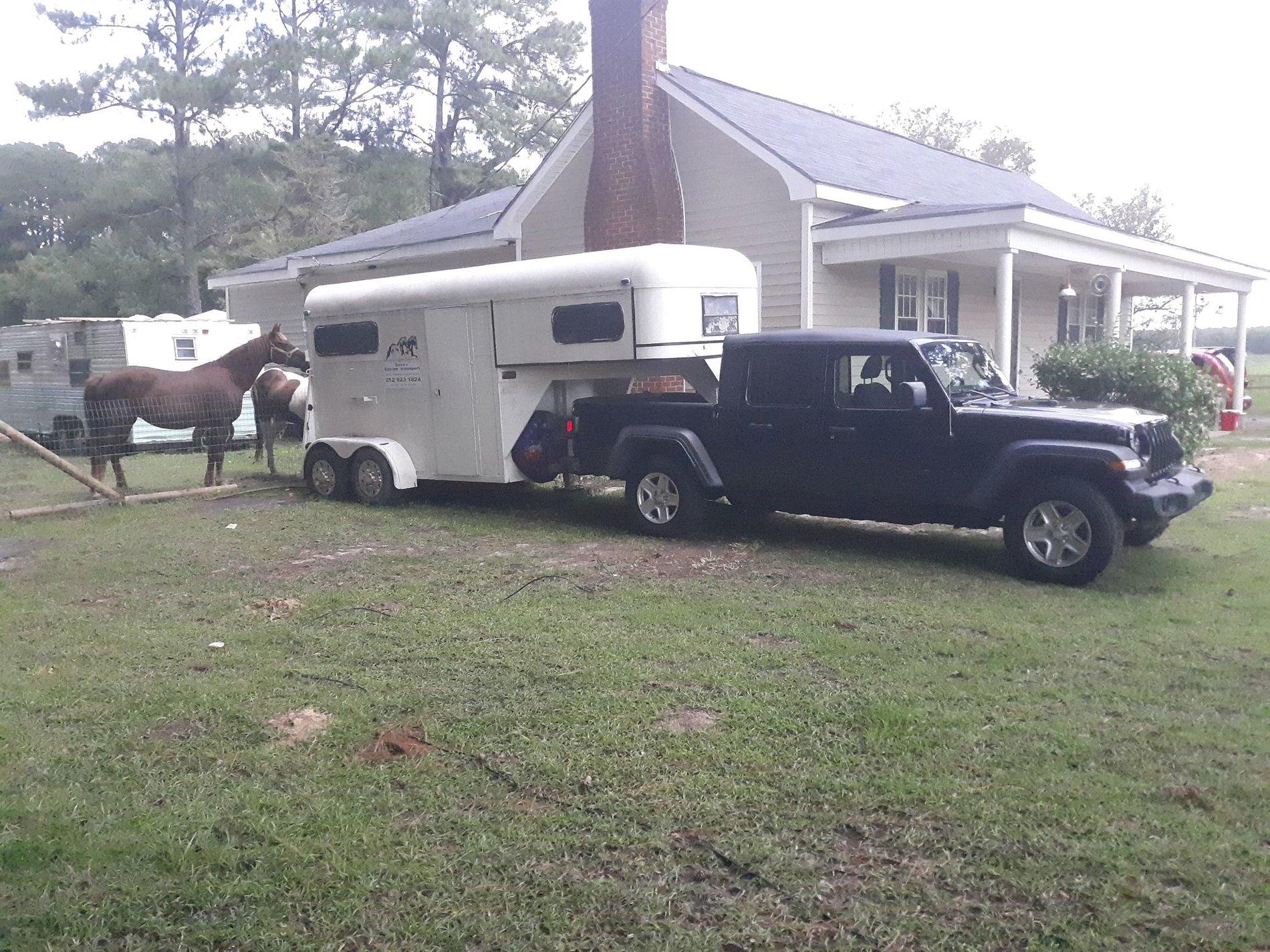

lots of differences jeep does not advertise the 5 wheel towing cap for the max tox package mine stated 8166lbs
Jeep Gladiator Tow package and Max tow package are NOT the same! horsetrailer
248
40,502
54,079
Your door sticker says 8166??
Door sticker numbers are god and law, not that web site that has everyone's numbers all screwed up.
You have checked the axle ratings, MGVW and all that?
What sort of PAYLOAD are you hauling with a trailer like that? It counts against payload numbers...
If something happens, that door sticker is what FCA, the law and insurance goes by. Dunno where that web site gets numbers like negative 1 and other crazy stuff from, but it's way out of whack in some cases. Don't trust that, trust your sticker, that's what the highway patrol will go by.

trailer weights 3400 with a 1200lbs tennesse walker and a 900lbs american paint waiting on trip to pea island NC . max tougue weight on the fifth is in the photo . If i get stuck my 2 wranglers have no problem towing me out.
