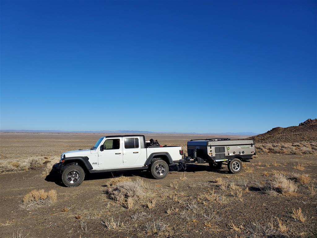

The Gladiator does not have a driver selectable tow/haul mode. Jeep says, the truck automatically adjusts the transmission mapping when it detects additional towing load.
This is my experience. First with my travel trailer and now with this camper the transmission does a darn good job of keeping the engine in it's happy place without interference from me. I just put it in D and go.
