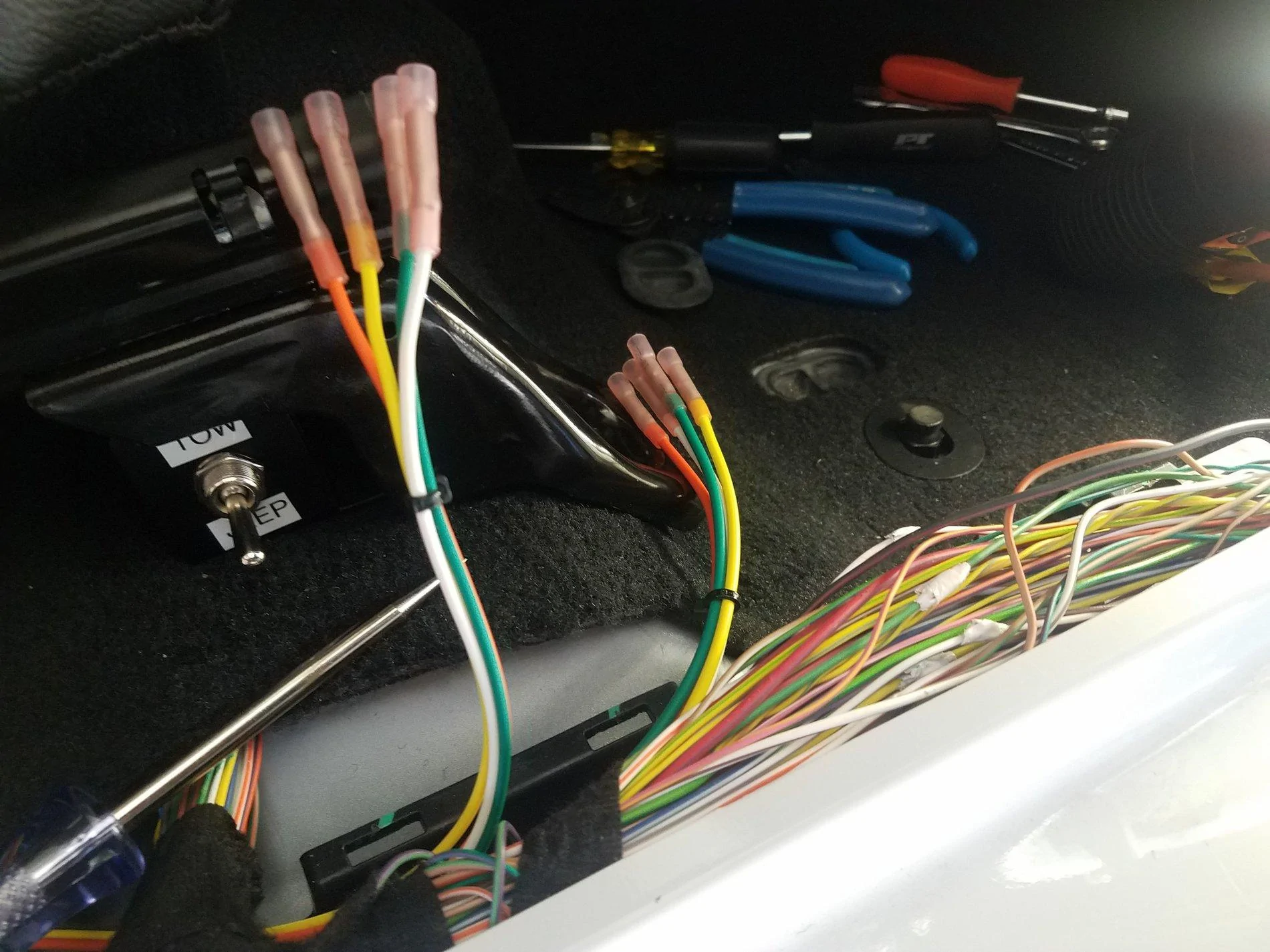

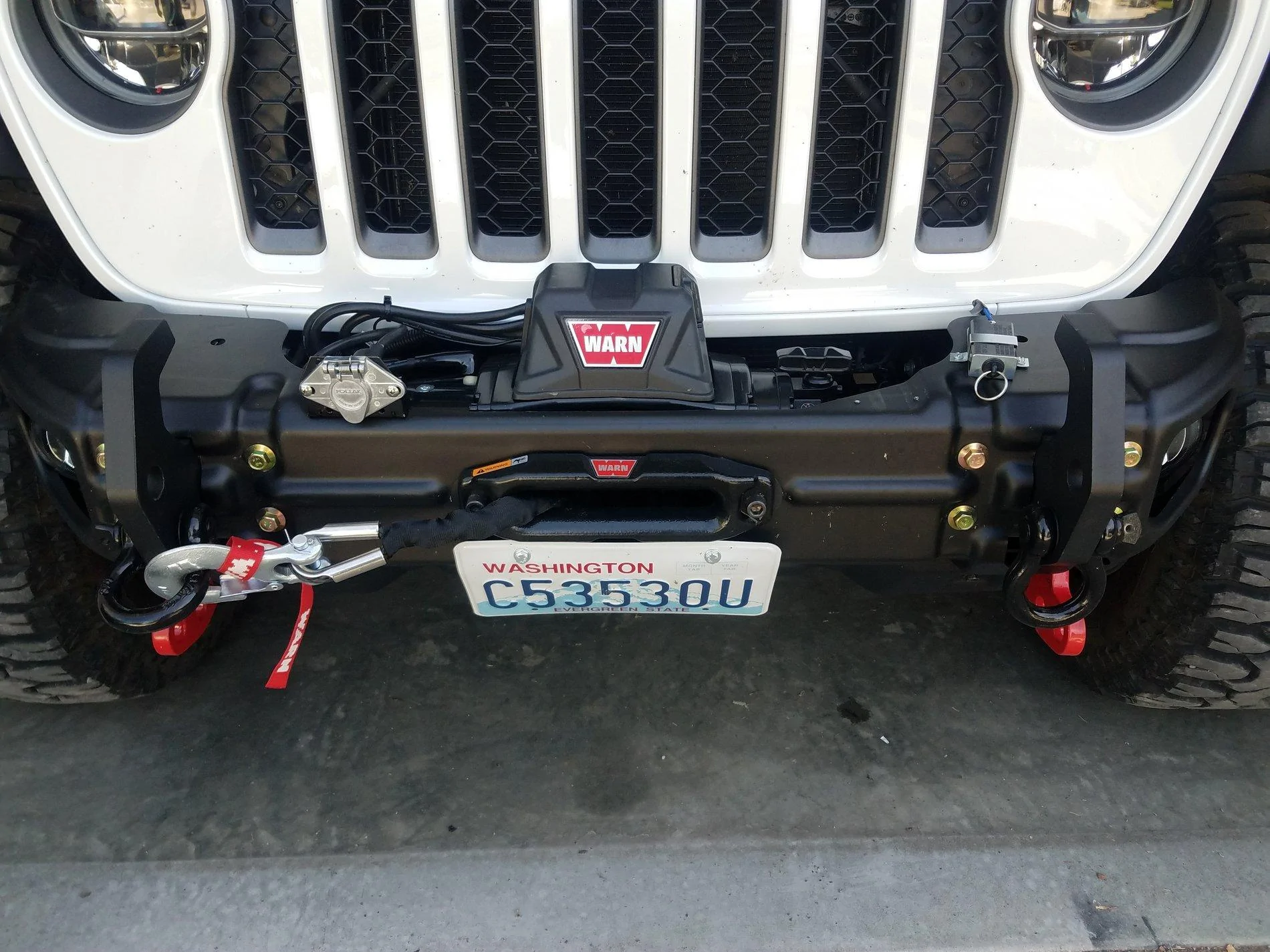

Cooltech kit installed. What a great complete kit. I like the switch that separates RV input from Jeep input to the taillights. I was nervous about cutting wires. Once I cut the first one, the next three were easy! The instructions are very clear and easy to follow. Someone made a video of their install too, which I watched. Everything works great. I had to mount the plug and breakaway on top of the bumper to avoid certain death.

Man, I just finished installing under passenger seat dual ARB and ran wire through that grommet already...thought of taking seat off again to access it kinda giving me a nightmare haha..but it looks like there is plenty of room next to compressor chuck to attach the jeep/RV switch on the front outer seat bolt under the seat frame. truth is I should prob do a better job mounting wiring for my compressor that runs to the front anyhow. Otherwise I would have to go through passenger firewall opening and that's a nightmare.
Plenty of room! The switch tucks in there nicely. I didn't remove the seat, just that front bolt. The switch mount slides under it.
yeah, looks like tons of room but ..not worried about pulling the one seat bolt for the switch bracket...prob is I have to take the seat off because the compressor air line blocks access to the grommet, and I can't just pull out the grommet bc the compressor wire runs through it already. I have to cut a second hole in the either the oem grommet for the cooltech wire or cut the cooltech grommet for the arb wires. oh well, I do it right bc I do it twice...or 3 times...lol...maybe I'll go throught firewall instead.
