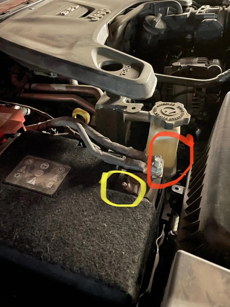

Removing from the top post of the main battery will disconnect the main, and the aux ground is routed through the IBS that sits on top of it. You can disconnect the aux from there as well.

Since no one seems to want to answer the OP’s simple question.
Jeep Gladiator Wiring for Flat Towing IMG_4106
first use a 13mm to remove the nut circled in red, cover/isolate the cable end so it doesn’t ground on anything. Second use a 10mm and remove the terminal circled in yellow cover/isolate it as well. Reattach in the reverse order to reconnect.
Very important! Do not let them touch anything in the engine bay, if they do you stand a real good chance of blowing a fuse in the Z Case fuse/ high amp fuse array.

The OP was pretty clear he had made up his mind on how he was going to flat tow so I didn’t address that. Just gave him the answer he was looking for.
Gregj
eta flat towing isn’t the only reason to disconnect both batteries.
