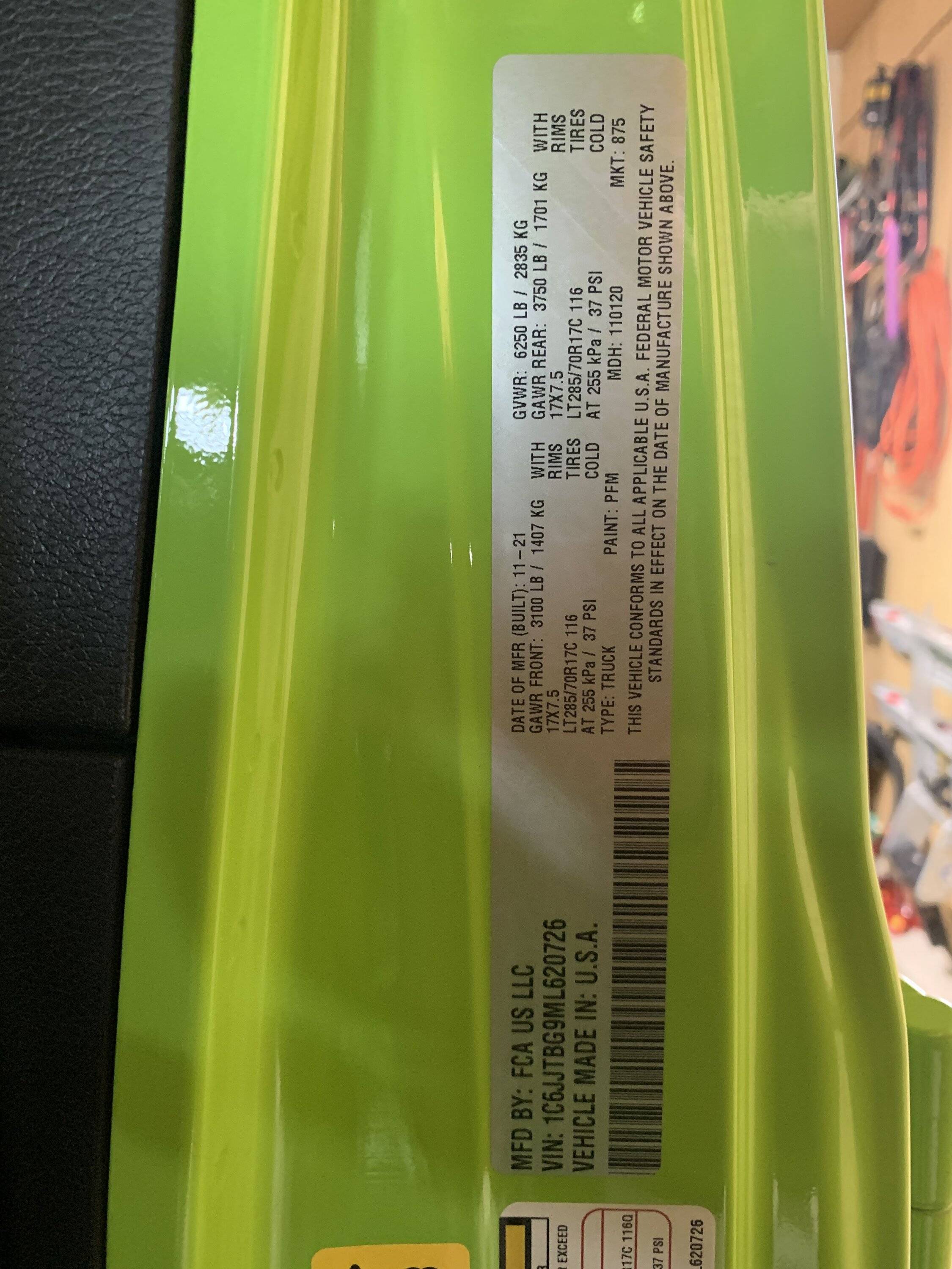

I have a 2021 Rubicon that I bought new sensors for new wheels and thought I bought the correct ones (68510382AA) Just installed them and drove around a while with no luck. I mistakenly used the MDH date (110120) thinking the 20 was the year. Now I see the Date Of MFR is 11-21 so I probably have the wrong sensors installed. Certainly my mistake but I have 2 questions: If my Gladiator is a 2021, how can the Date Of MFR be in November 2021? Wouldn't they have been building 2022s by then?
My 2020 was built in November 2019

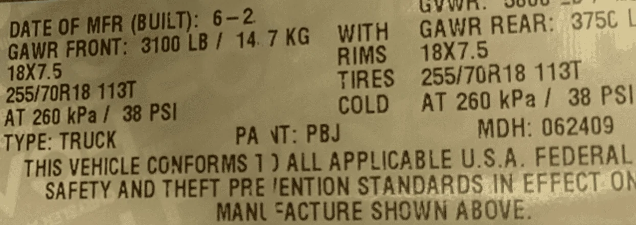

My 2022 decal is below - look at the 6-2 meaning June 2022 and I'm assuming that's what you refer to as built date of 11-21
So if yours says 11-21 it was built in 11-21 (November 2021) not sure when the 2022 model year started production - sometimes they delay things, sometimes they start sooner.

Thanks much for the reply. I forgot to attach the sticker on my post.

The date of manufacture is the month and year production was finished for the vehicle. MDH is the month, day, and hour production was started. They were probably finishing up a backlog of orders, so 11/01 is not all that late for a '21 model.
