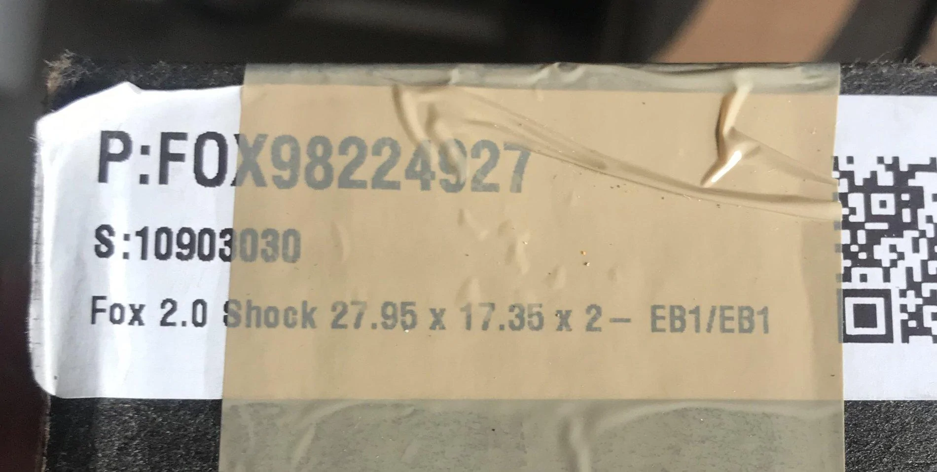

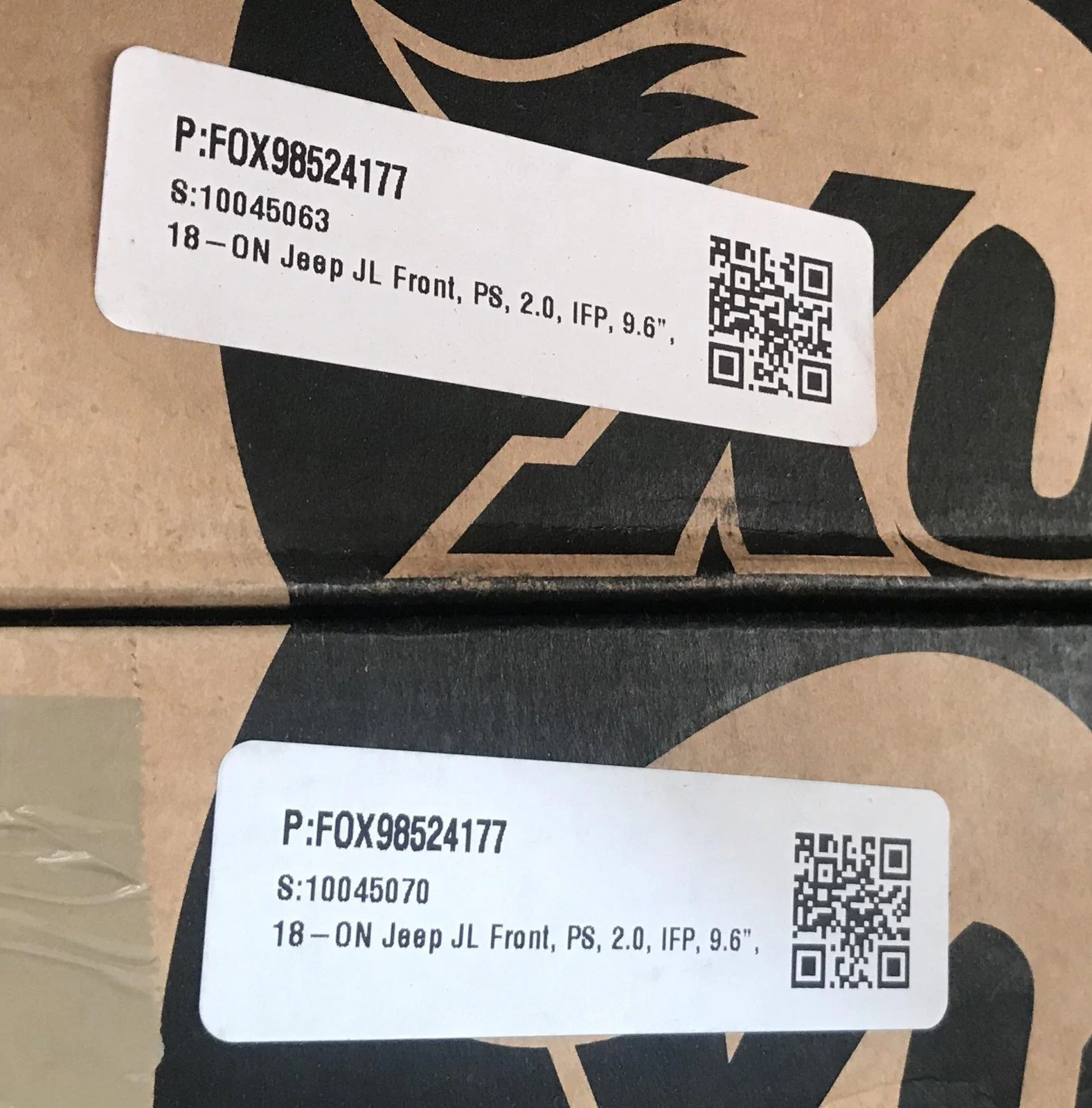

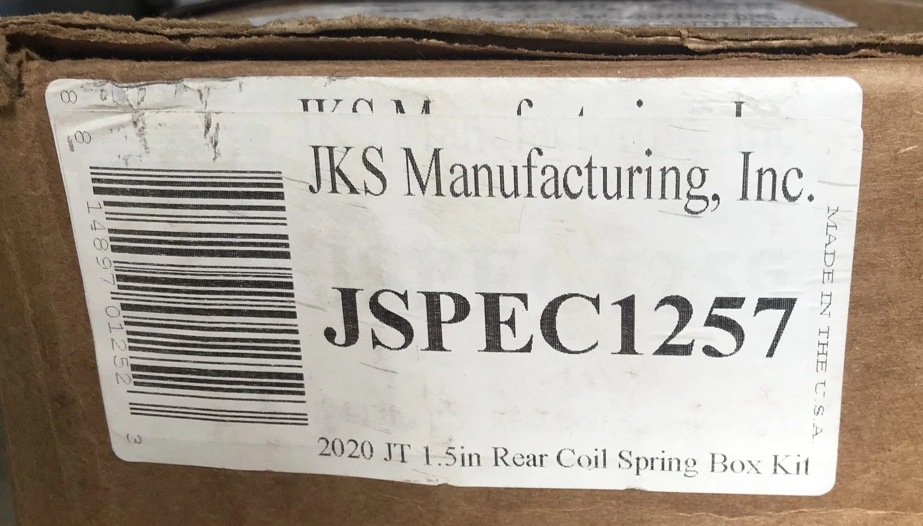

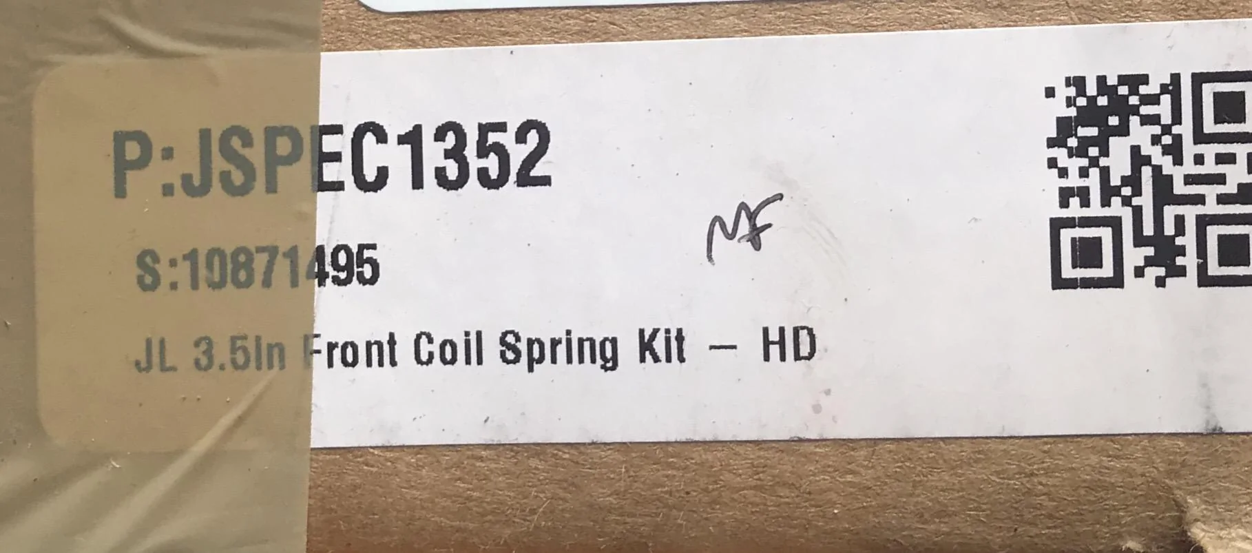

as i drove back from the east coast with my new JT i stopped in DFW and picked up the following from a forum member who had posted a few giveaway parts :
- Rubicon Fox 2.0 Shocks (front & rear)
- 1.5 inch Rear Coil Spring Box Kit
- 3.5 inch Front Coil Spring Box Kit
pictures and part numbers below. the gentleman who was giving these away had owned an Overland JT and had these parts from a compadre who had upgraded his Rubicon's suspension. the Overland owner eventually sold his JT and the Rubicon suspension parts were never utilized for anything. and now i can put them to use on my Max Tow, right ?
as i look at the box labels i can see both JT and JL descriptors and, fishing around the MOPAR websites, i've tried to verify that even the parts labeled JL will also work on my JT. but i haven't cracked the code for the part numbers and any help with verifying all of this would sure help?
i'm hoping to put 35" tires on fairly soon and there's a good chance i may get to use a Readylift 2.5" SST kit also to provide some extra room.
maybe a Fox Steering Stabiizer, a Tazer Mini and possibly a different bumper/bumpers.
but to get started, will all of these components work together on my JT and is there anything i'm missing?

If what is supposed to be In those boxes is what you actually have, those are the shocks and springs from the JKS 3-3.5” lift. That’s a nice score. If they are just Rubicon take-offs from someone who boxed up his old stuff, you might see a 1” lift in the front.
