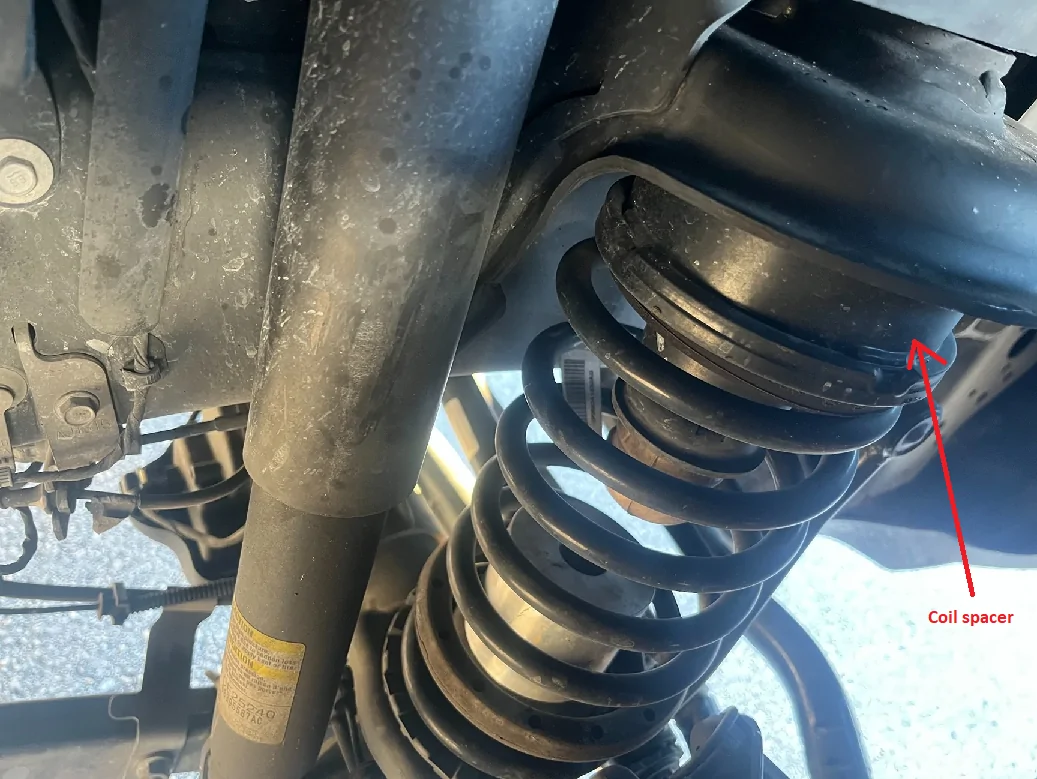

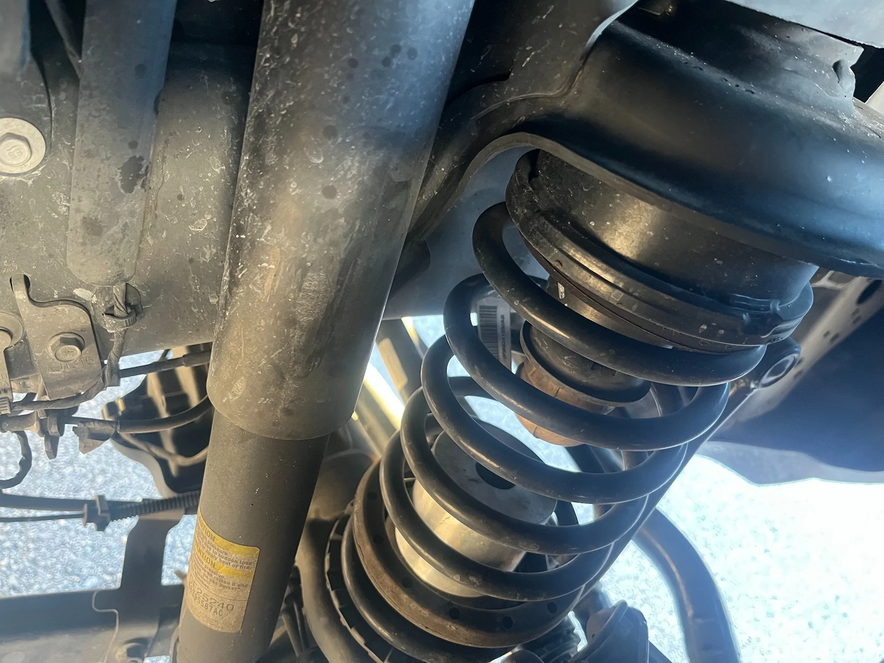

I bought the gladiator from a dealer with the lift already installed. They took it on trade and couldn't tell me much about it. Can anyone ID what lift is installed (size and make)?
The front is not quite level with the rear, assuming its a 2" maybe. It clears 35s with minor trimming to the front plastic guards.

It's a coil spacer lift.
Measure the thickness of the spacers to get the lift height.
Not sure on brand. It doesn't really matter when it comes to coil spacers. They're all pretty much the same.
