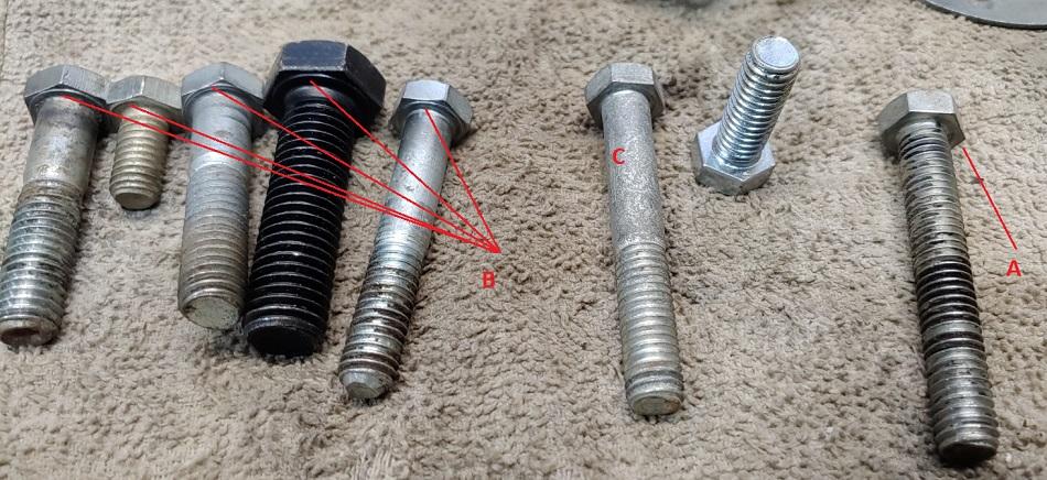

For other folks looking on - lurkers, learners, etc. - the pics below shows some examples of machine screws, cap screws and tap screws.
They are called a screw if they thread into a hole that is threaded, such as in an engine head, etc.
If there is a nut used, the same fastener is referred to as a bolt.
A is a tap screw - threaded all the way. These allow a wider range of use where the items being fastened may vary in thickness - and you don't want to risk bottoming on the unthreaded portion of the screw/bolt. They are often used for clamping items where the thickness doesn't match standard cap screw or machine screw threaded areas. (there are standards for the length of the threads and unthreaded areas)
C is a machine screw - note the hex head it hex top to bottom. If it was screwed up against something flat, the hex corners would contact that something.
B are cap screws - note the sort of washer shape made under the head. These are more precise because when you torque them, the hex corners can't contact or dig in and it's a known surface area contacting the item being clamped.
Most sold in hardware stores are "cap screws" - but not always.

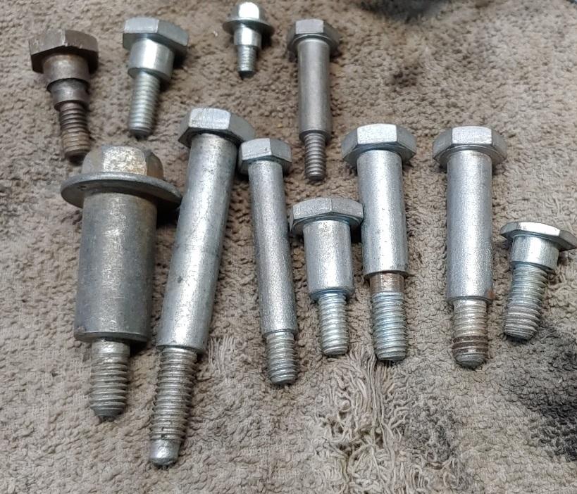

The second pic shows shoulder bolts..... the large shoulder "ledge" is what makes contact, leaving the shoulder itself for something to turn, spin or pivot on. Common use - lawnmower wheels, or bolts holding levers in place, that sort of thing.
Shoulder bolts will have a distinct shoulder with an edge - the shoulder will be larger than the threaded portion of the bolt. For example, a 3/8" thread but a 1/2" shoulder that could be from fractions of an inch to over an inch long at the shoulder.
Examples - the threaded portion is 1/4" and the shoulder is 5/16" or even 3/8" diameter. The shoulder will be larger than the threaded portion.
Because of their typical or types of uses, shoulder bolts will normally not be hardened - most will be grade 5 (3 marks) or grade 2 (no marks on the head).
(taken from hardware store experience - and Machinery's Handbook)

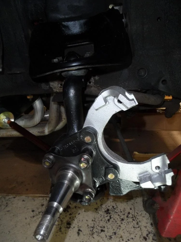

I bought many of the grade 8 bolts I used from Theisen's. They are a Farm/Ranch/Home retailer.
I buy others at Lowe's and a big hardware store in East Des Moines. Automotive stores seldom carry bolts in any sort of selection other than some basic sizes. Bolts just aren't their thing.
The bolts holding the spindle to the steering knuckle and the brake caliper bracket here came from Theisens. And the car gets raced. (I did a disk brake conversion on it a couple of years back)
This is mock-up, yes, I spun the bolts around so the heads were outboard instead of the nuts at the spindle - gave better rotor clearance. Also used grade 8 flanged nuts from Theisens. They are akin to Fleet Farm, etc.
