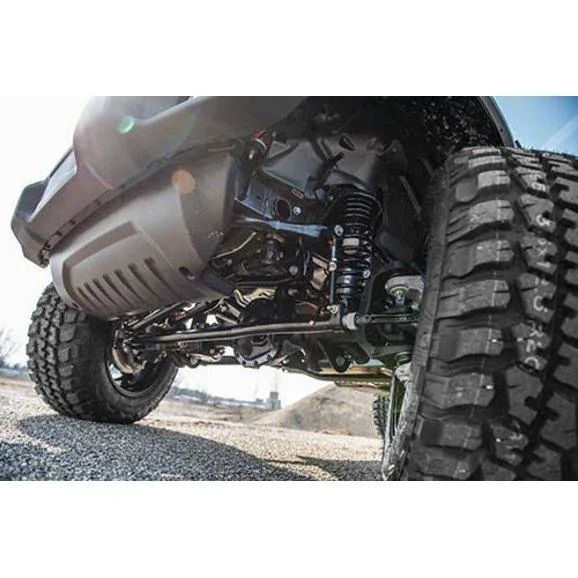

Upgrade from the weak factory track bar to the JKS Front HD Adjustable Track Bar in your Jeep Wrangler JL or Gladiator JT. Fully adjustable to be compatible with both the stock suspension and lift kits up to 4.5 inches high. This stout track bar is made from 1.5" OD thick wall DOM tubing and engineered for performance. Designed to correct lateral movement of the front axle and recenter the axle under the Jeep. Includes premium durometer rubber bushings while finished with a zinc plated end and durable gloss black powder coat. Backing it up with a limited Lifetime Warranty.
