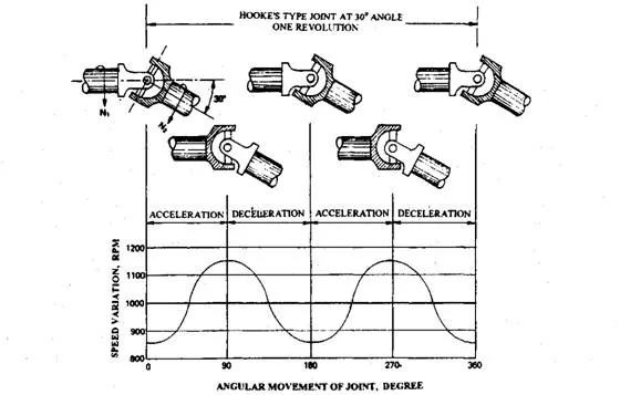

Again, the U-Joint will give a cyclical kickback as angular velocity increases and decreases through the rotation across the union.
That is in addition to the binding of the whole drivetrain as wheel velocity differences get evened out with the tires skidding on a surface with traction. CV = constant velocity, and Birfields have the same characteristic.
EGGZACTLY.
And your "cross" type is almost like looking at an AC (alternating current) sine wave as far as the velocity. This is where you get vibrations in a short driveshaft where the angles don't nearly cancel each other out.
I can be off more with my Javelin driveshaft than someone with a Jeep can as longer shafts are more forgiving.

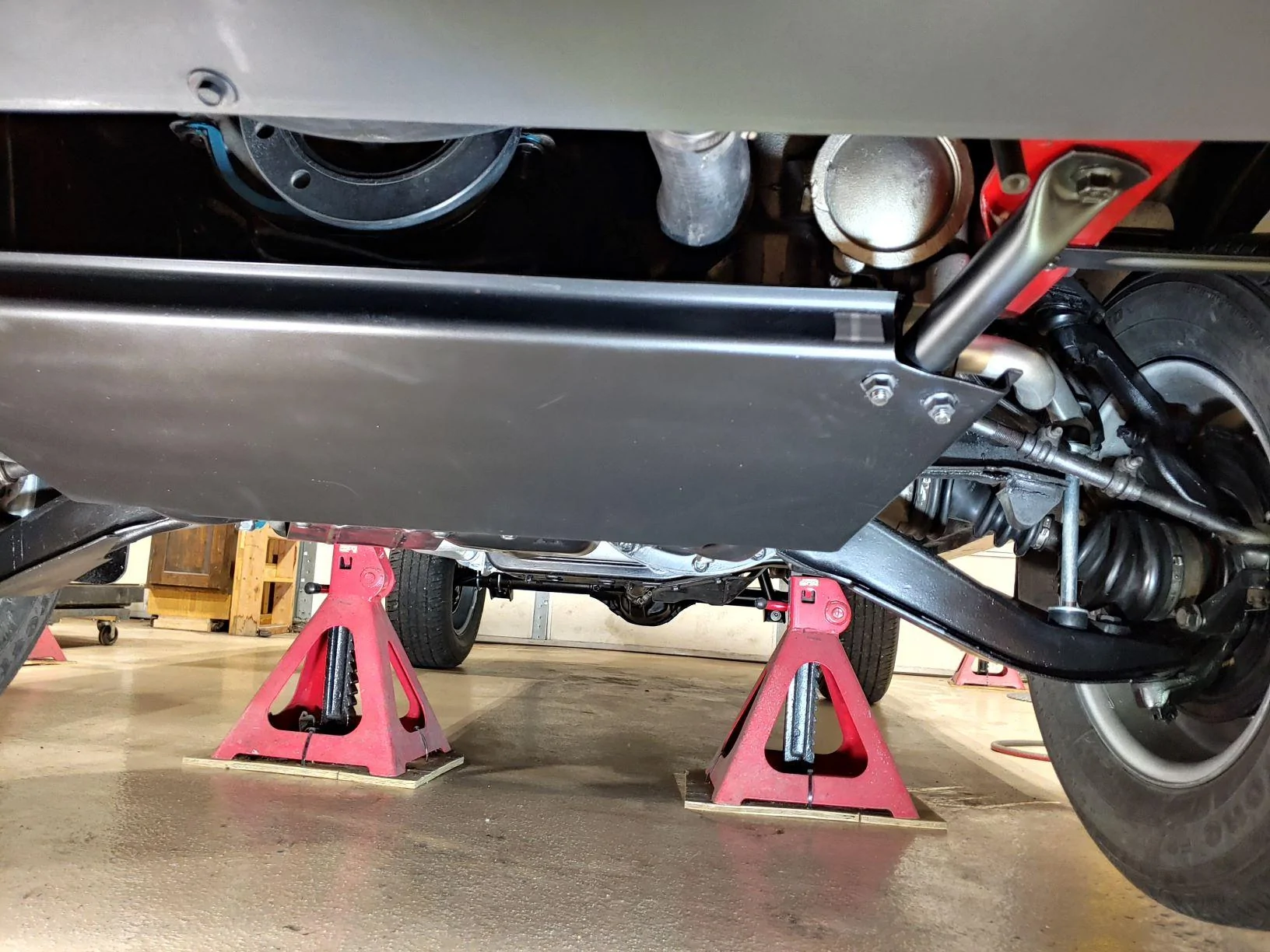

Jeep Gladiator Turning wheel all the way while in 4WD sx4-front-end
Single cross-type u-joint acceleration/deceleration pattern, why things can get jumpy (even in 2 wheel drive) ->
Jeep Gladiator Turning wheel all the way while in 4WD ujoint-image0023
