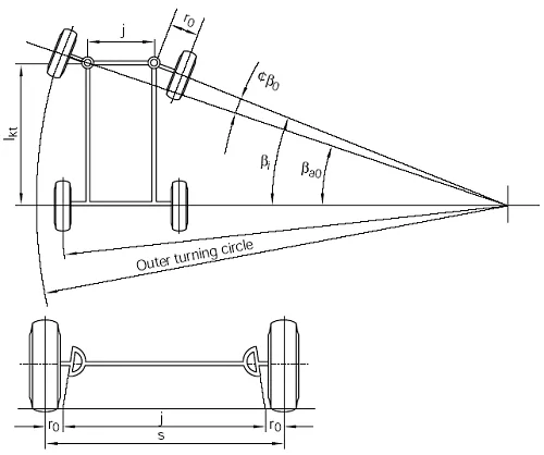

4WD locks your differentials together that the pinion (input) gear spins at the same rate front and rear all the time. If you watch the above video, you'll see that on any given axle, the faster of the two wheels always spins with the pinion gear (and therefore the rest of the upstream powertrain) at the rate determined by the gearing.
So when you lock 4WD, that means there are one front tire and one rear tire that must spin at the same rate. Since your rear tires track straight and your front are able to turn, the rate of rotation is different between all 4 wheels through a turn. The sharper you turn, the larger the difference between wheel speed is.
But since one front and one rear have to spin together, there is conflict because when both have grip, they both want to spin at different rates. So, you get binding and hop as the one with less friction breaks free to match the one with more friction.
In 2wd, the front differential isn't engaged and will freewheel so there's only one rear tire that needs to spin at the same rate as the powertrain.

This Jeep part time 4WD system locks one rear and one front wheel to the same speed. In a turn, those wheel speeds must differ so something has to slip. Donāt underestimate the road surface traction. If you are able to drive, that same level of traction that allows to get moving and stop will resist different wheel speeds in a turn.
