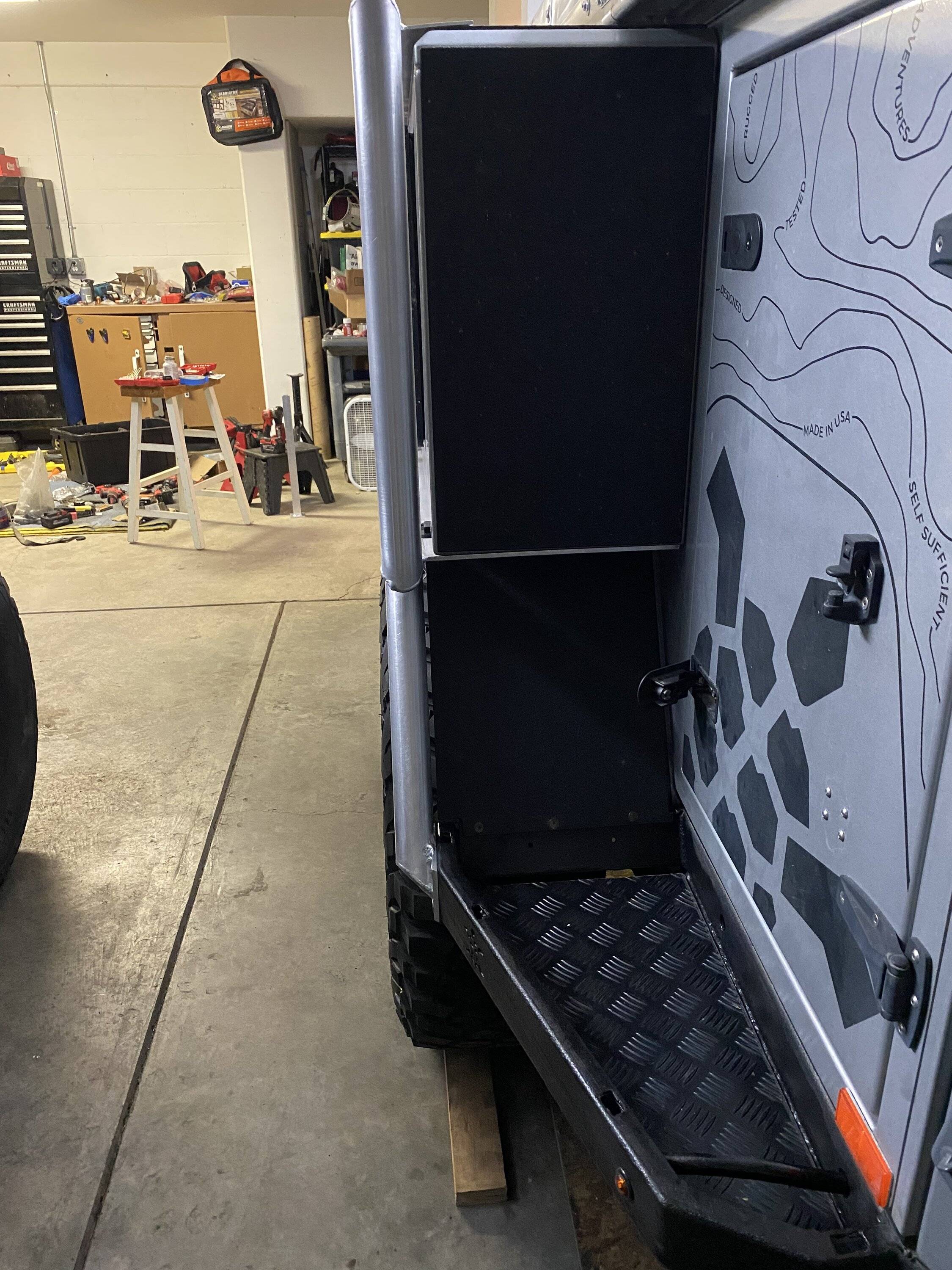

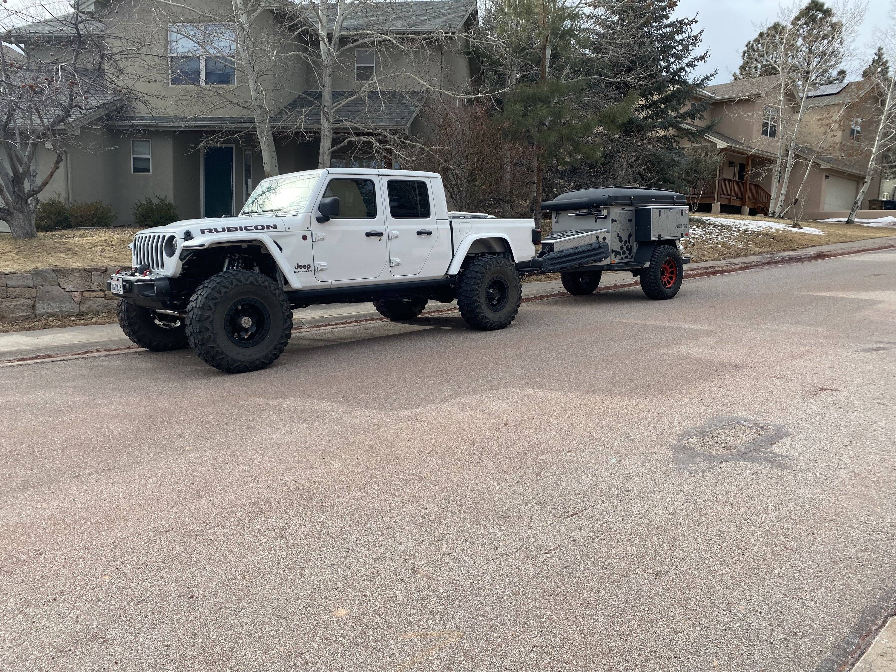

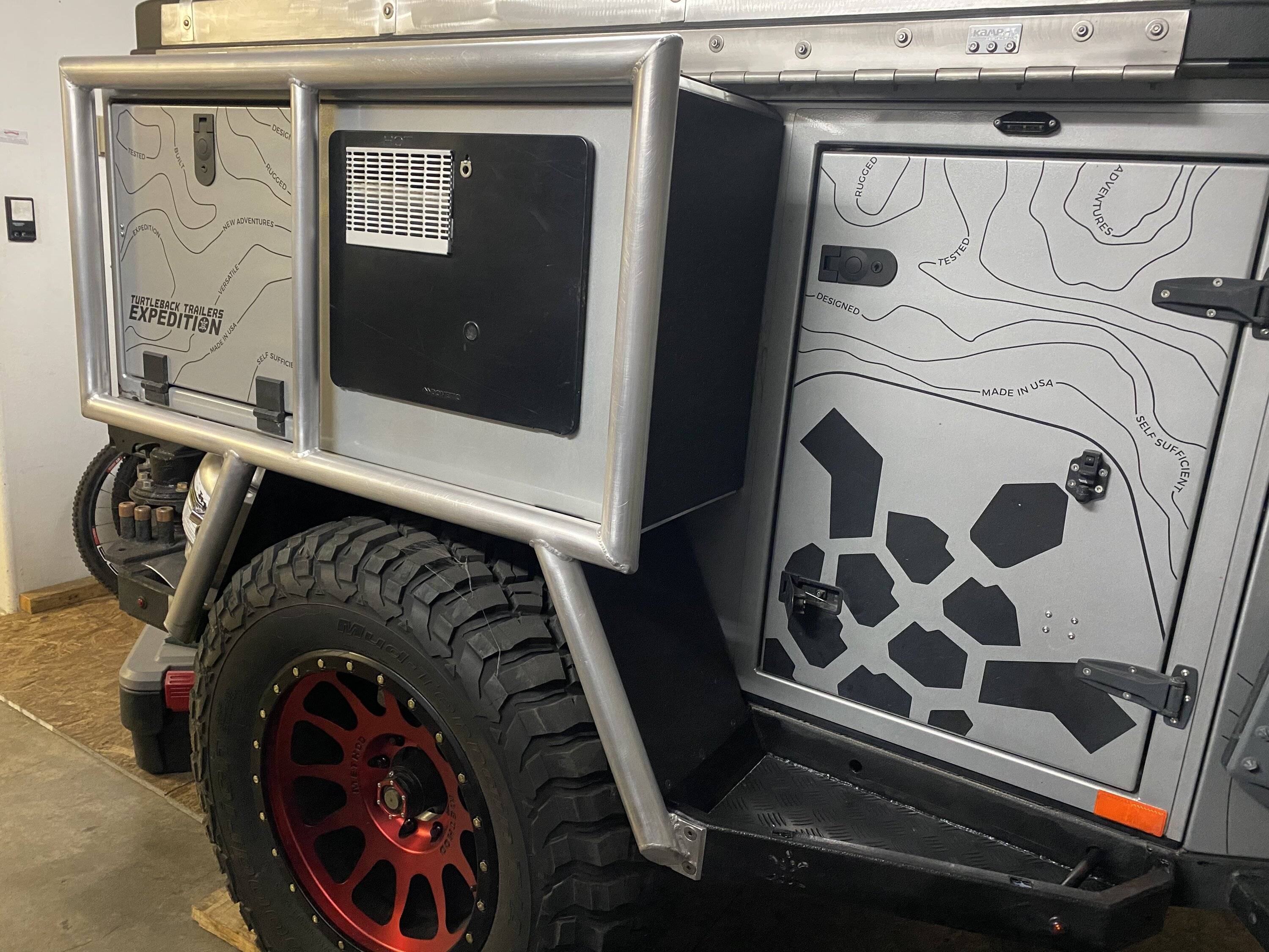

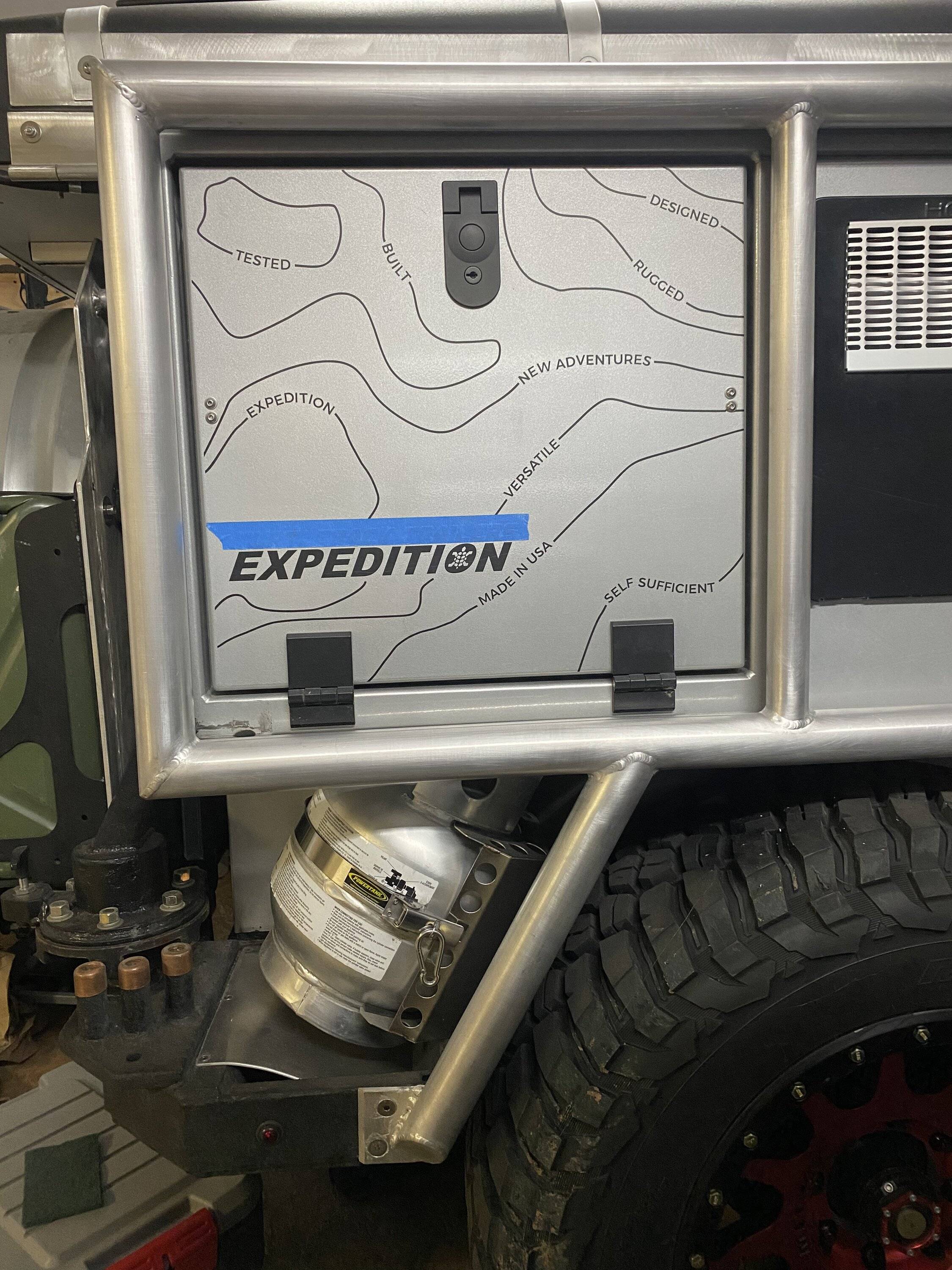

Done a few updates to the trailer.
8x6.5 oil bath hubs
37ā€ tires with 20ā€ wheels.
Lowered the front step plate from top to bottom with 1/4 steel plate reinforcement.
Started the TurtleShell. 2ā€ Aluminum tube fenders and box protection.
Jeep Gladiator TurtleBack trailer purchase experience 00F626F2-9145-4B57-A353-0F30E7BDF754
Jeep Gladiator TurtleBack trailer purchase experience 9D373F44-B8C7-4415-A32D-E08EE62AF6D5
Jeep Gladiator TurtleBack trailer purchase experience E578BDD3-35F1-44AA-ABD9-D8284D65659D
Jeep Gladiator TurtleBack trailer purchase experience 72809C3A-2705-4FAB-A1E0-431A643D9084

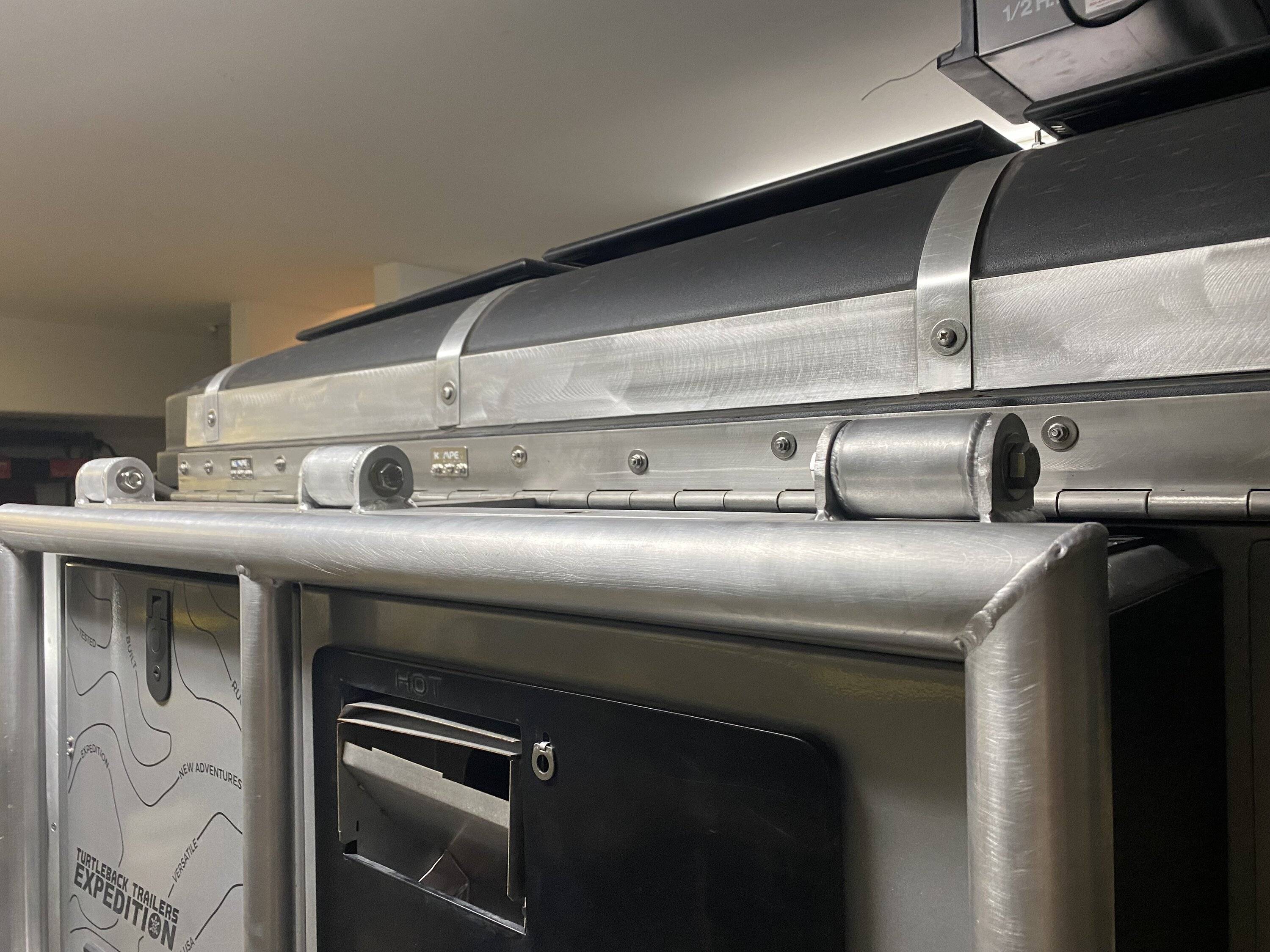

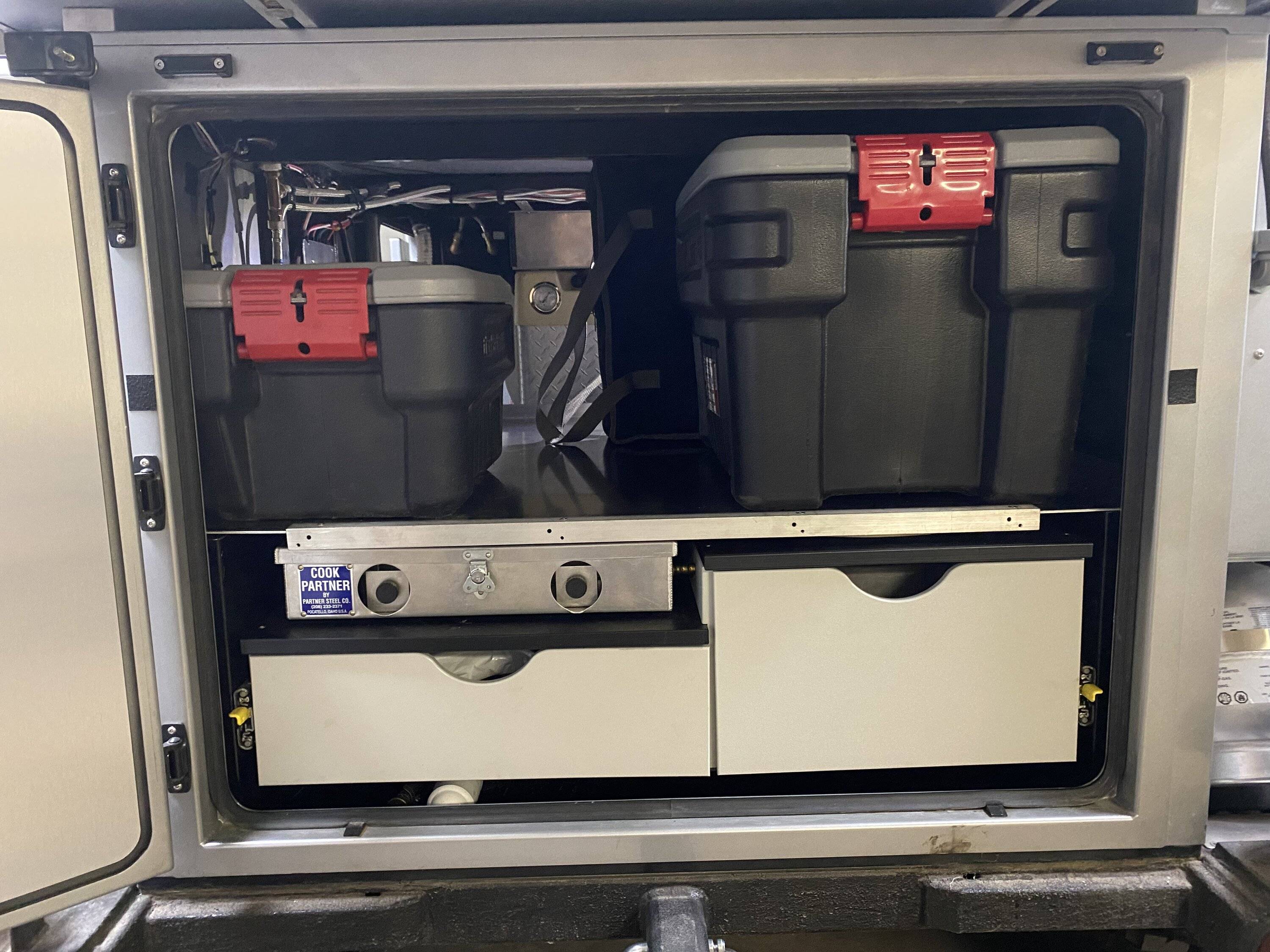

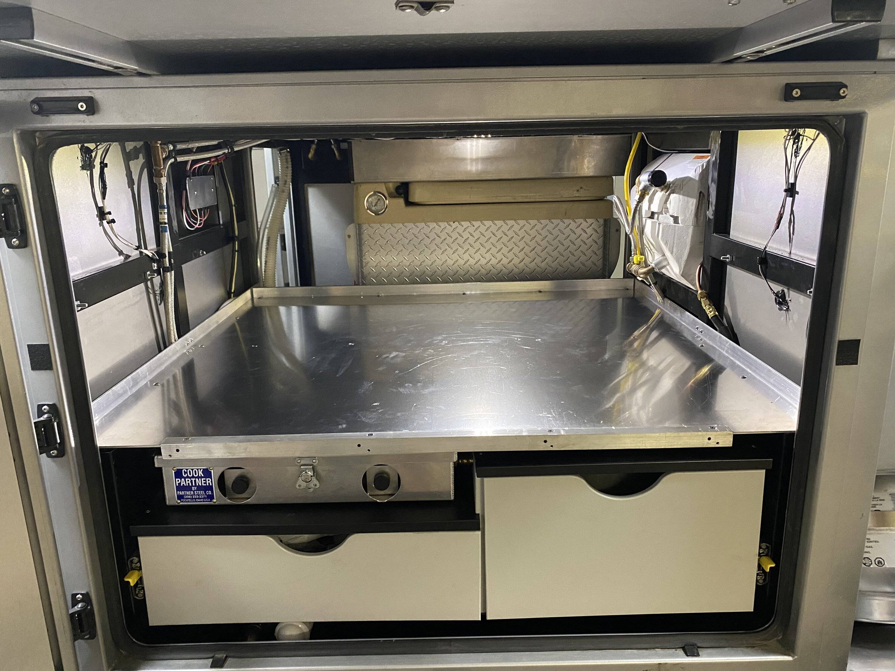

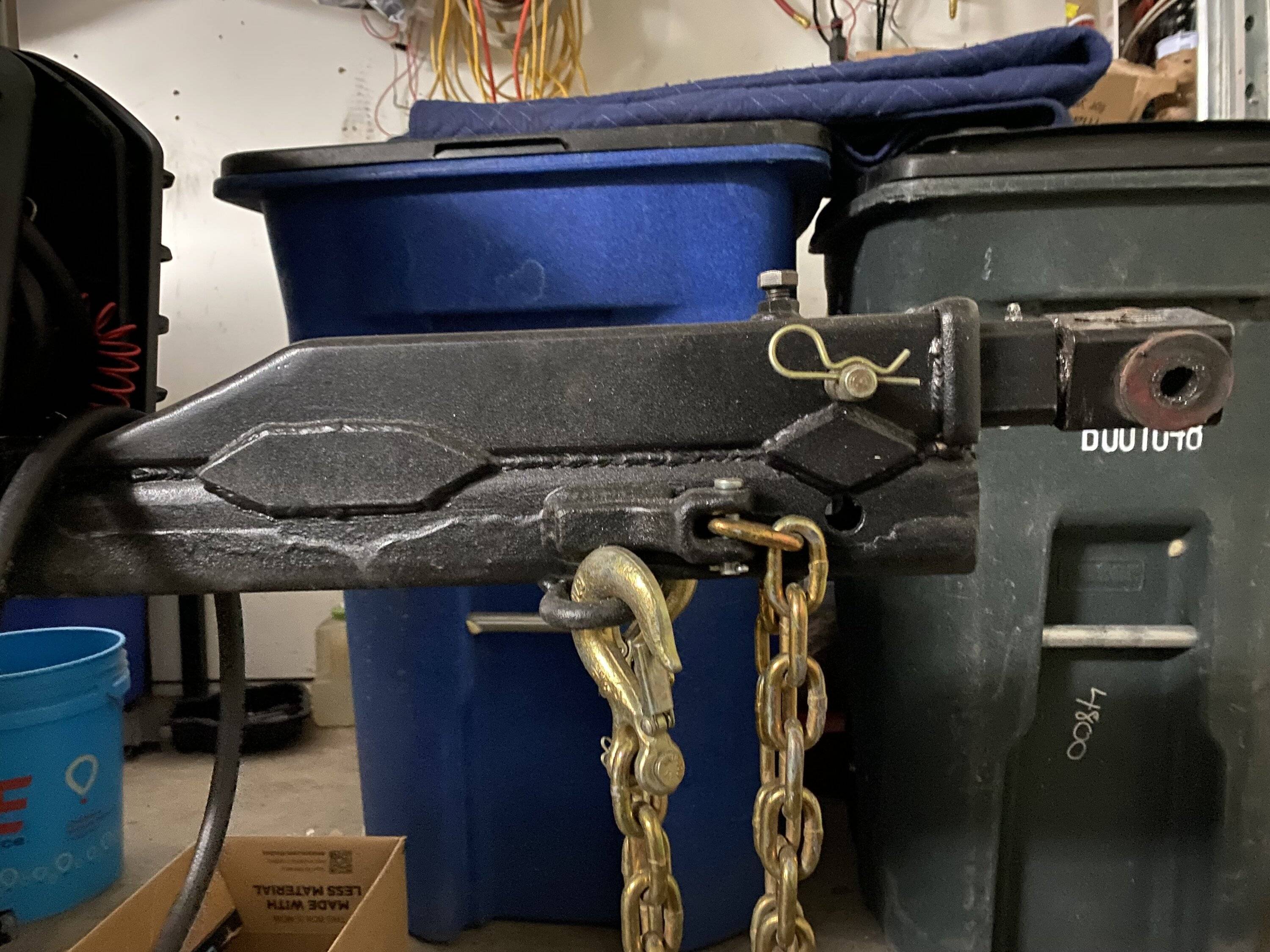

More updates.
Flipped the water tank 90* and removed the two upper drawers to create one larger flat surface. This was an idea when the water tank was first built.

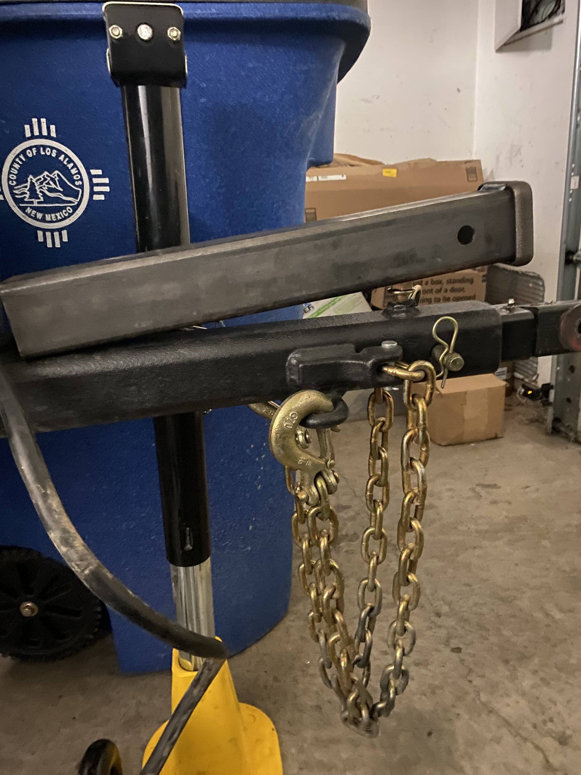

Added a hitch sleeve for better towing with 40ā€™s on the tow vehicle.
Modified the trailer jacks for better positioning with mounting for transport.
Added cage hinges for future over the tent roll cage.
