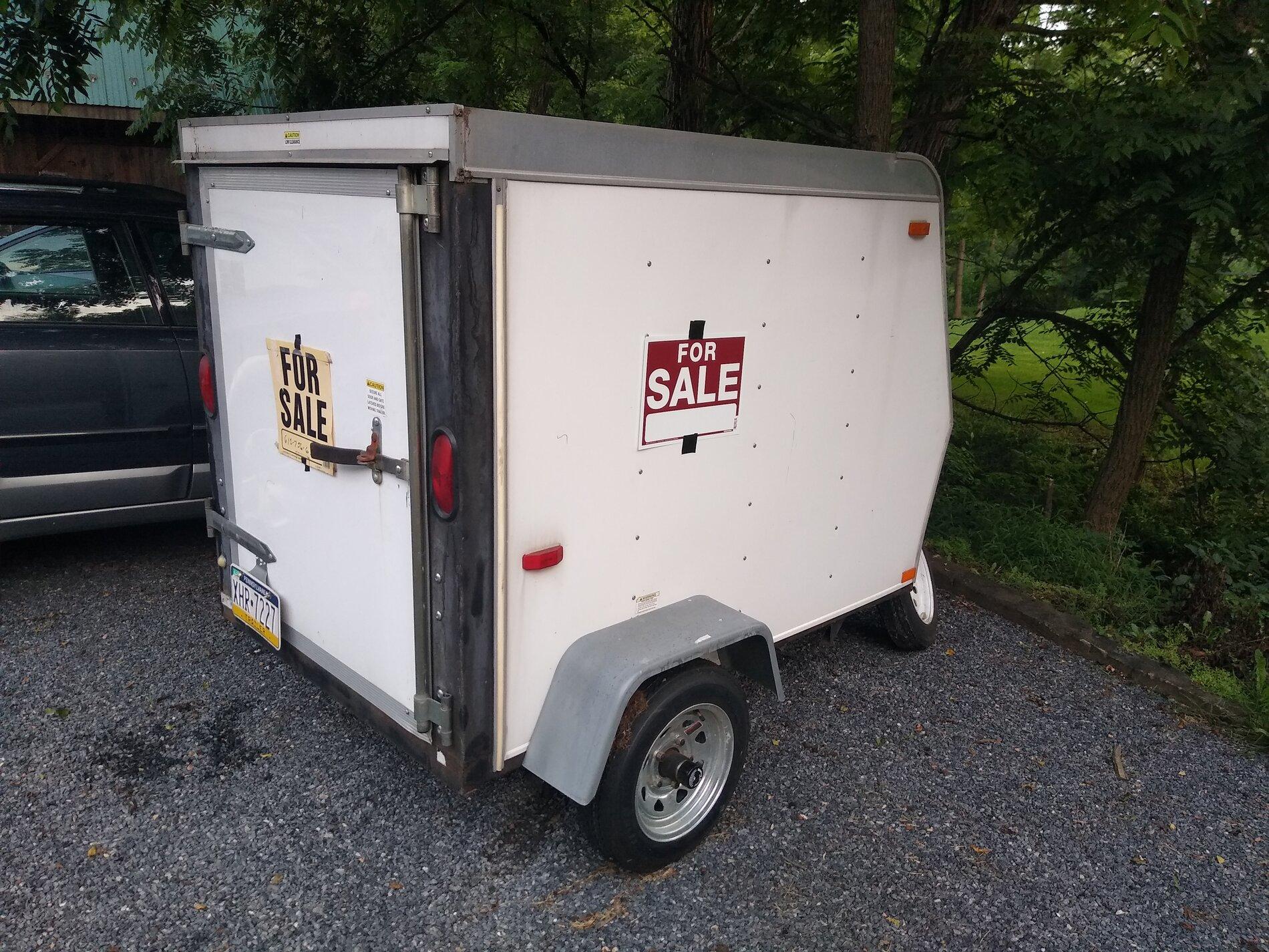

So I'm in the process of selling that one and picked up my next project. A small 4x6 enclosed trailer that I think, will fit our needs even better.

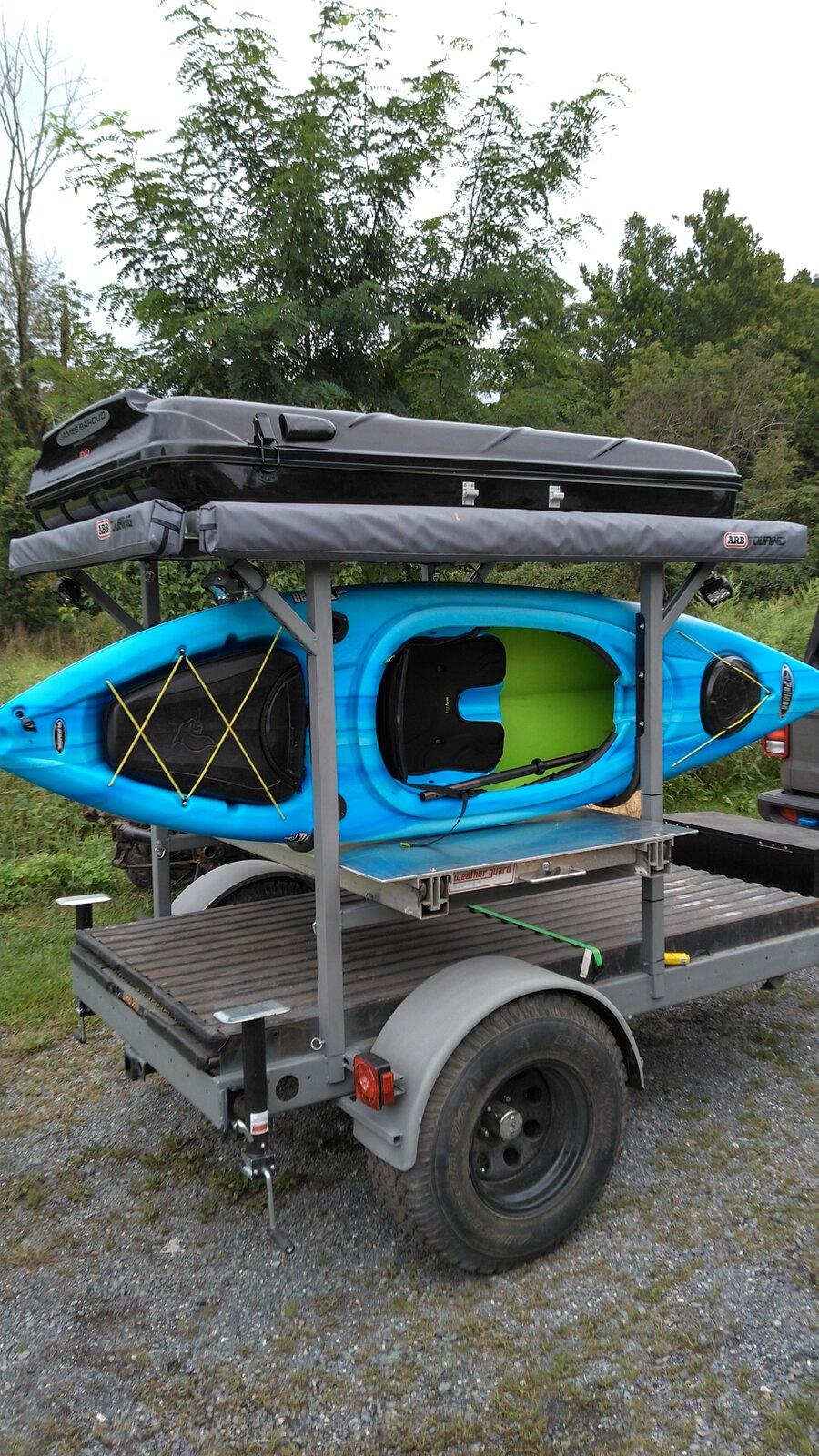

First trailer

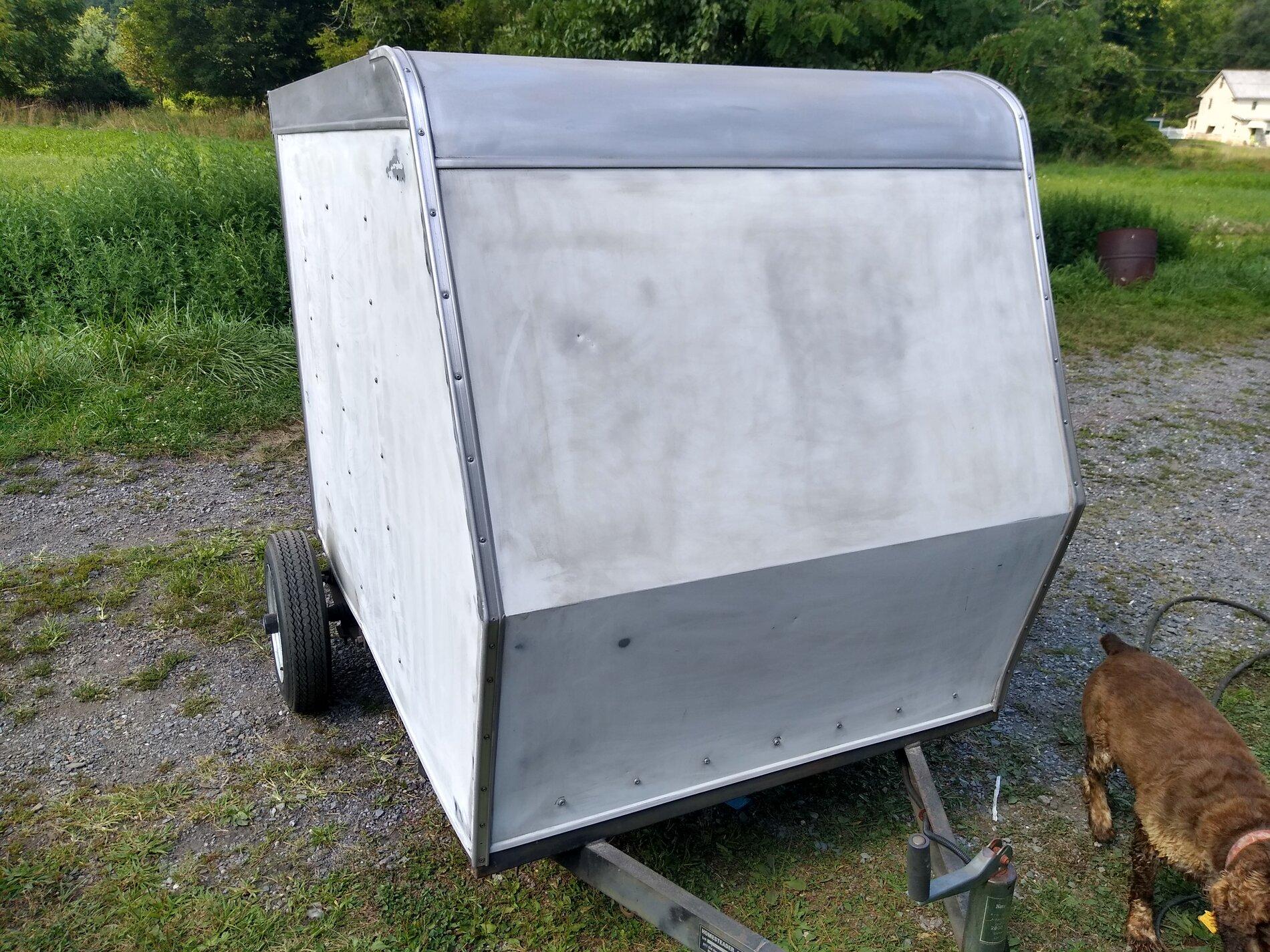

"New" trailer

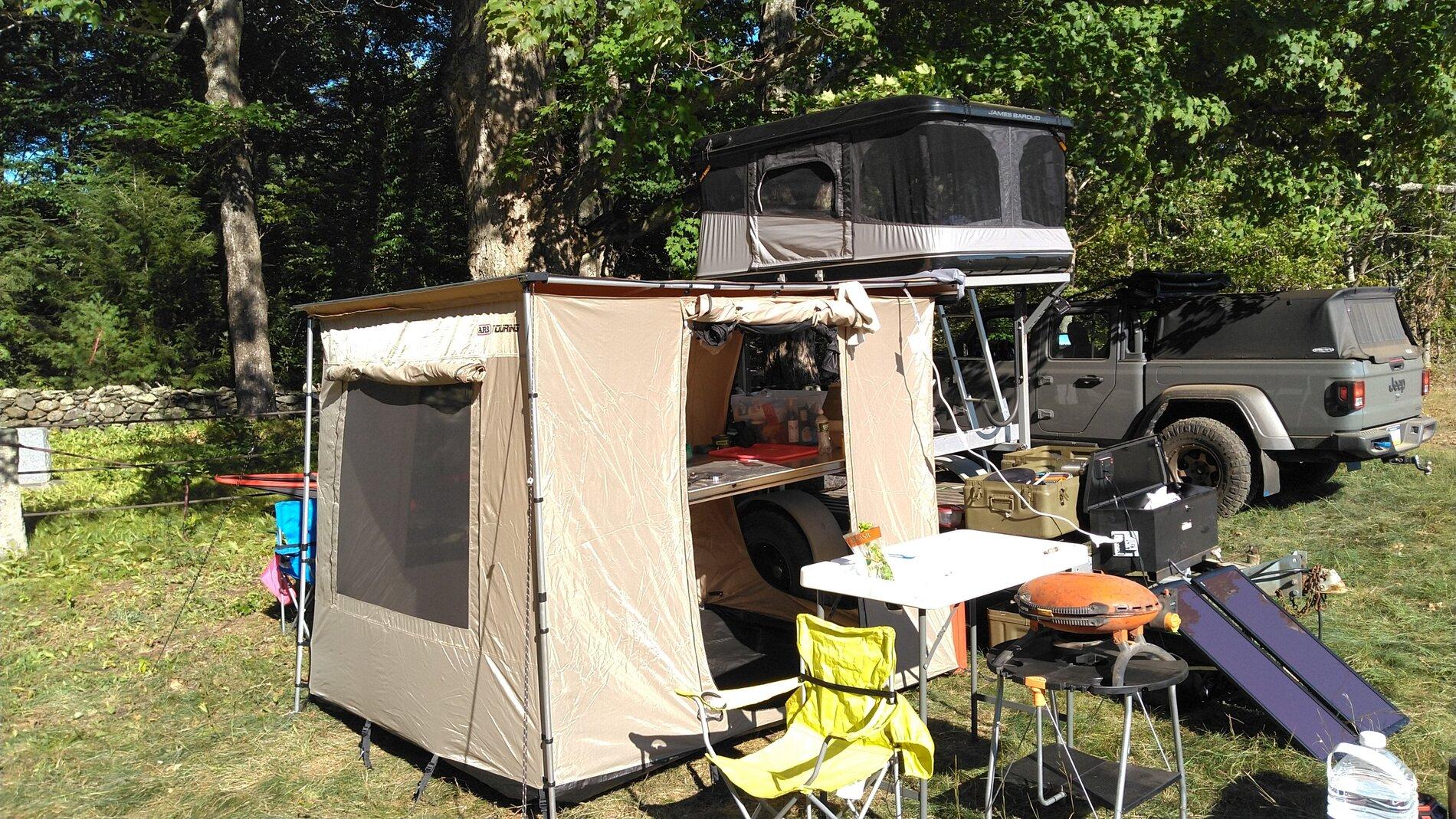

First trailer all set up in Maine last summer

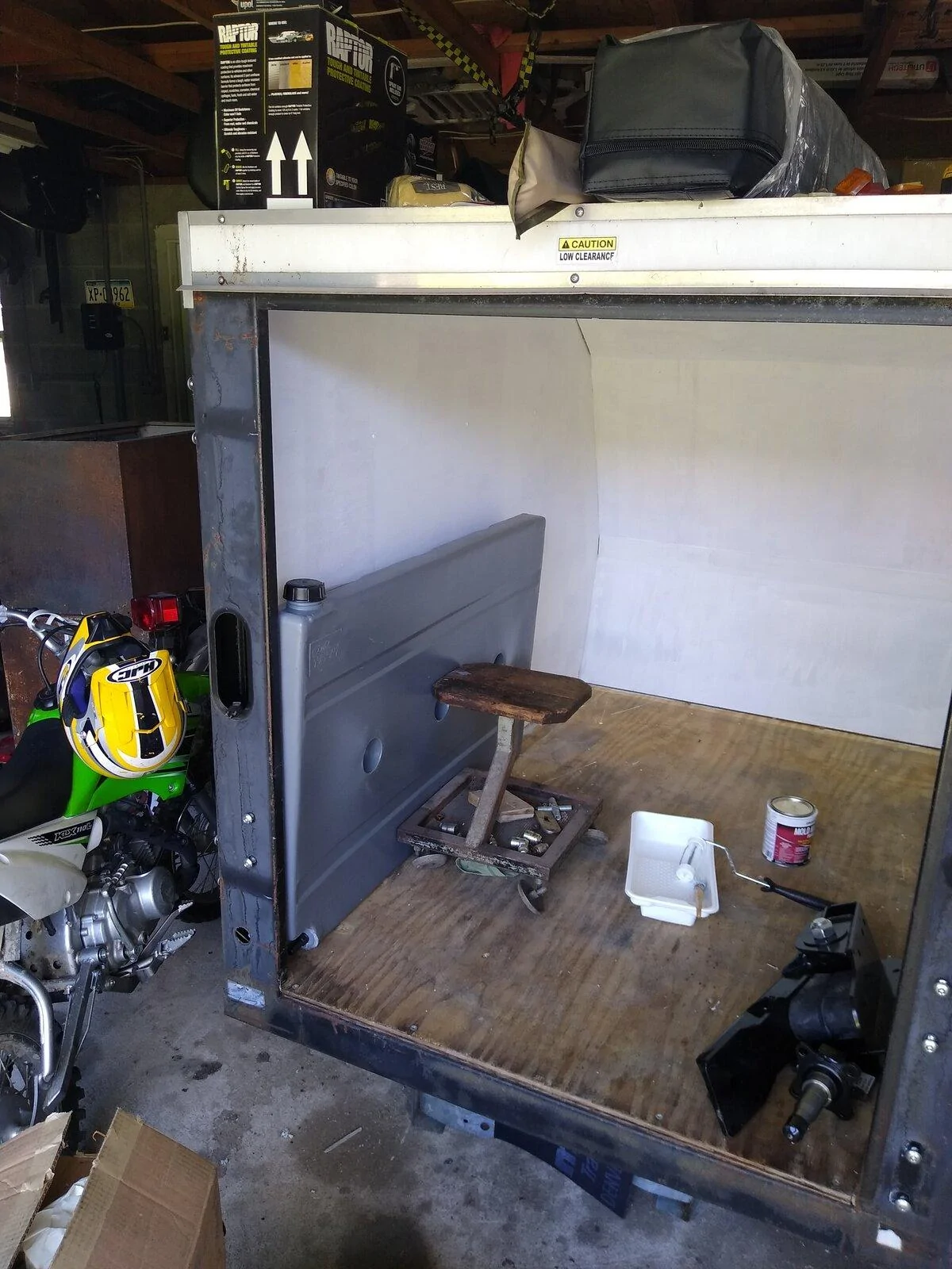

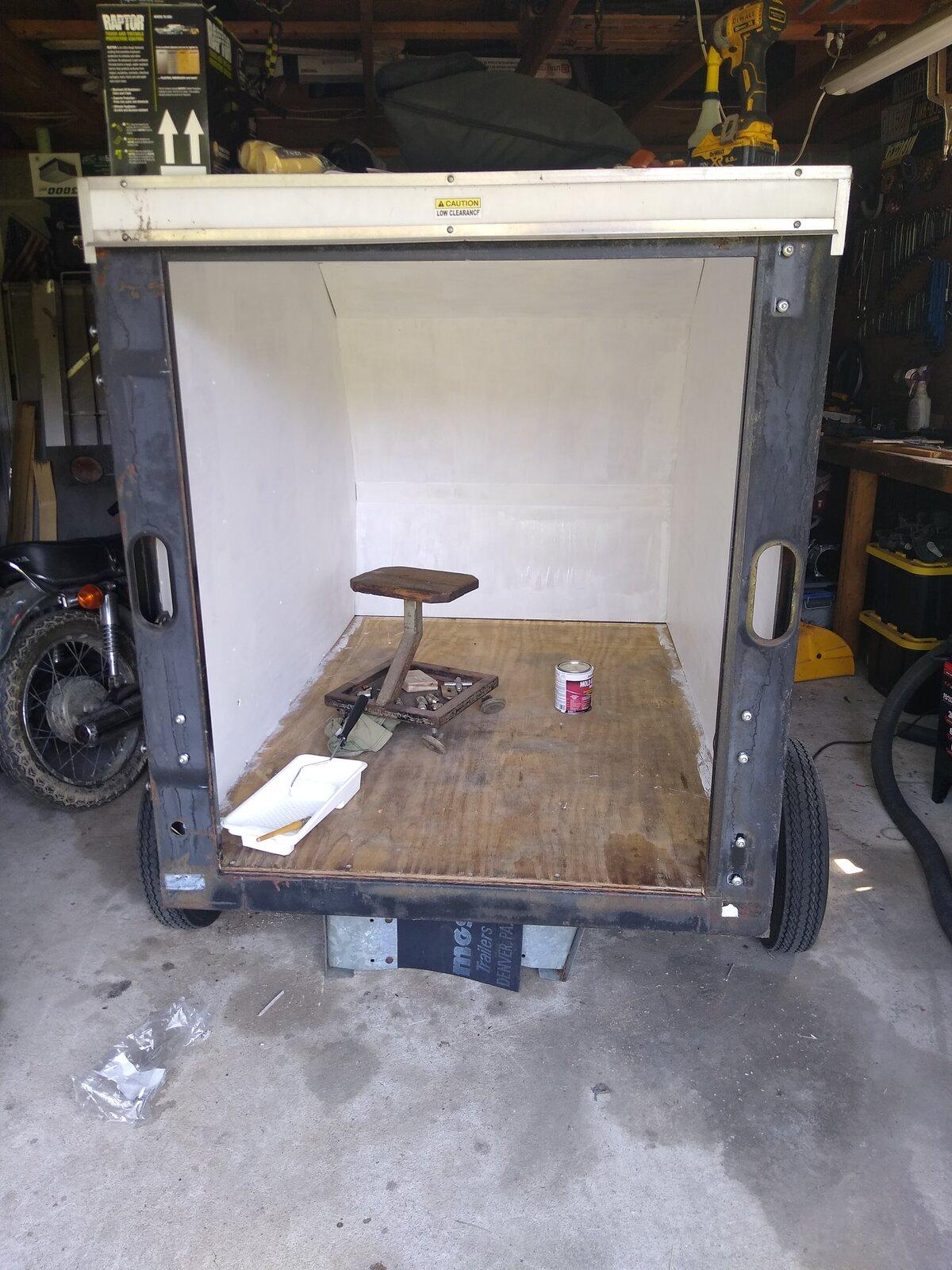

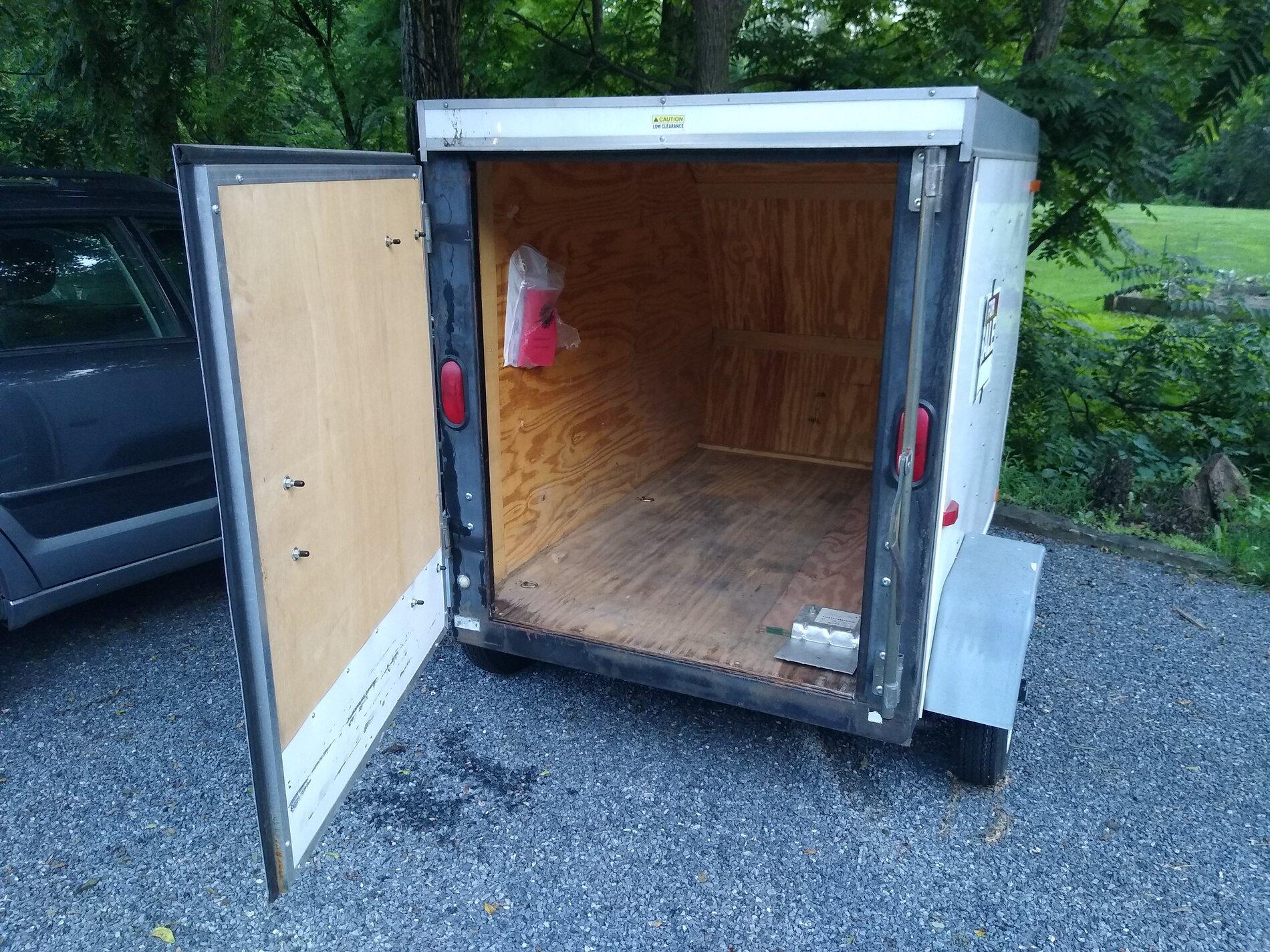

So as for now, I'm in the "planning" and "gathering" stage. I painted the interior of the trailer with a mold fighting primer and may carpet it depending on what I can get my hands on.
Jeep Gladiator Overland Trailer 2.0 IMG_20210731_153617875
Jeep Gladiator Overland Trailer 2.0 IMG_20210802_160859084
Placed a water tank about where it will be installed to see how it fits. I love how it uses up some of the wasted space behind the door frame. I have one for each side. I think they'll work perfectly.

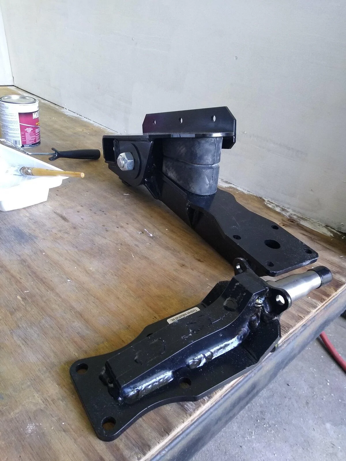

Timbren axle-less setup. 2,200lb units with brakes. Wow, these things are beefy.

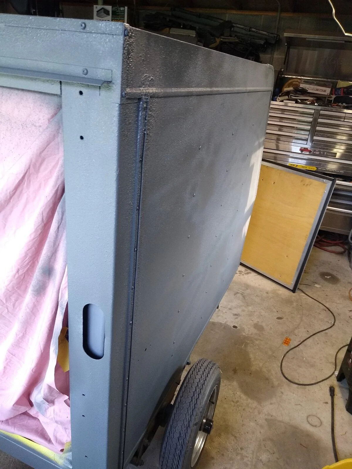

Sanded, primed and bedlined the trailer on Sunday. Better pictures coming. Also ordered a Redarc Manager 30 for the trailer, and a brake controller for the JT. Figured I don't want to mess around, and want to be able to be self sufficient for as long as possible off-grid, should the opportunity arise.
