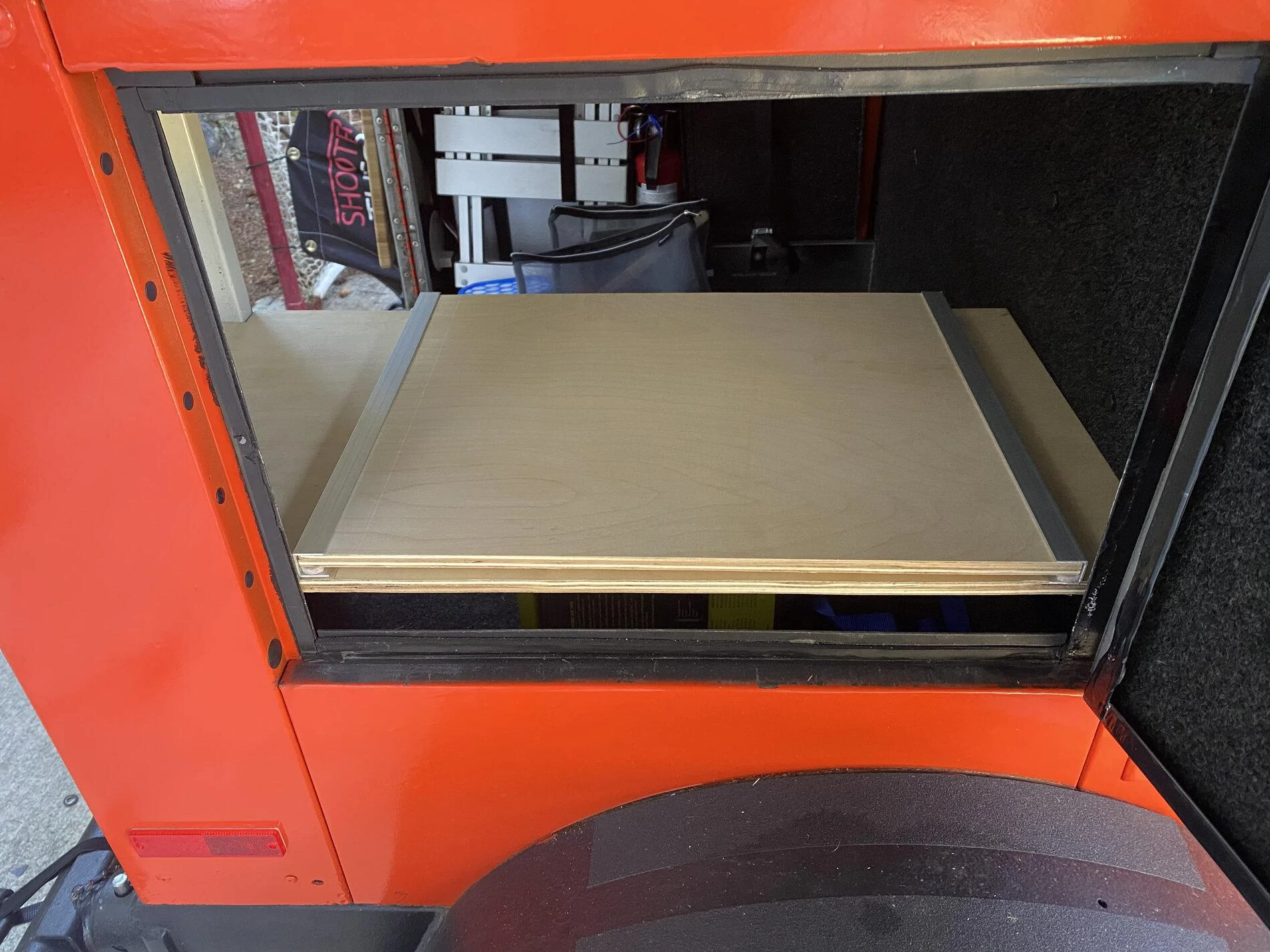

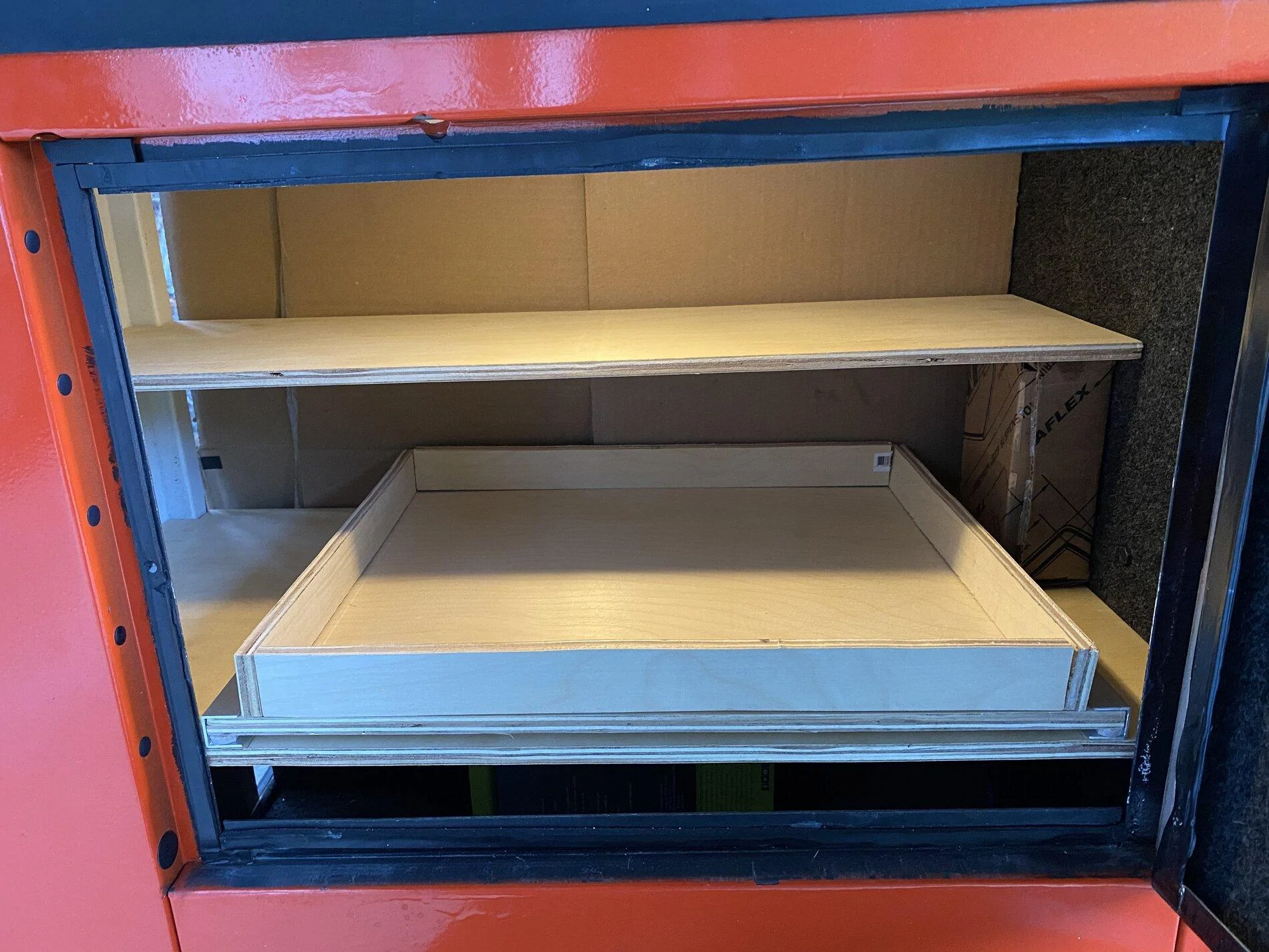

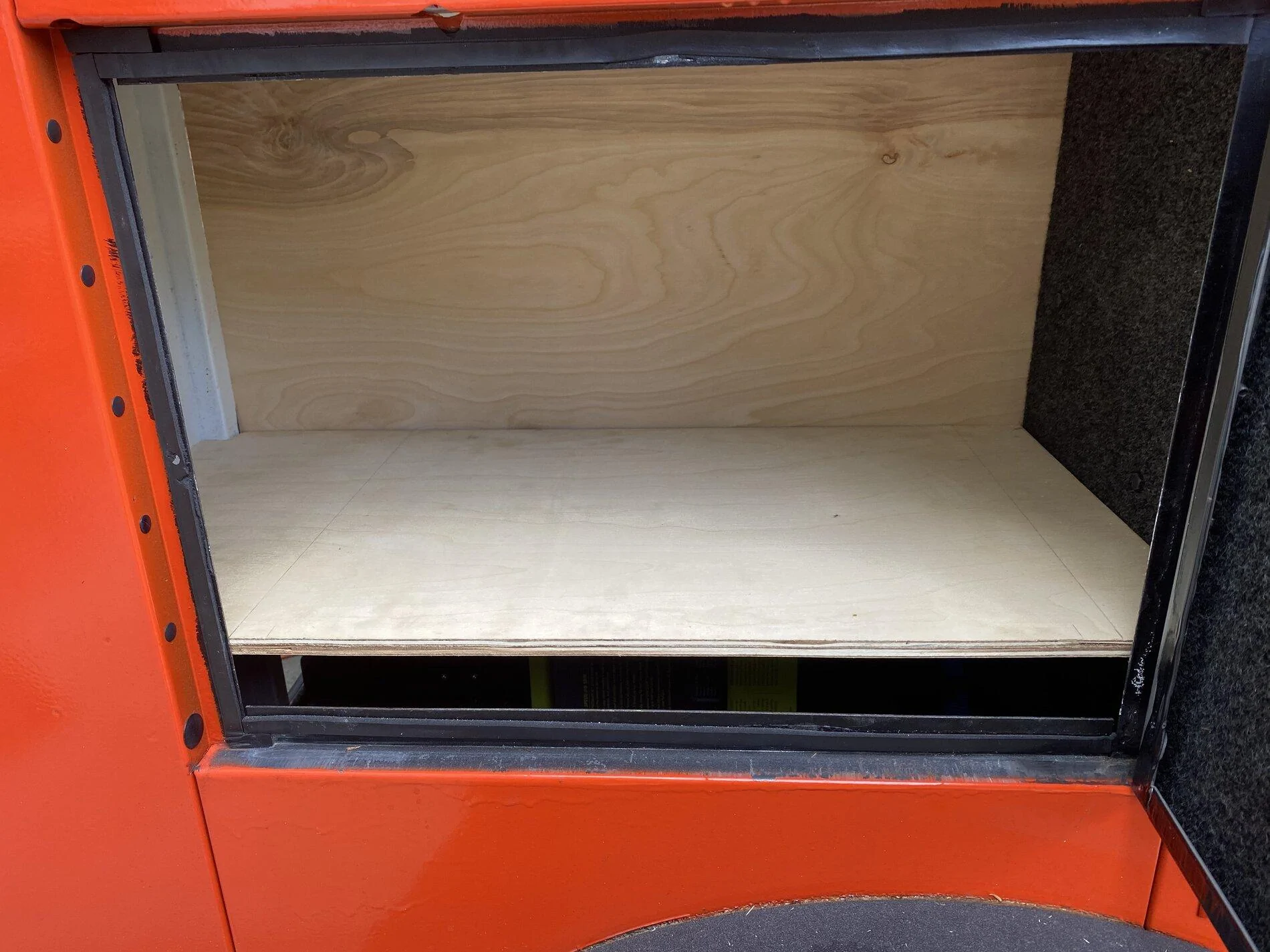

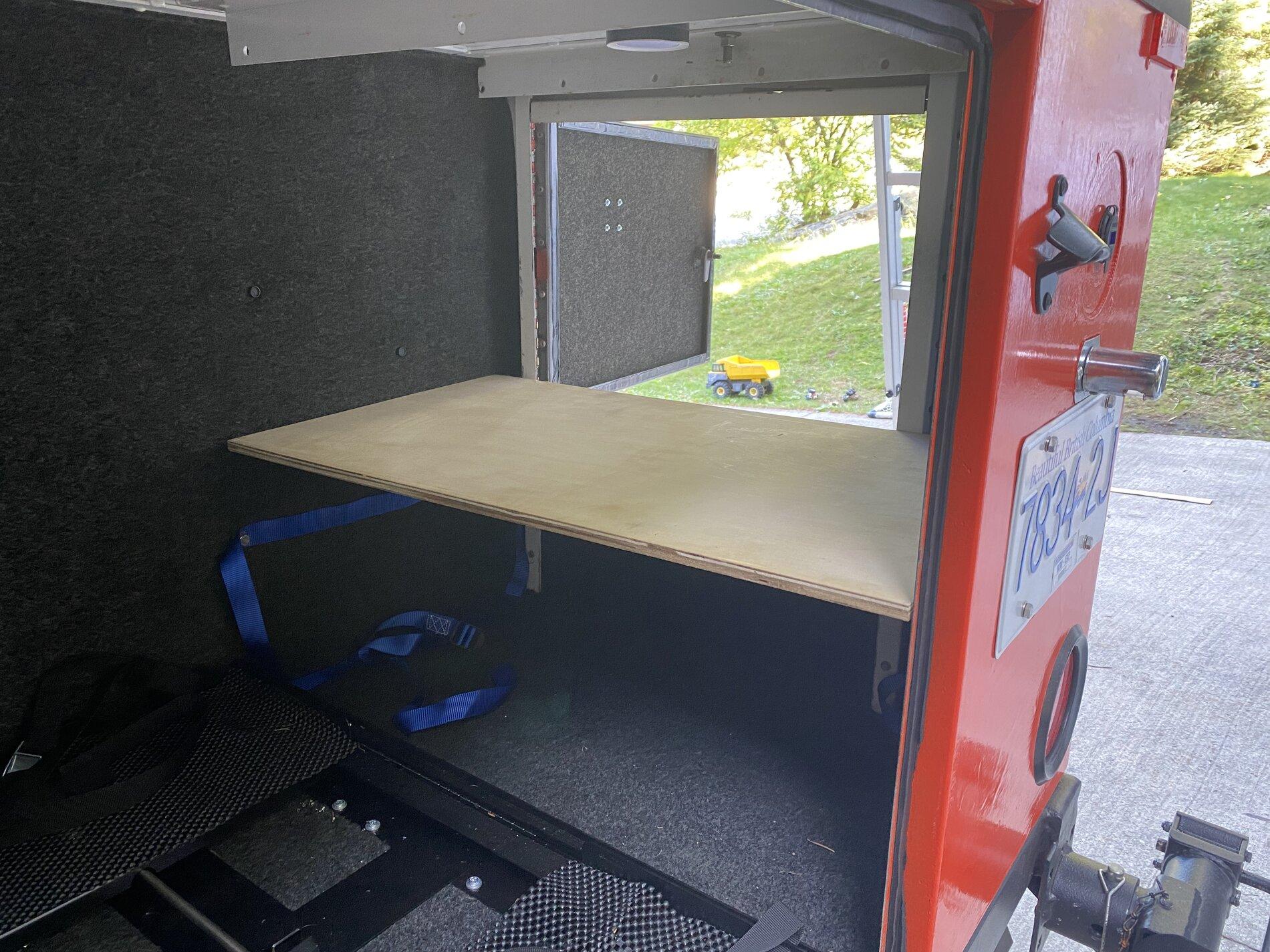

Mocking up a kitchen/storage area. Previously used for 2 5gal water jugs and 5gal grey water jug. Under the bottom shelf will be a designated 12gal rv fresh water tank. Top shelf with 1” lip for lighter items/seasonings/soups. Bottom shelf for bigger and heavier items with slide out bin. Still debating seeing if 3 shelves could work. Using baltic birch 1/2” and 3/4” aluminum c-channel to brace it all.

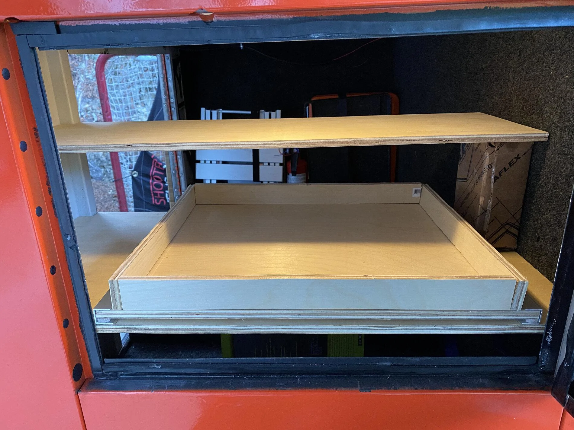

Bottom aluminum braces are in. Final varnish tonight and hopefully a rough install tomorrow. Still waiting for my 12gal fresh water tank before I do a final install. Also added 1/4” backer to finish the look. Keeping it natural wood.

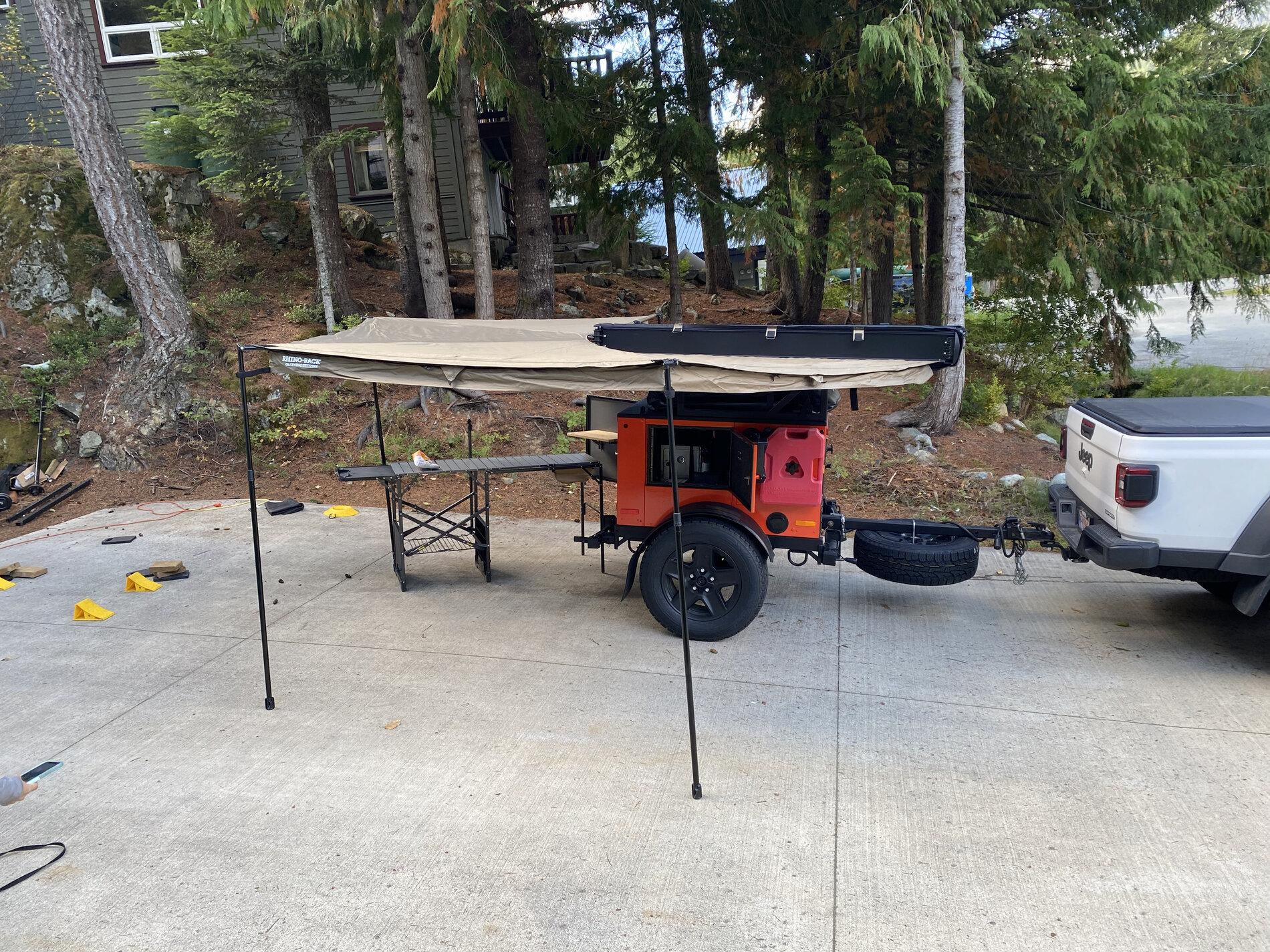

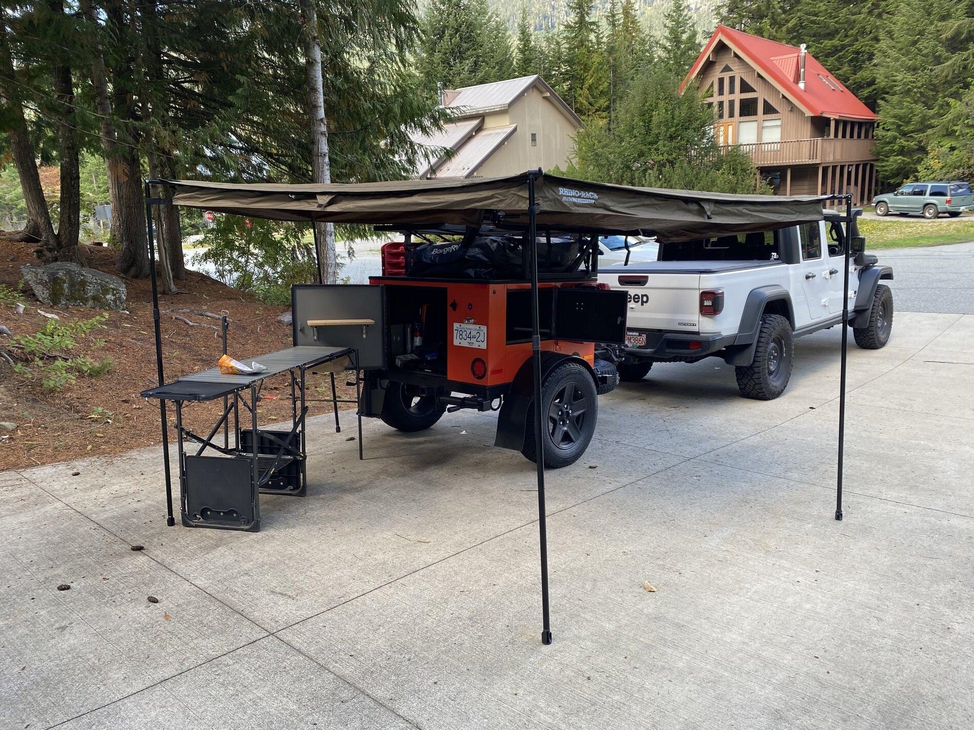

Rhino Rack batwing compact installed. Its perfect for this size of trailer. Im impressed with its ease of setup and pack up. Tent flipped to the driver side as the pantry/living/camping is on the passenger side.

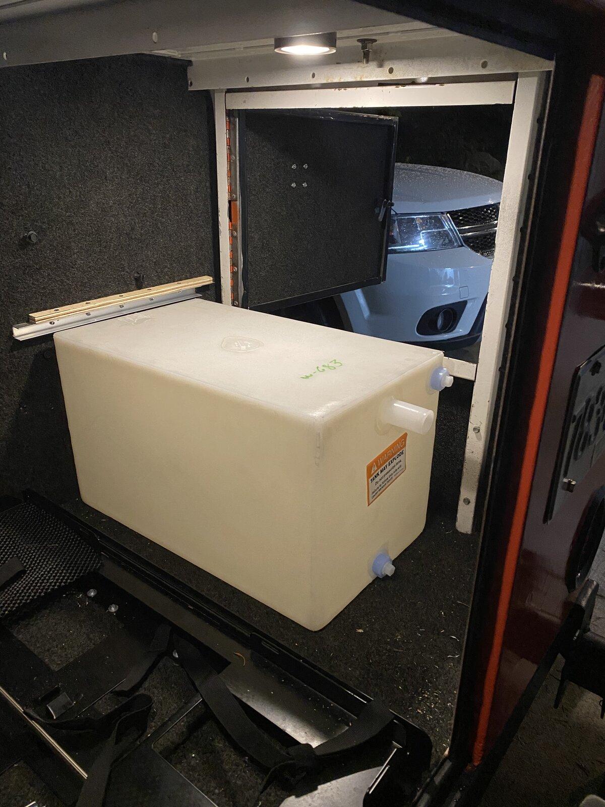

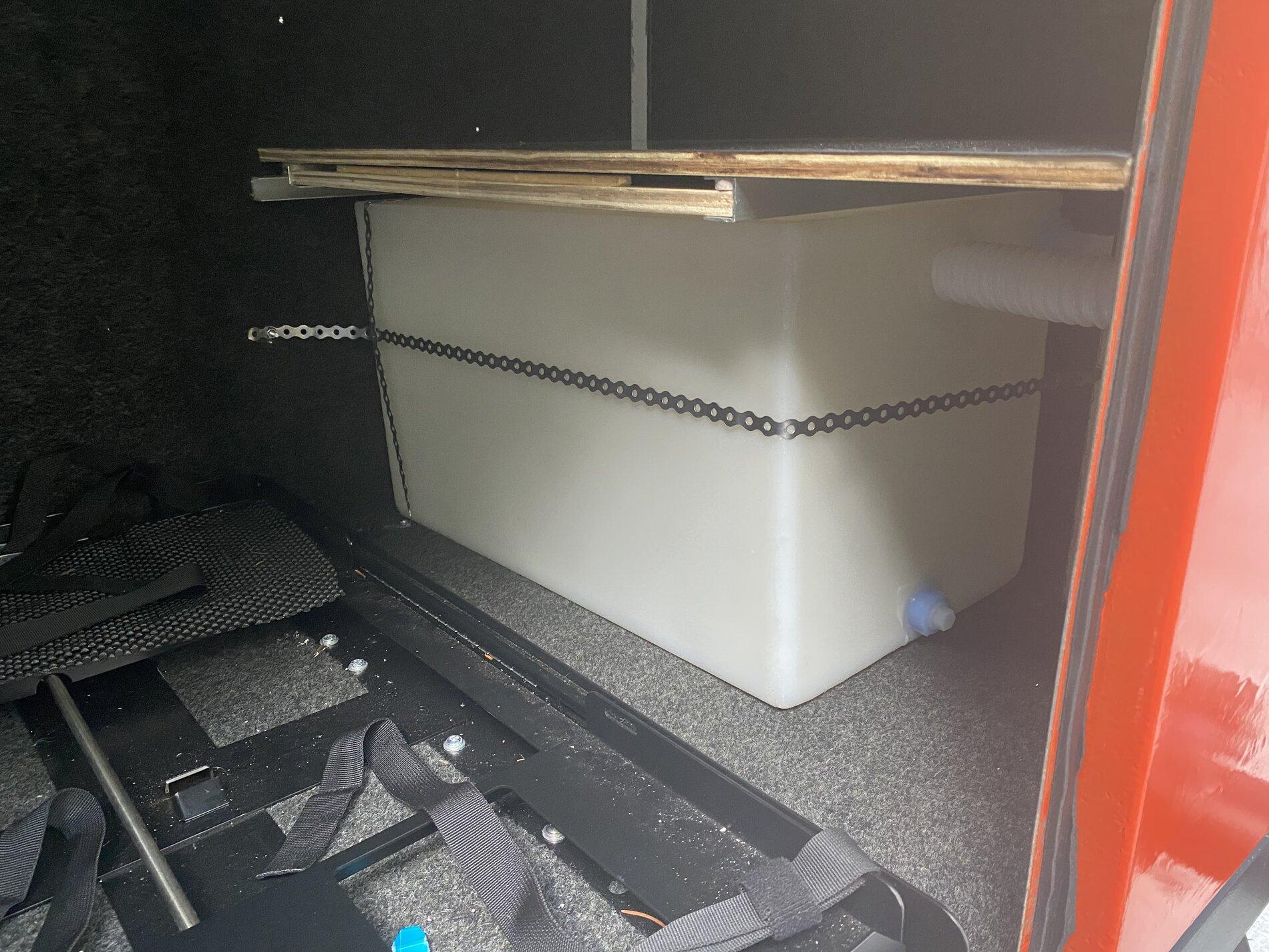

Just waiting for my 12gal fresh water tank to arrive monday. Once I get that in I can install my pantry for the food.

A small tip I can give on the water tank installation is to make sure it has a way for air to vent in the compartment and under/ sides of water tank due to condensation. Condensation and vibration can get though sealing of wood or metal that can lead to rot or corrosion. The condensation part I can say I know from experience in my Scamp T.T. of over 10 years. ?
So a closable vent in wall(???) My Scamp is "vented" to the floor at edge of stove/sink cabinet. In really cold weather I keep a desk cube heater in the compartment with T-stat.
I didn't notice a over flow line for the water tank but it's a good thing to have. :like:
All considered. Its nit right up against any wall although it might look like that in the pictures. Lots of air movement other than the bottom of the tank. As for overall airflow, the front has two vents and the rear shares those vents. I also keep and maintain my condensation bucket in the rear. Hopefully with being mostly steel and marine grade carpet, mold will be a minimal or non existent issue. Thanks!

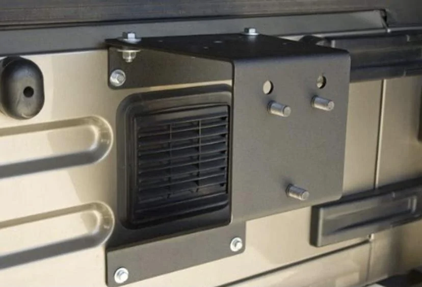

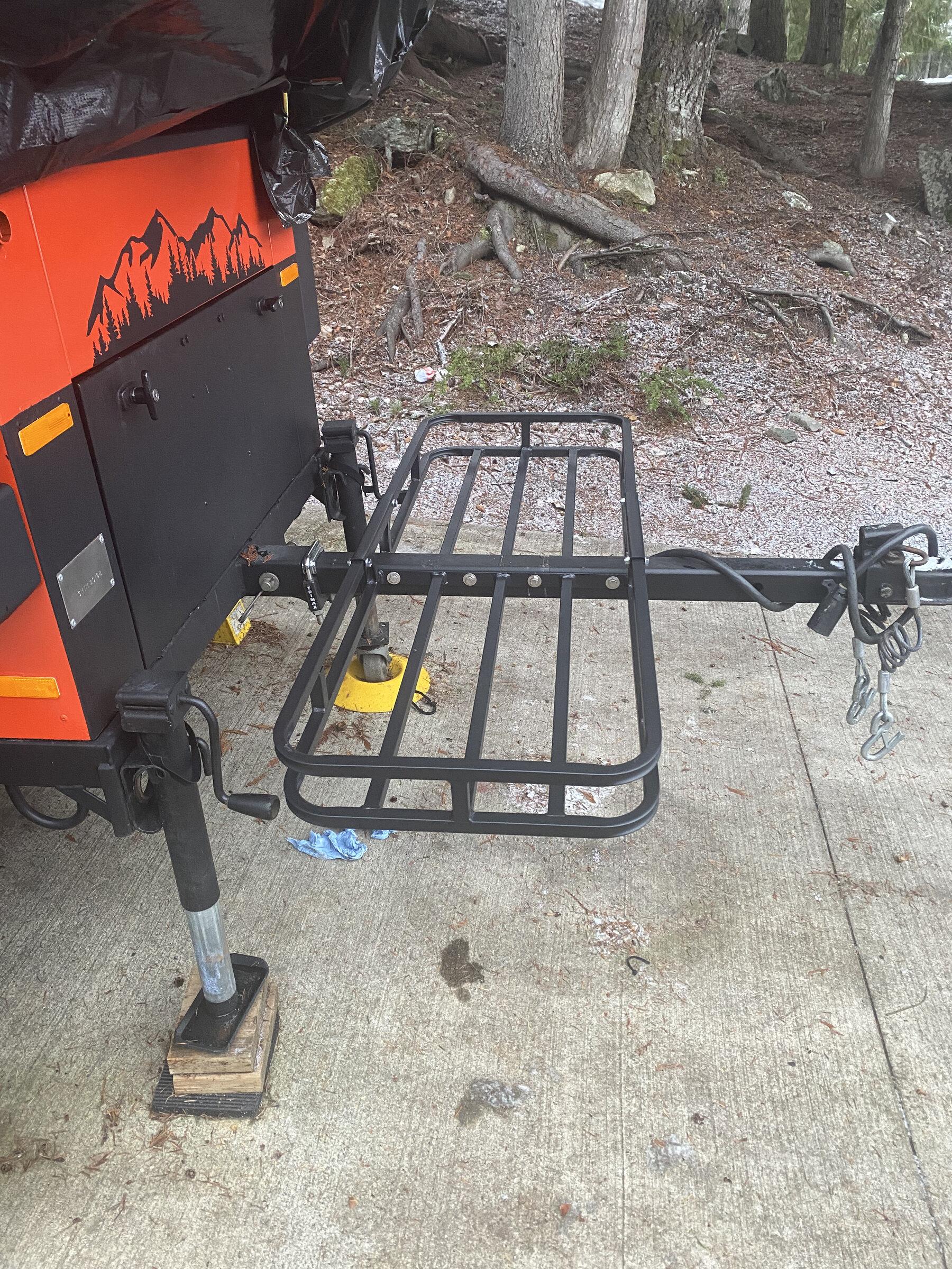

New updates for winter as I modify and make changes after our first season with the build. We found storage to be a small problem but an easy solution to solve. Ordered the camco hitch basket which im going to modify to fit on the front hitch portion of the trailer. Only needs to hold a couple small totes, maybe 40-50lbs of gear.
Second is relocating the spare tire to the rear swing out door. We did scrub the low mounted spare once last year on 4lo trail. Found the rugged ridge TJ door setup would work well. Some minor door reinforcements will be needed but it should work and clear the trailer/propane tank.

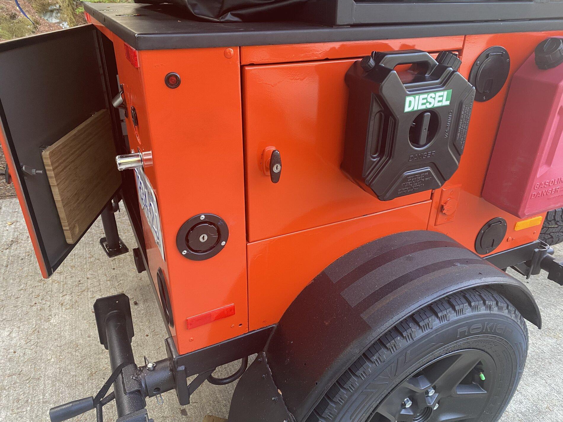

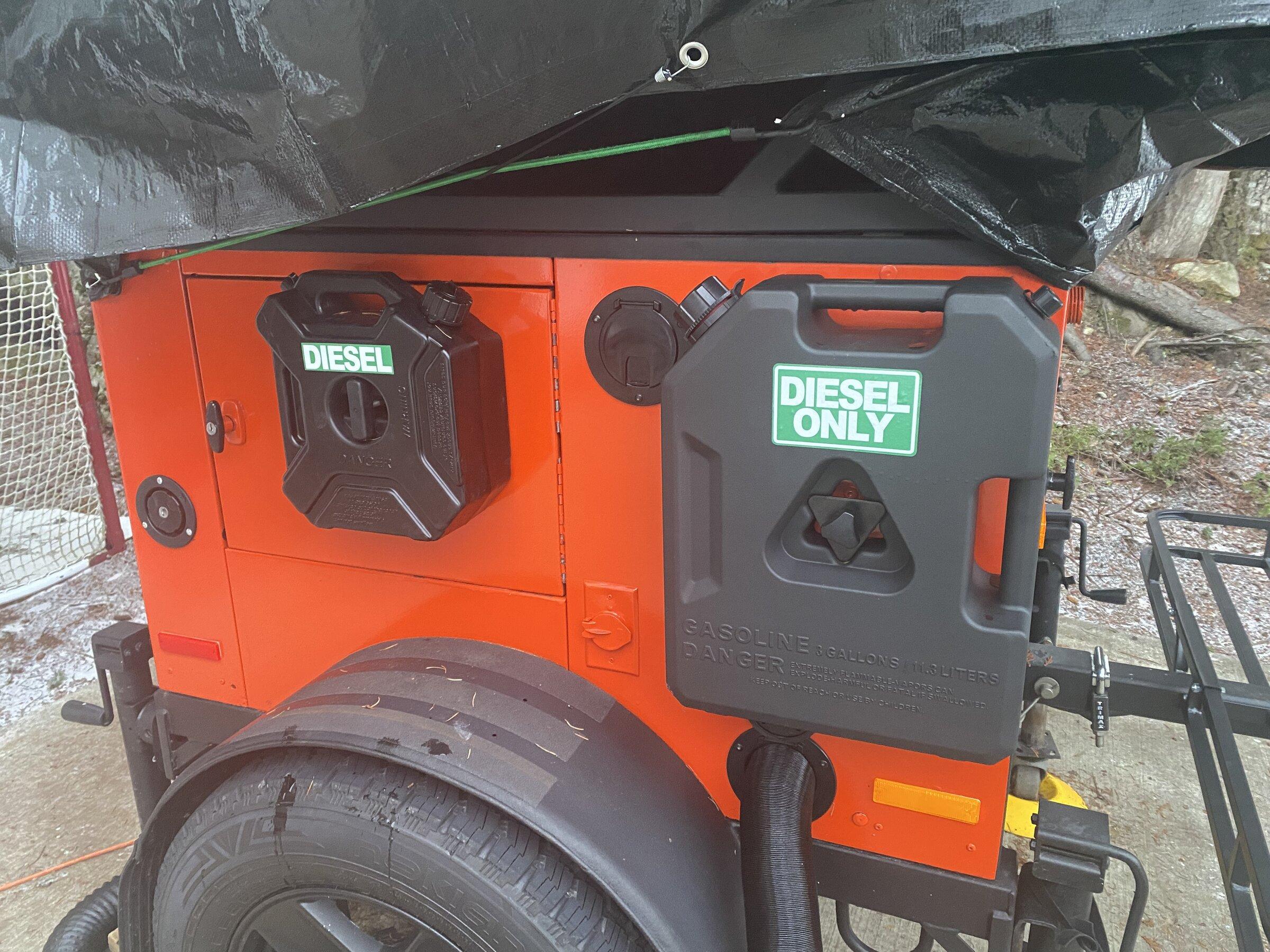

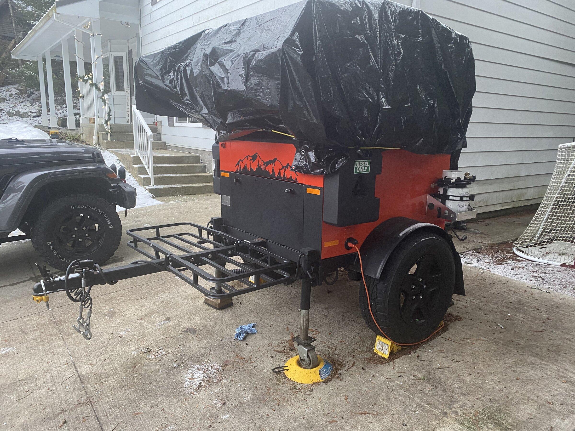

Added the front cargo basket today. Super simple install with some slight modification. Turned out great. Fired up the heater today and put in some winter PS additive. Jerry cans were painted black with diesel decals as well.
