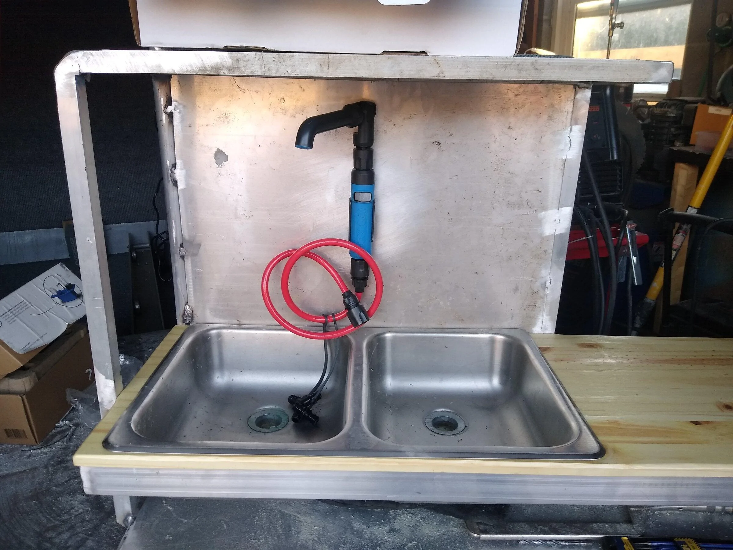

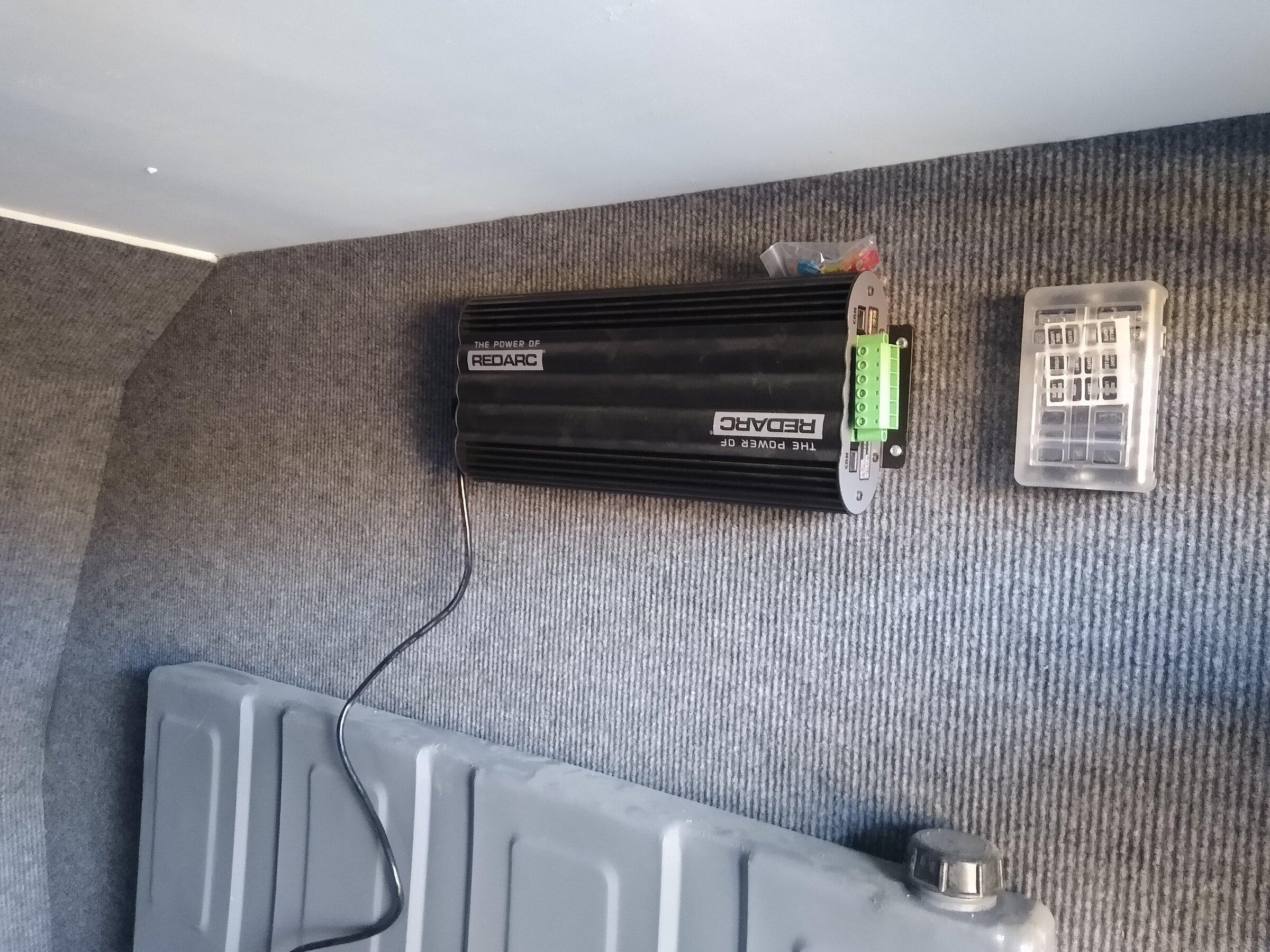

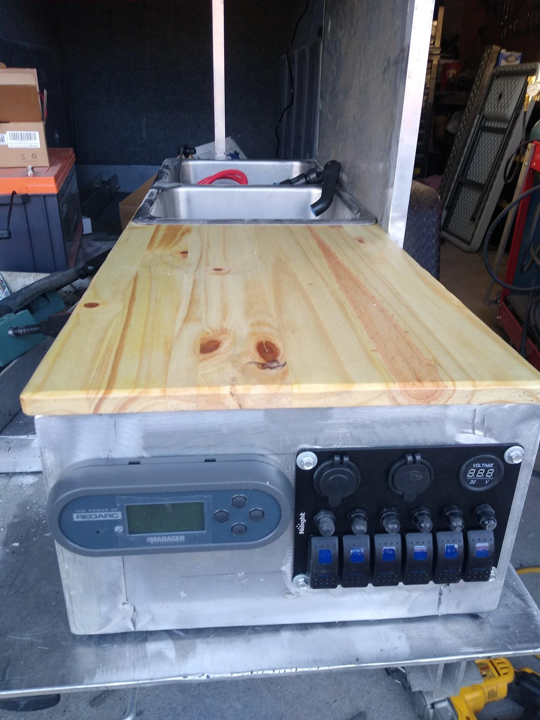

Quick update: Today, despite the cold, I got a little more work done. I mounted a switch panel (which will control the lighting and possibly the water pump), as well as the controller for the Redarc Manager 30. I remounted the Redarc itself so it's accessible, and also installed another fused distribution block in preparation for the wiring. Also mounted the Joolca faucet above the sink.

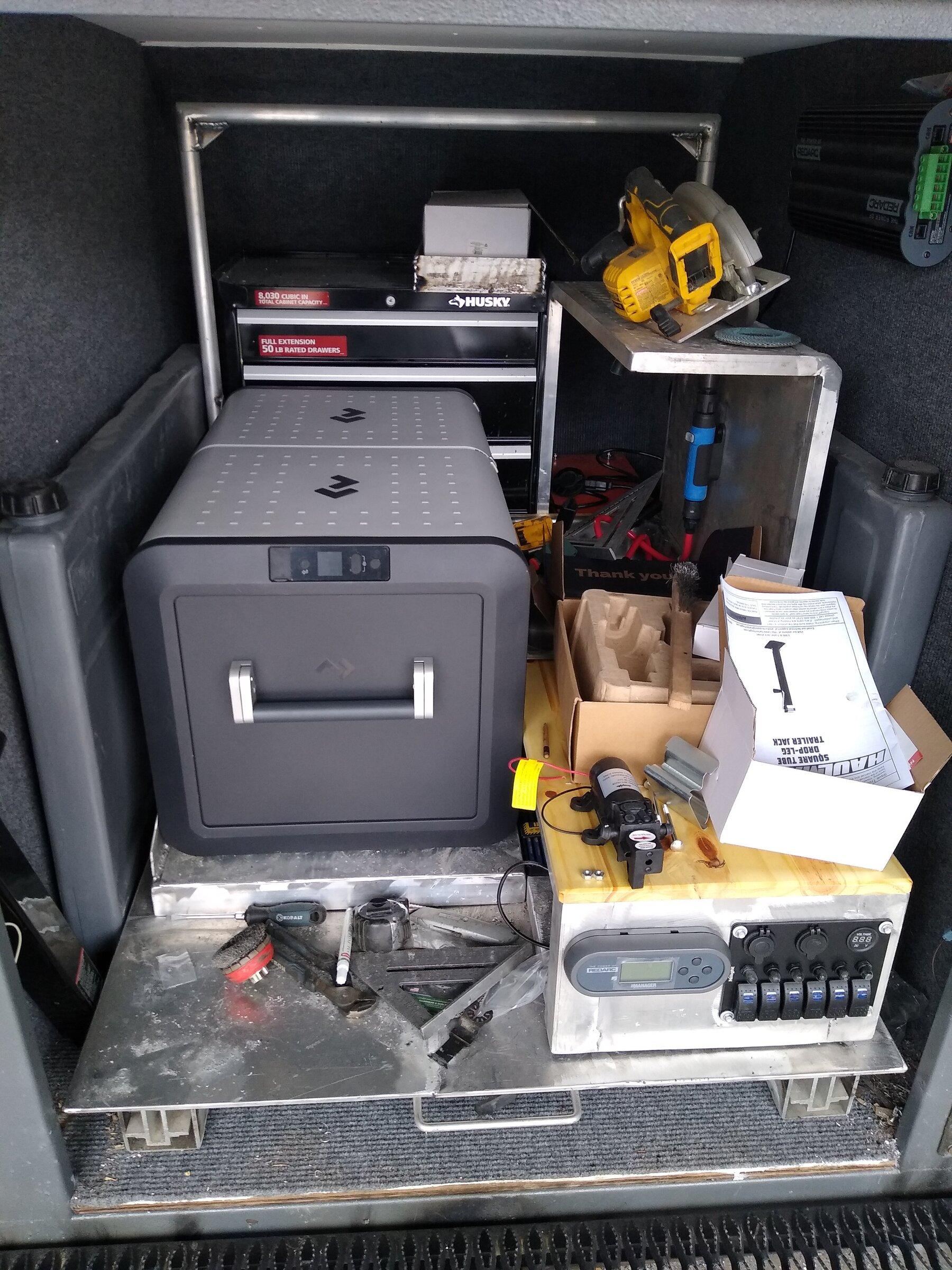

Got my fridge! Dometic CFX75 And man, it's a tight fit! 0 extra room.

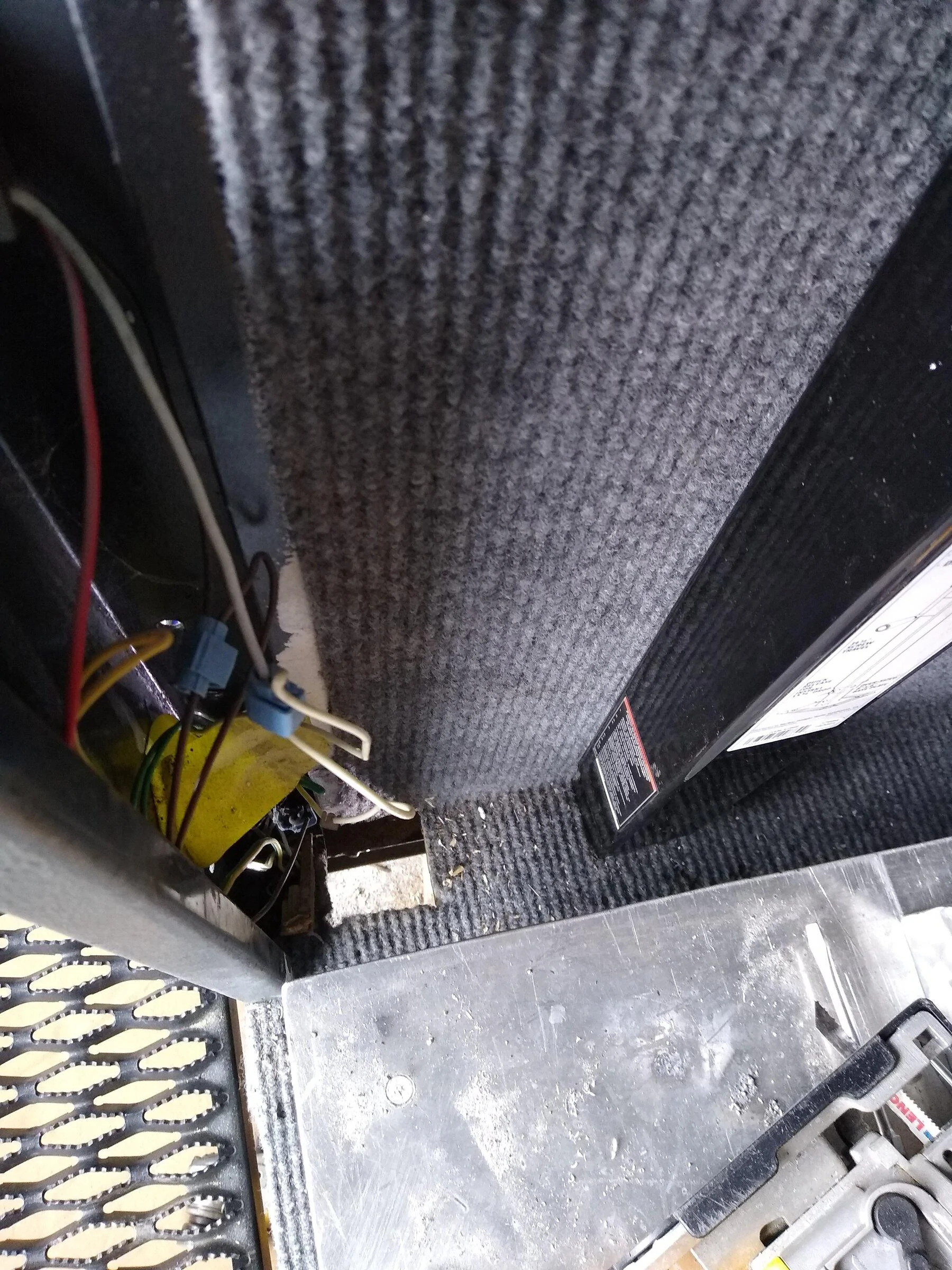

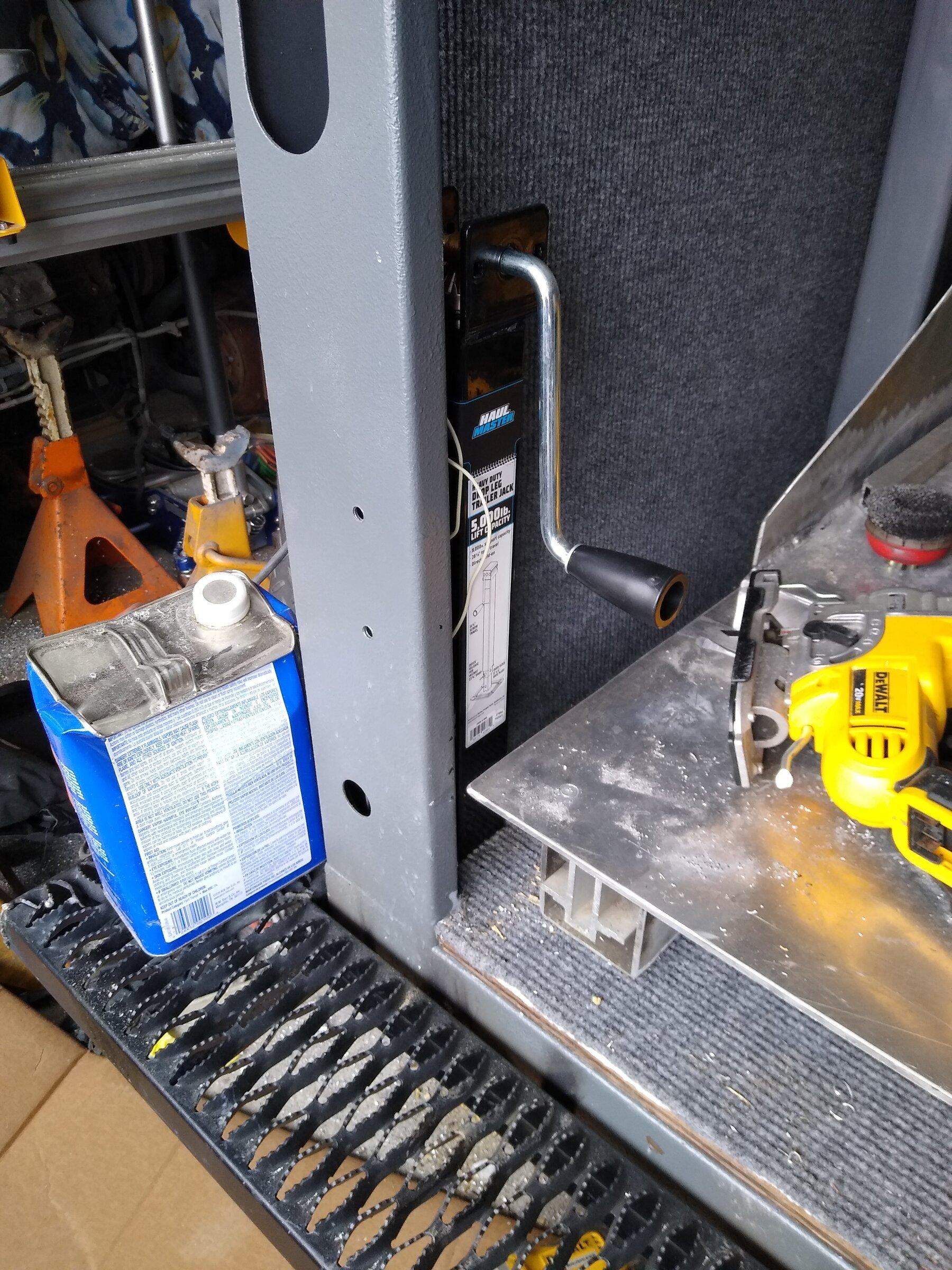

Also started to mount my leveling jacks. I cut a square hole through the floor inside the trailer, so they wouldn't be exposed to the elements, and it'll provide better protected for them.

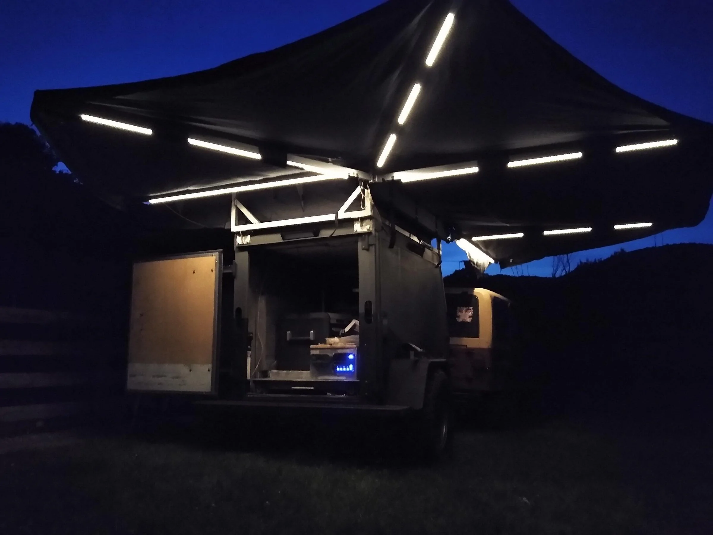

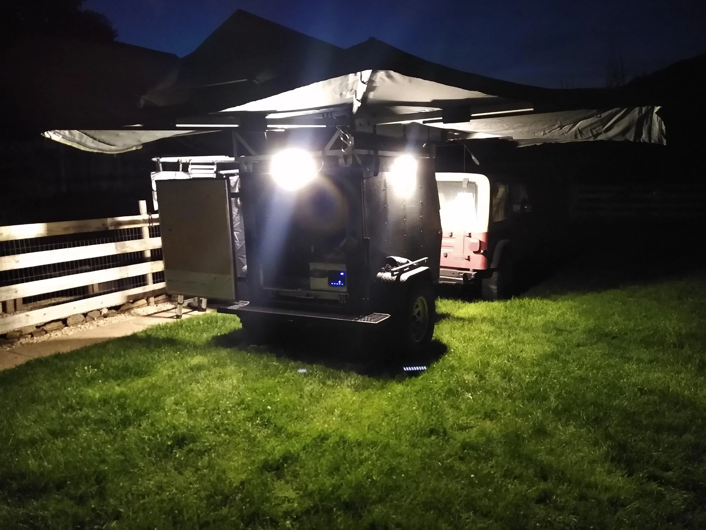

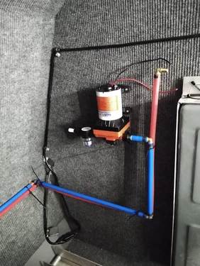

It's been a minute since I've updated this thread, but I'm still plugging away every chance I get. Water tank mounts are built, electrical is nearly complete, out second coat of bed liner on, and installed various sets of lights. Plumbing is next on the list...

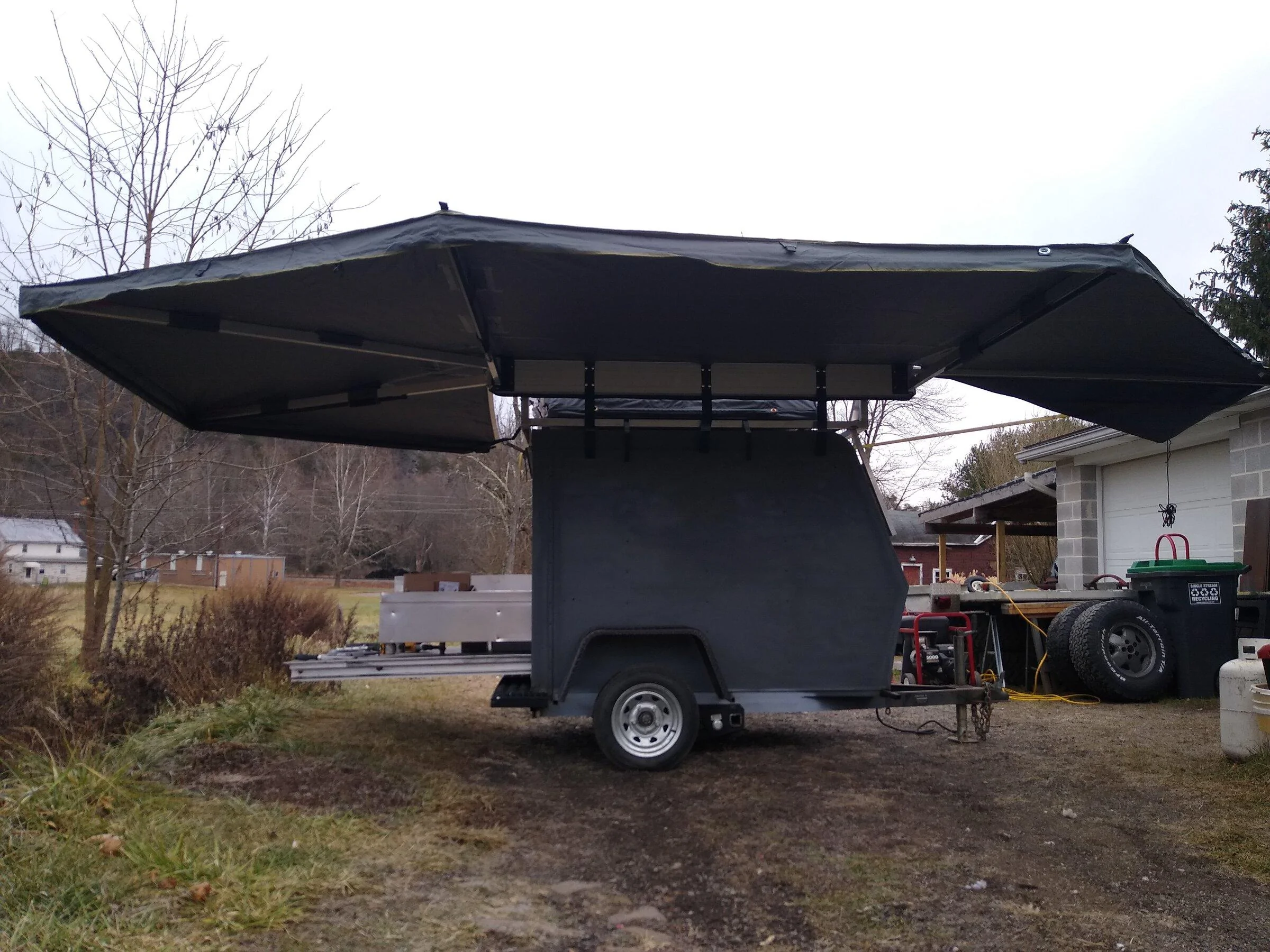

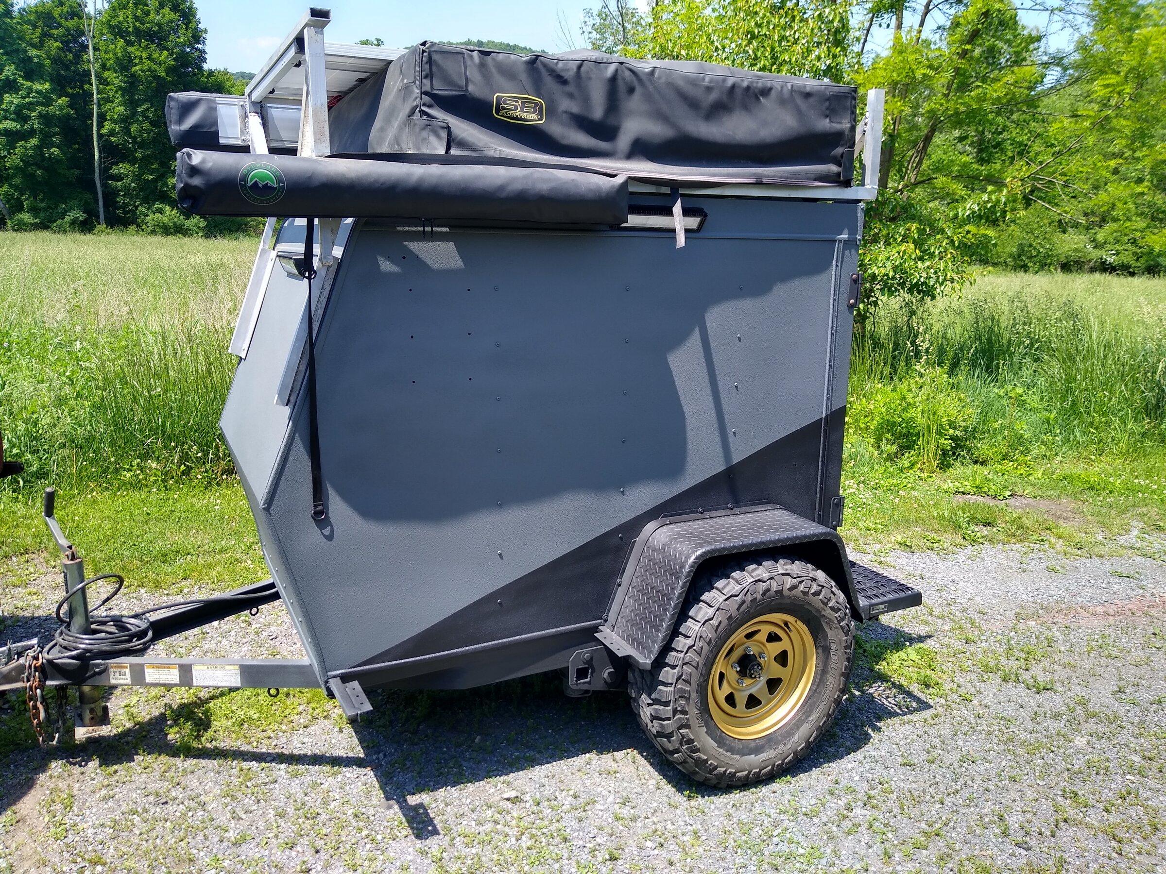

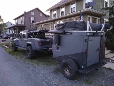

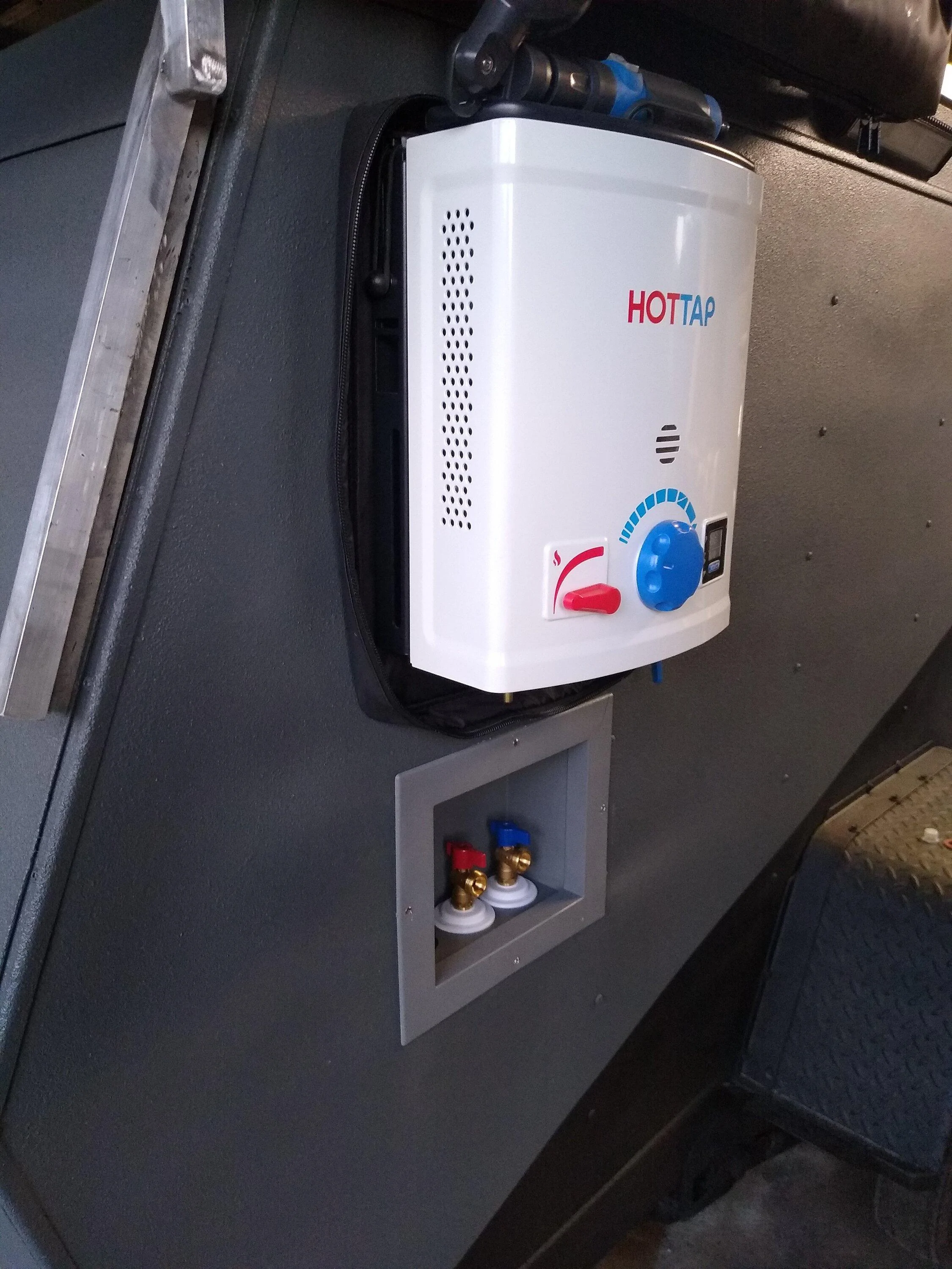

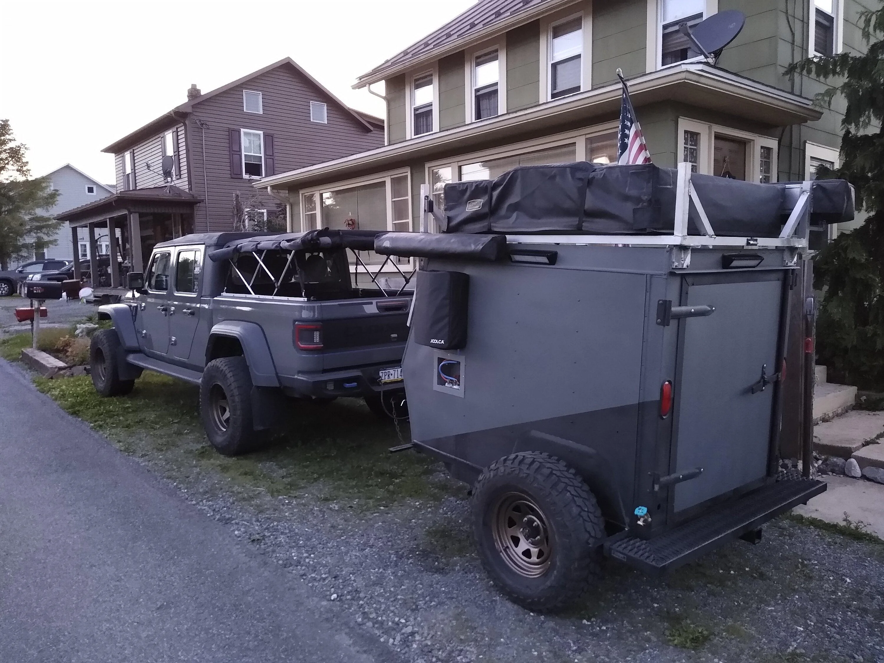

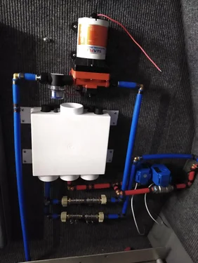

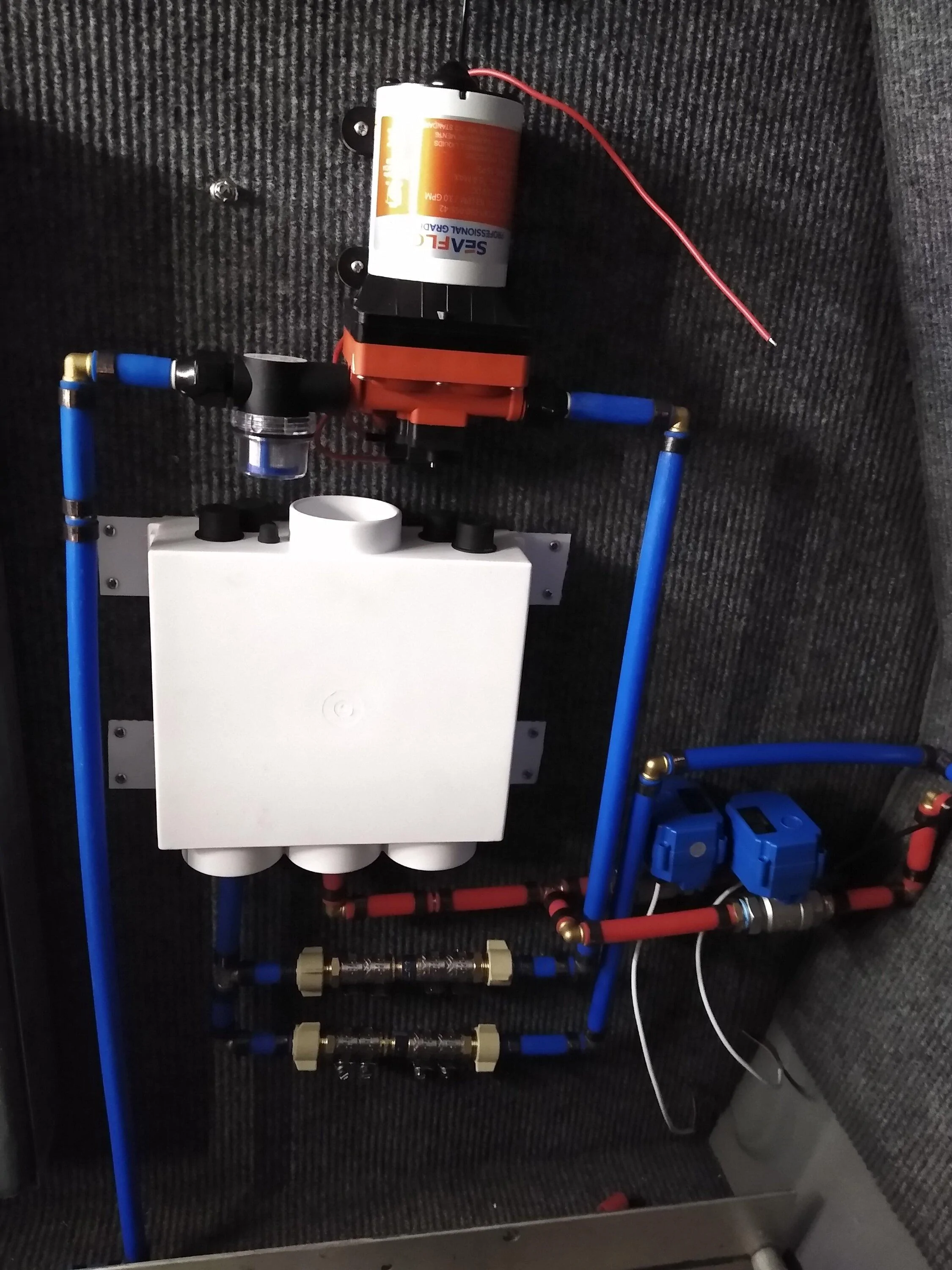

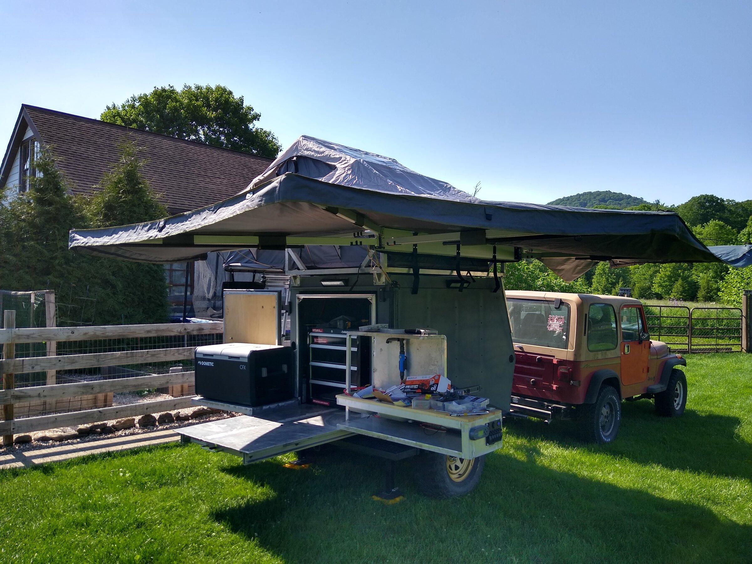

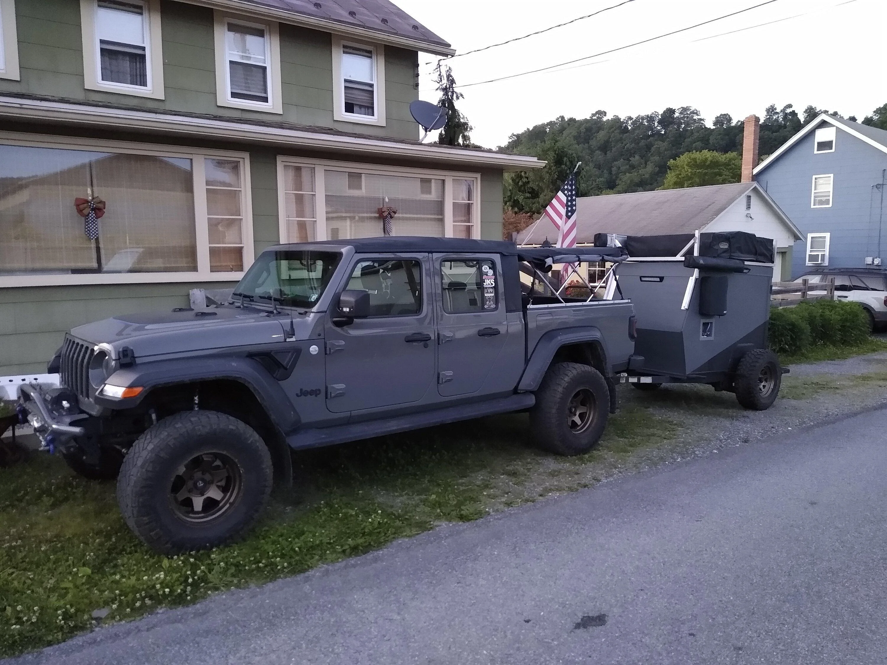

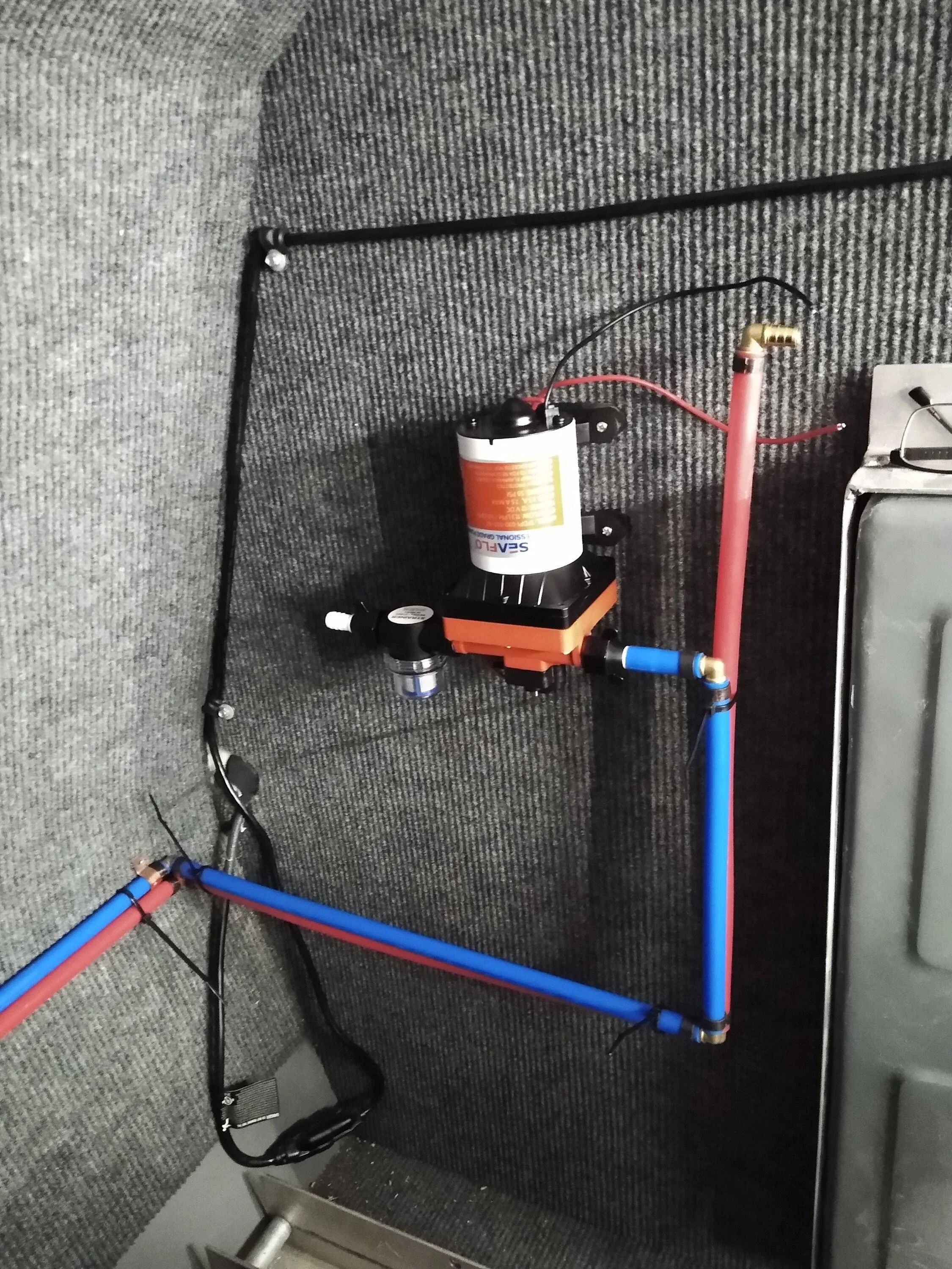

Got a drop hitch and was able to hook it up to the JT. I repainted the wheels to match the ones I have on the truck. I do have to rework the fenders, hence the missing one, as I'm having some clearance issues. I think I'm going to build some aluminum fenders from scratch, rather than use the premade ones I had gotten earlier. Also tested out the water system, and it works! Pretty complex for a small trailer, but I wanted to see if it could be done, lol!
