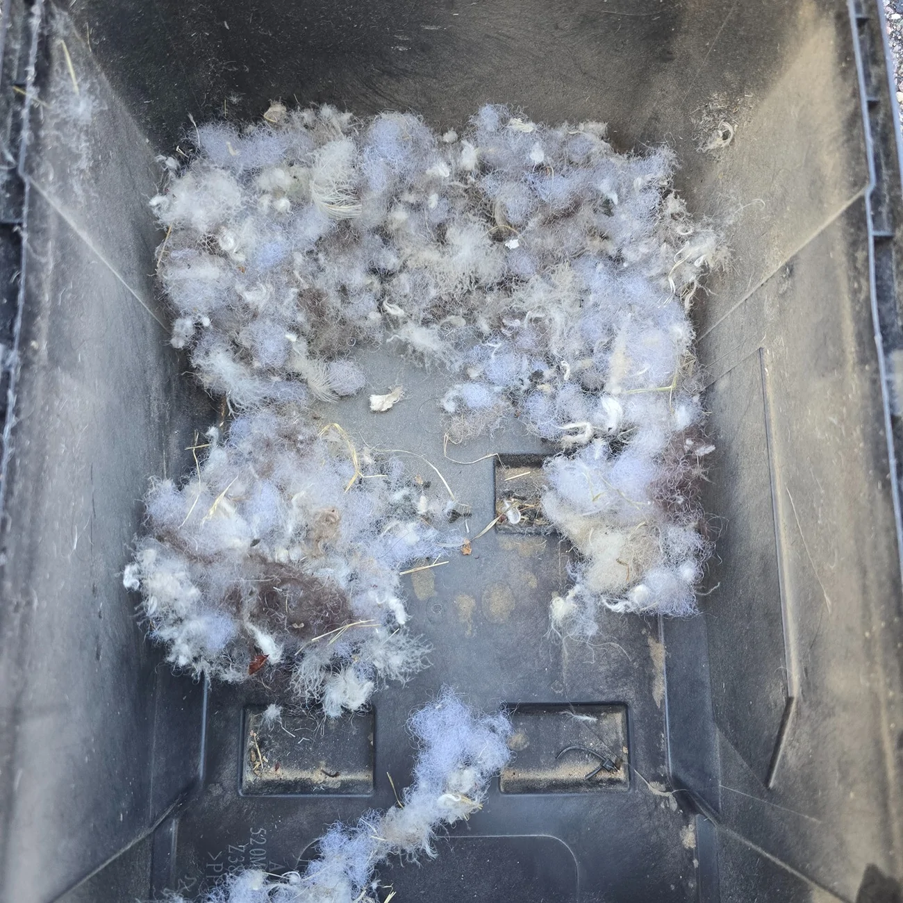

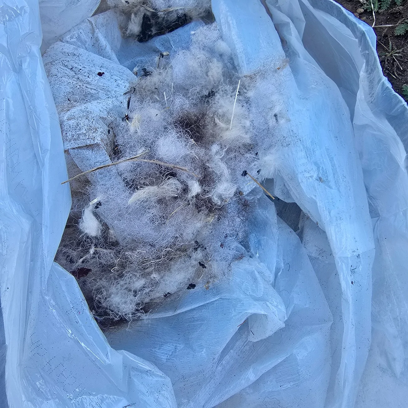

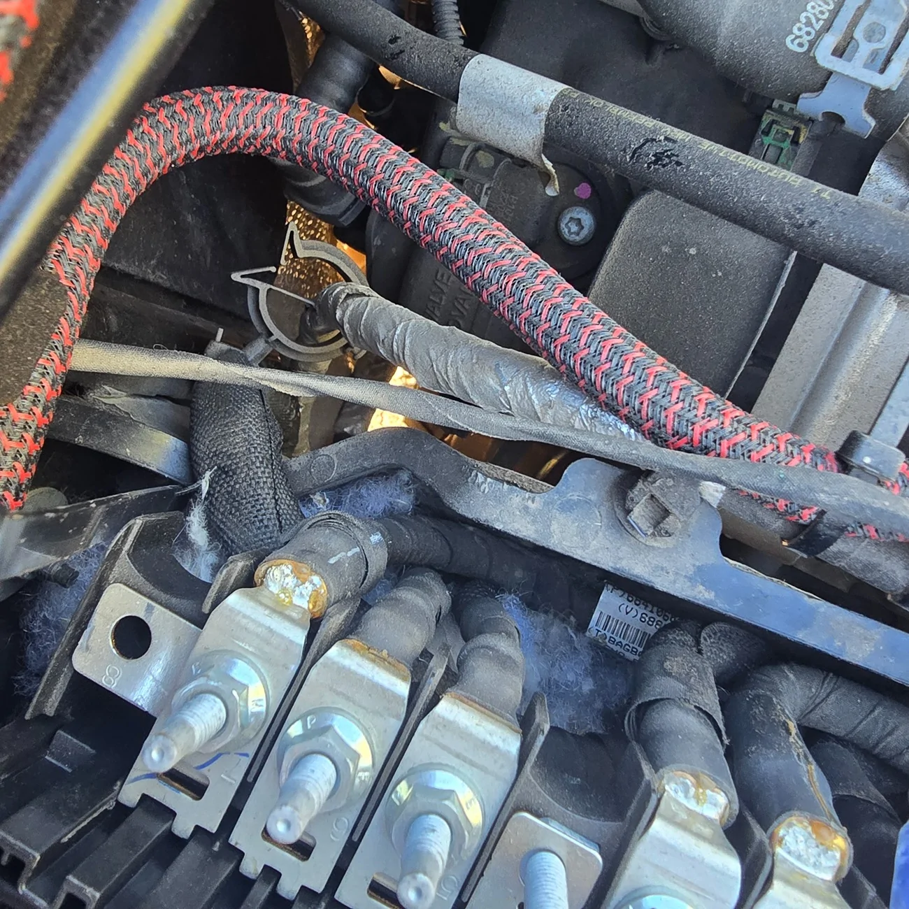

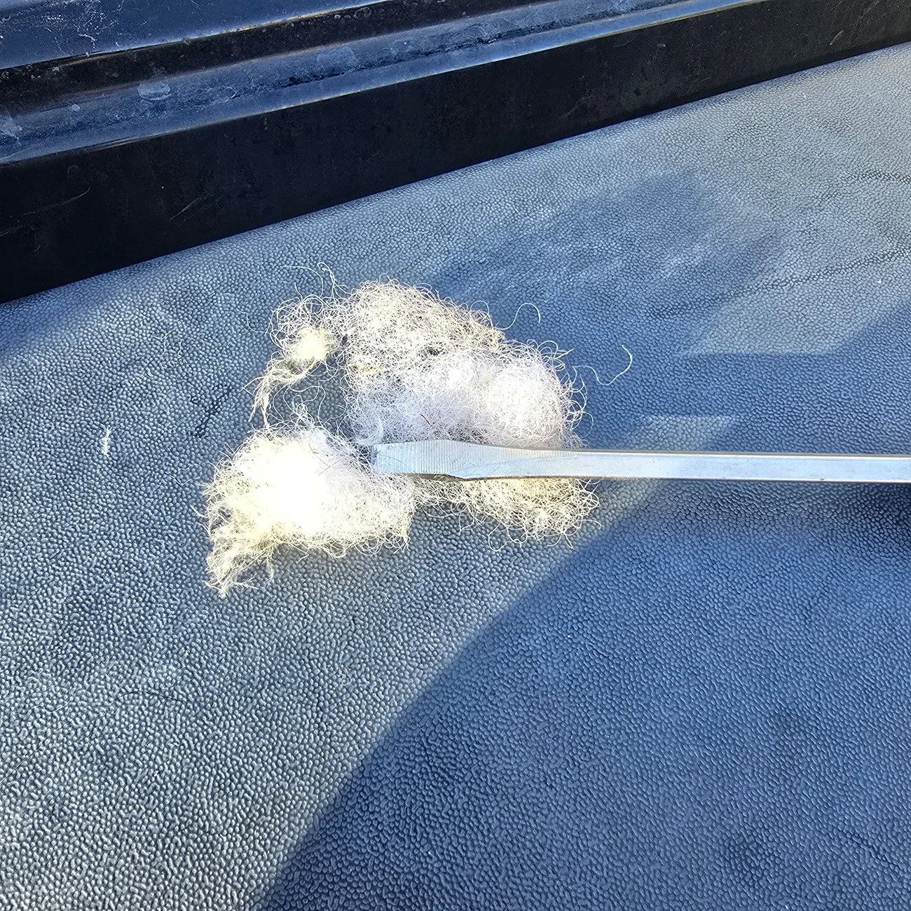

Checked battery and it is snug. I was looking over fuse box and noticed some odd stuffing. Started sucking it out with a shop vac. Does look to have come from the jeep and it also doesn't have poop. A critter must have been building a nest and shorted themselves on a wire.
Is it worth taking the top of the fuse tray off to see how big it is under there ???

I took apart below the main fuse tray and I could not find any mice or any additional stuffing. Most everything was along the z bank wire fall. Maybe this weekend I'll take it all apart down to the ESS battery and see if anything else shows. I sprayed a bunch of repellent down there so any future work of mine will surely make my eyes burn a little just working and alot if I touch anything and then my face haha!!

I'd be concerned that they actually chewed into a wire causing this. There's no way a rodent just going across those terminals will throw a code - they are all connected electrically anyway.
I suspect there's more damage somewhere, a wire that's chewed, maybe mostly or partially broken or shorting against a ground. You could connect every stud you see at that high current fuse area and nothing would happen - they all have battery power to each of them.
In short, I see nothing there that caused what you saw for errors. Even if they peed across all of those terminals, it would be messy, but not a problem to throw a code.

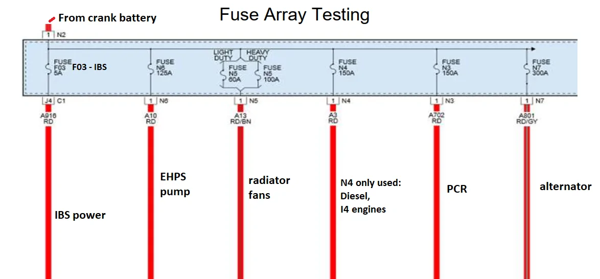

Also I read in a JL forum that U0102 error had no fuses besides the taking power from the Z bus bar, and that an intermittent short could trigger that code.
A mouse on those wires won't constitute a short - because those don't power anything other than high current draws. The PDC, and thus all modules, gets power directly from the bus, not any of those cables. You can connect any of those studs together with a jumper or even a screw driver and do nothing. Turning on lights or hitting the start button twice without touching the brake pedal draws more power across those terminals than a mouse would as far as a sudden voltage drop.
The problem isn't at that high current fuse or those big cables. That has nothing to do with anything in the PDC at all
Jeep Gladiator U0102 DTC today. fuse-array-2
N1 goes from that cable right into the fuse panel, the PDC from the PCR and aux battery below. So even something hitting that isn't going to trigger a problem as it's at the same potential as N2 and so on.
