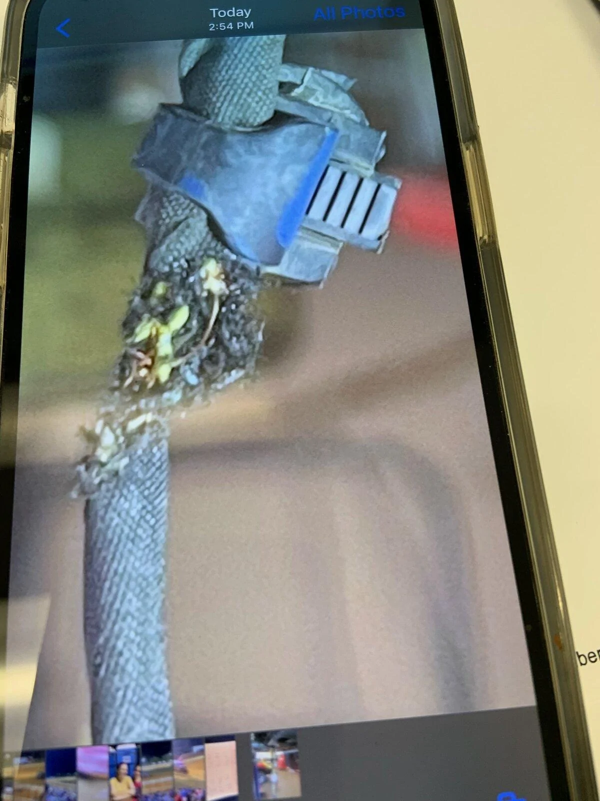

What scan program you running?
Pulled it off of the truck with Tazer.
Should have it back today, shop said "rodent" but it doesn't look like rodent to me from the .00003 megapixel image they sent.
Regardless there is wiring damage that seems to be the issue.
Please post the photo here as well.

That does indeed look like something chewed through it.
So we live in the woods and have had wires chewed before, specifically on a 2016 Ram 2500. The insulation on these things is soy based (somebody saving the world here needs to be hung by the neck but I digress).
In both of the prior cases they go to the exposed wire (past the sheathing) and chew the insulation that is exposed between the sheathing and the connector. This is quite evidently in the middle of the wire, and in an area that is sheathed, which is contradictory to prior experience.
