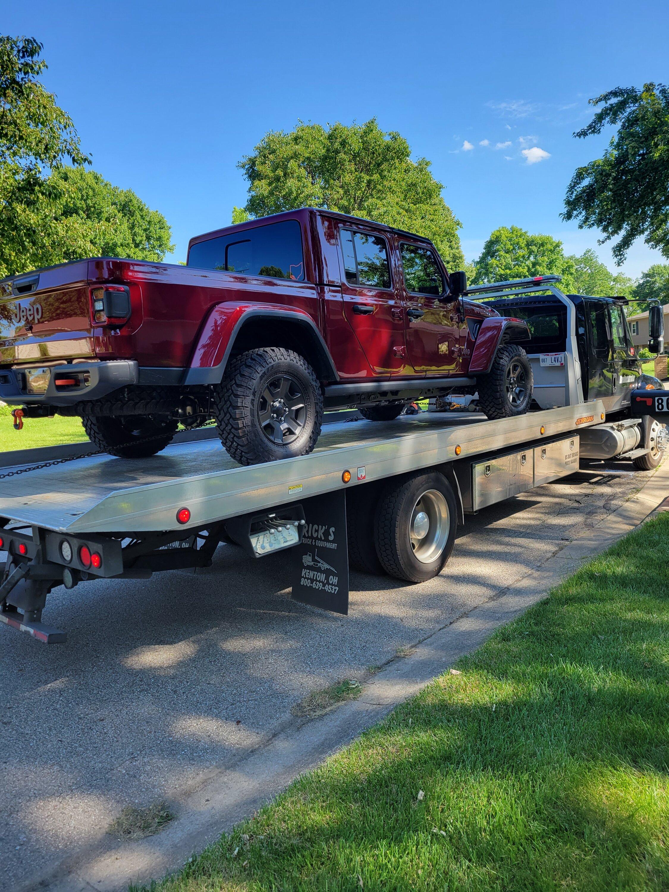

Well Gladiator came back Wednesday after second go round with camshaft/rockers and lifters. Today it decided to cover my driveway with its own fluids. Call dealership and told to call for a tow. It get better the dealership couldn't care less with a loaner. Called FCA and told to go get a rental. But none to be had. This Gladiator is the biggest POS I have ever owned.

God damn.
Gladiators don't shit fluids normally.
Your dealer employs morons who shouldn't be allowed to touch a wrench.
Have this bought back. It's clear the repairs were NEVER done correctly.
Second time for cam and lifters, and this time a mess-up on repairs (these are pretty leak-proof for the most part - leaks aren't common)
I'd bet you are past the criteria for lemon law.......
As far as "loaners" or "rental" - that's a big issue - shortages in many places. Dealers have had to sell their loaners to survive while they couldn't even get cars to sell, rental companies have cycled their their rental vehicles and can't get new - just like people here waiting since February for a new truck, it's a problem.
My son said his last flight the hardest part was trying to find a rental vehicle - no one had any.

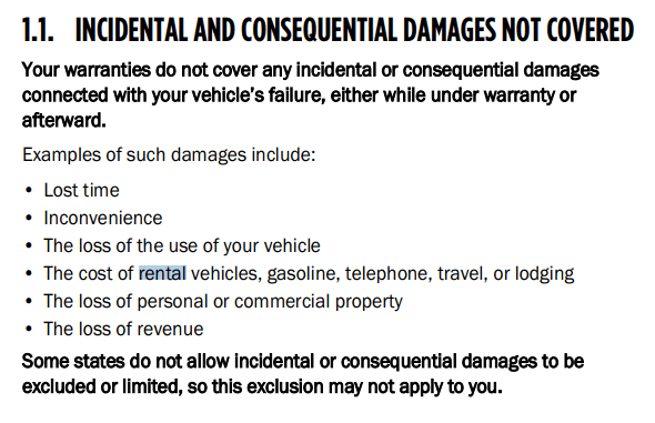

i had a conversation with my own dealer when i brought it in for the steering clunk. They said if no loaner was available and i would have to get my own. When i confronted them about the jeep extended warranty stating it covered the cost of loaners they straight up told me to deal with it. What garbage. a person pays extra cash for services to not be given.
My guess is that they'll cover the cost, you go get a rental, pay, and then they reimburse you.
But I'd call Jeep support to get that verified, or one of the people mentioned in the forums here who sell such warranties. They'll be more honest about what's covered or not, and how to get reimbursement for rentals if that's how it works.
I know in my case, where insurance covers a certain amount of road-side assistance on my wife's Jeep - you pay, send insurance a claim form with a copy of the invoice showing what you paid and that you did pay, and they cut you a check for that amount.
These days getting a loaner is not all that easy, and even rental companies are stretched thin in places.
This is from the standard warranty book -
Jeep Gladiator Anybody have a engine tick warm or cold ? 1655913334253
I don't have a copy of the "extended" optional warranties, likely those vary a bit anyway.
