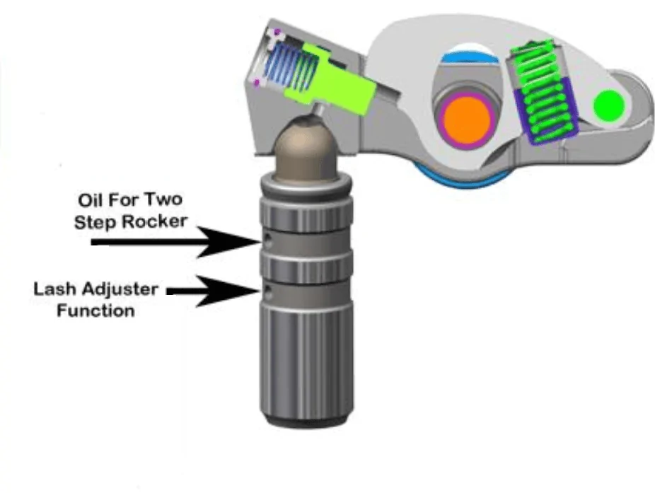

These things can tick when cold or be quiet as an electric motor in other cases. When I stand outside of one, I can sometimes here a slight tick tick, but inside, nothing. I generally don't pay a whole lot of attention to first few seconds ticks - but then - define the tick? To some it might be loud, others it's just a small thing.
I need to see if I can rig up JSCAN on mine and see if I can tell when the thing switches into high lift mode and when it comes back out, I'm wondering if it's in high lift for starting to get the full valve lift for initial intake air, then settles back to low lift mode?
If I'm correct (if) these high lift portions of the followers drag slightly over the center cam profile even when not engaged, thus the spring - and I wonder if there's some slap there going on. Otherwise, if these run in low lift mode 2800 rpm and below, why is the high lift part blowing up on these?
These engines start in high lift mode, because oil pressure is required to release the pin that locks the slider into high lift. Until oil pressure builds (about 11 psi if I remember correctly), the pin holds the slider in high lift mode. Also, the slider is held in contact with the high lift lobe of the cam even when the engine is running in low lift mode. This is what the larger spring is for, the small spring engages the high lift lock pin until oil pressure releases the pin.
250
40,606
54,302
That's been my assumption. Start in high lift, drop back to low lift.
The oil pressure in these climbs FAST. I've watched it. And these also start with the pump in high volume mode. So you are talking literally probably a count to 3 or 4 before the pump drops to low volume mode and the followers fall back to low lift.
I figured they needed to constantly follow the high lift profile so that when the pin locked them into high, it would be a seamless transition - quiet and smooth. Pressure retracts the lock pin against spring pressure. That makes me wonder if some of the ticking we might hear is all of those parts in action - following a cam profile held against the cam only by that spring holding that finger out, possible slapping.

Sounds like a lifter/lash adjuster that’s not fully expanding on start. Irritating, but I wouldn’t worry about it unless it got much worse.
