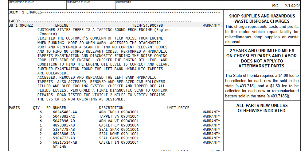

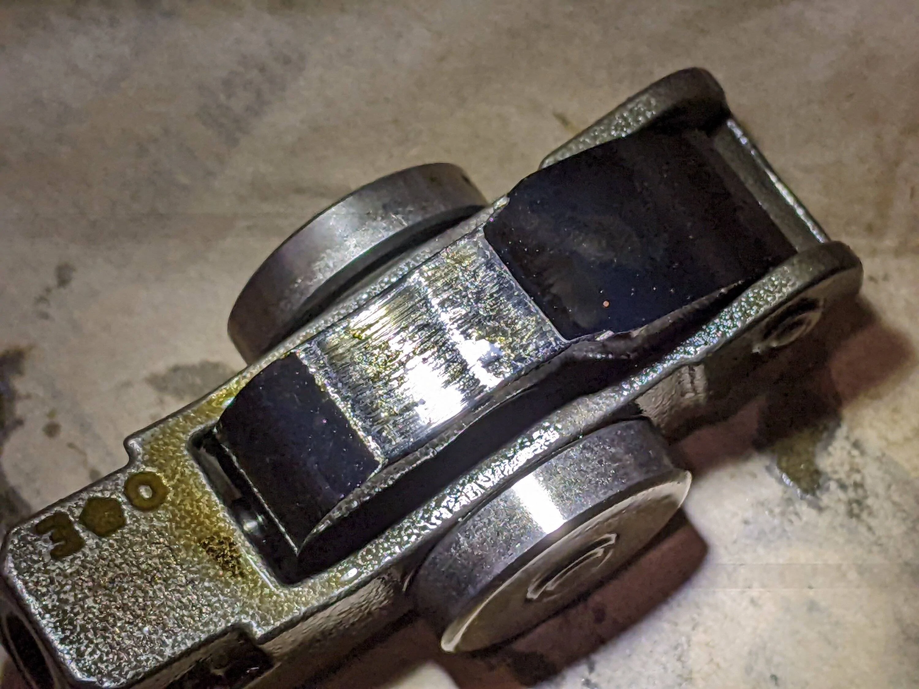

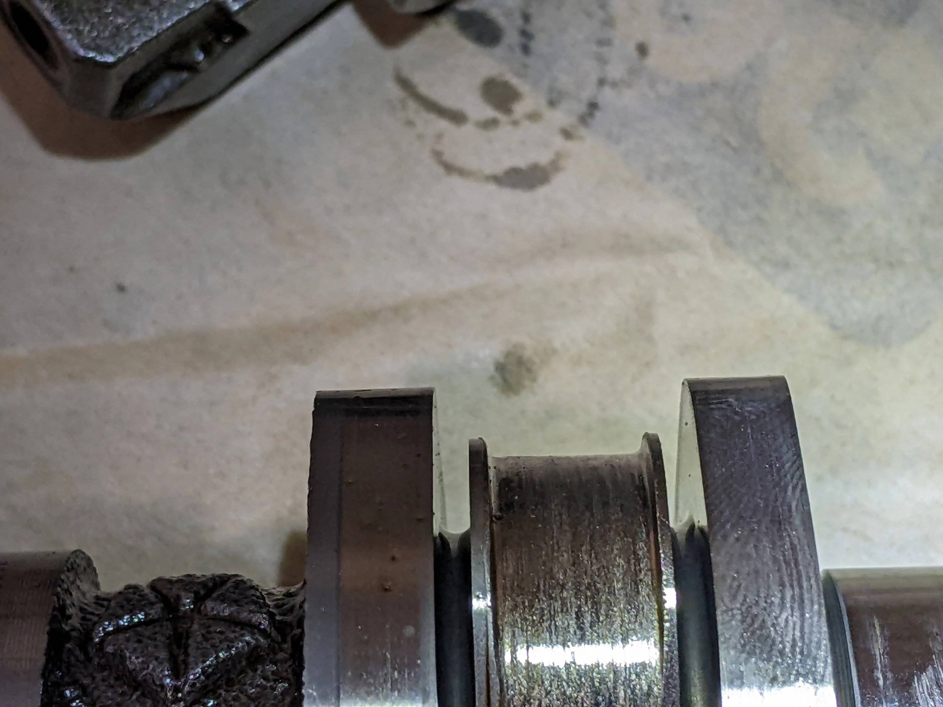

I received the call to come pick up the truck! Below is a description of work performed. I will pick it up within the next day or so. I am no mechanic by any means and looking for some input as to what was done. I consider myself lucky as I really like my service writer and shop foreman at the dealer. Love this forum and all who participate ?. The education has been priceless.
Jeep Gladiator Engine tick repair, to wait or not to wait? 1710774029427-ke
250
40,616
54,301
There's a TSB for this very thing - and Jeep suggests replacing lash adjusters (they are calling tappets here) due to a ticking sound.
The TSB says to replace all lash adjusters on the side the tick is coming from.
It almost looks like they were aware of that TSB and follows the procedures, but didn't mention it so maybe it was like "hey, I've seen this before" sort of thing.
Gee, they even performed checks/scans like they should.
