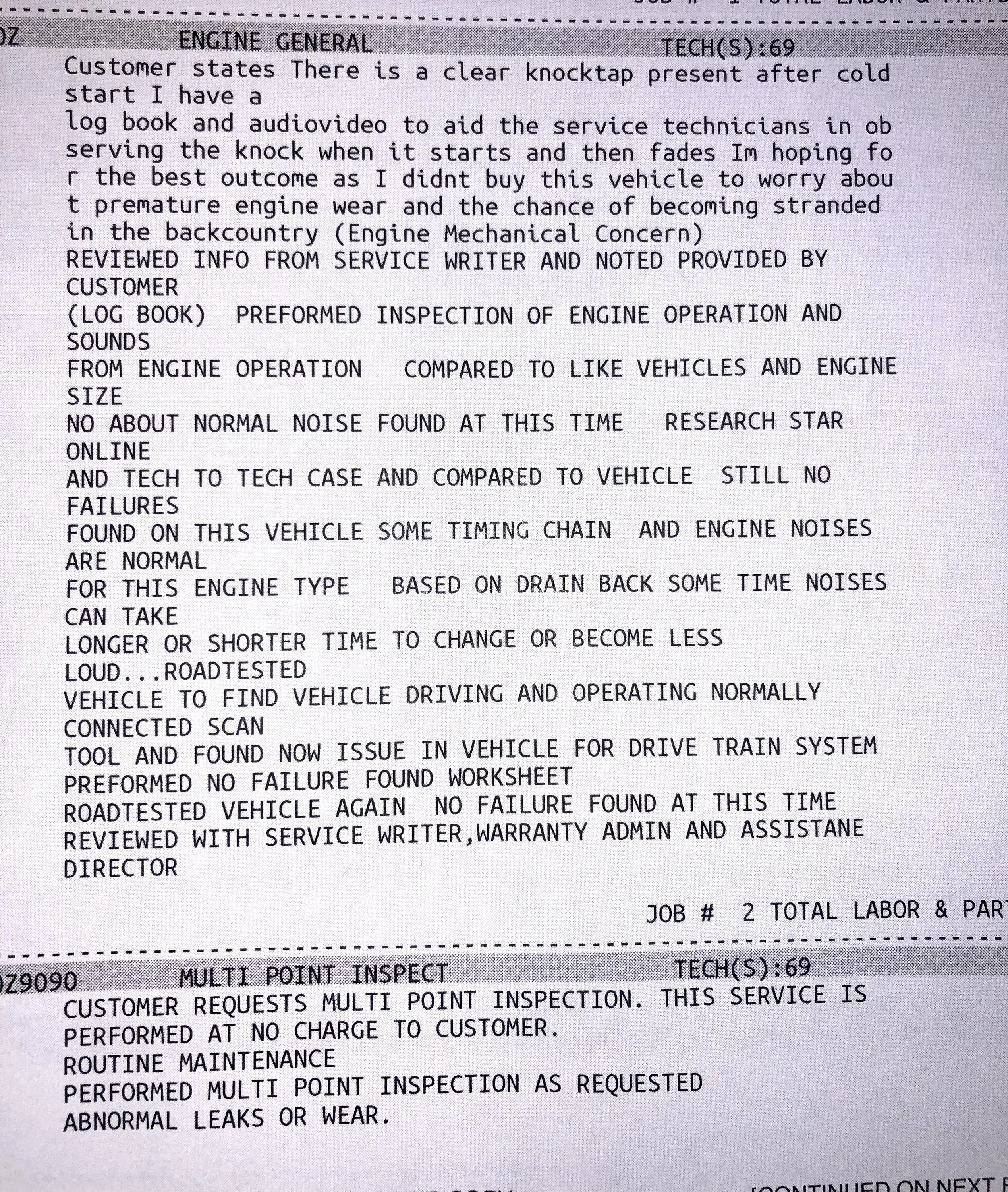

The local dealership determined that my Sport S with 7k miles was operating normally at the time of inspection. They noted some timing chain and engine noise is typical. They also stated that based on drain back some “noises” can take longer or shorter to change and become less loud. Overall, I’m satisfied for now. However, I suspect the warm weather will take up some of the slop (expansion) causing our knocking and tapping symptoms. The recent near 100 degree temps here in CA have made the knock nearly impossible to distinguish over the last few days. I provided the service advisor with a similar video as posted here:
Drain back on what? If they are talking oil, why would that have any impact on sounds?
Within a second or two of starting, there's oil to all systems. It doesn't take minutes.
Due to expansion, some sounds like piston slap and so on can quiet as things warm up - even some valve train sounds can seem less but drain back?

@ShadowsPapa
Literally in my service paperwork:
The sounds from a freshly started engine (cold start) disappear within seconds of oil pressure building. The lash adjusters pump up and take out valve train sounds.
IMO, anything beyond 10 seconds is not from lack of oiling or "drain back" (which is likely how they are describing the oil galleries being not charged from sitting, waiting for the oil pump to turn on the faucet, so to speak)
If I recall my FCA docs on these, the oil filter doesn't actually "drain" like many until you take things loose to change it.
Years ago some literally emptied the filter over a day or two and valve clatter was scary for a while.
