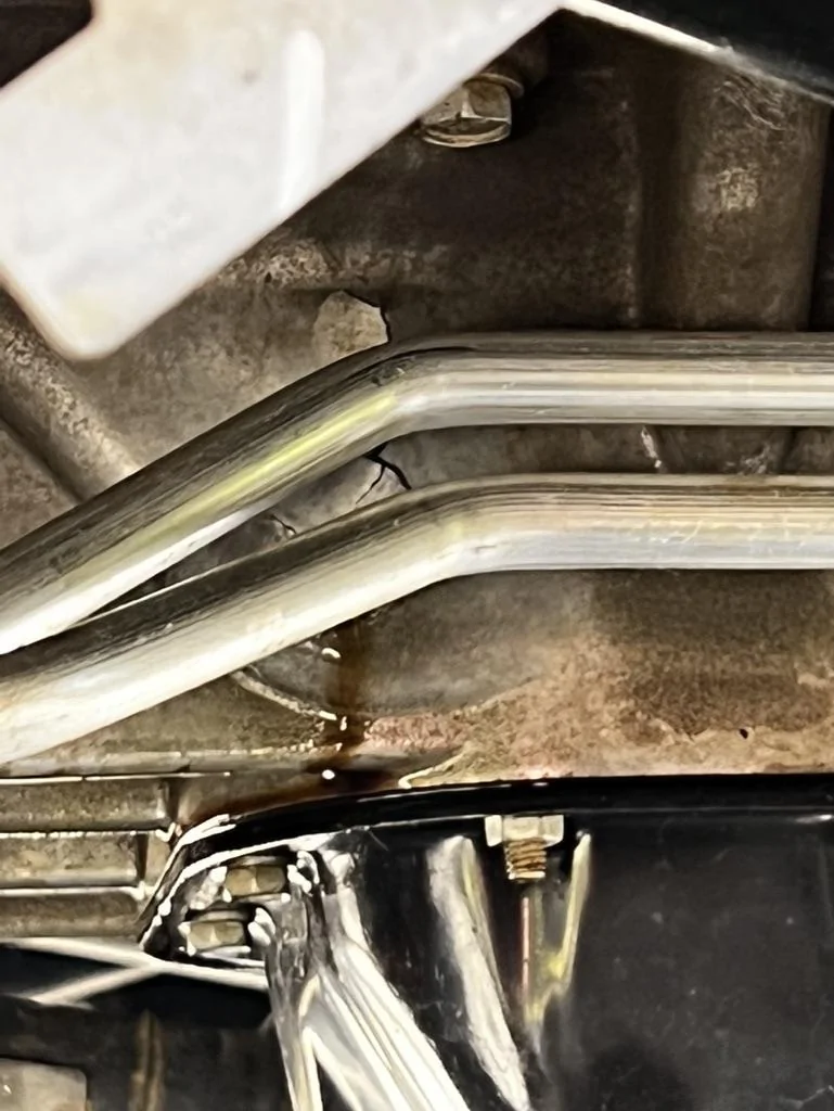

Mine used to sound like a Diesel at idle too, was told its normal. 19k miles on the clock and 200 miles from home this happened....
40,483
53,970
That's a very different sound from a tick.
That's the result of a knock. That baby tossed some parts - hard.
I can handle slight ticks, but if I ever heard a knock, I'd be knocking on the dealer's door and insist they keep it until diagnosed and repaired. The goofy thing is that there are tricks to diagnosing lower end knocks and sounds. I guess they go to school to read their smart plug-in tools, and not to learn how engines work inside, and troubleshooting sounds that don't belong.
Depending on load, acceleration vs. deceleration, and other factors, you can figure if it's rod or main bearing with a few simple tests.
Mains also have a deeper sound than rods and the sound will change with load. Rod knock sounds typically are there as quick as the engine starts and don't get better as it warms, may sound worse due to the thinning oil. By the time there's play in the bearing, it's like a hammer on the oil film.

Fortunately the dealer is replacing the engine, but I am assuming that the ticking in the head ( diesel sound) led to the premature wearing of something rather important which then found its way into the cylinder.... In turn causing the rod to try to escape through the engine block. Was also told that a manifold needs to be replaced with the motor. They didn't specify intake or exhaust, but if exhaust I am assuming that some of the chunky bits made it out there as well.
