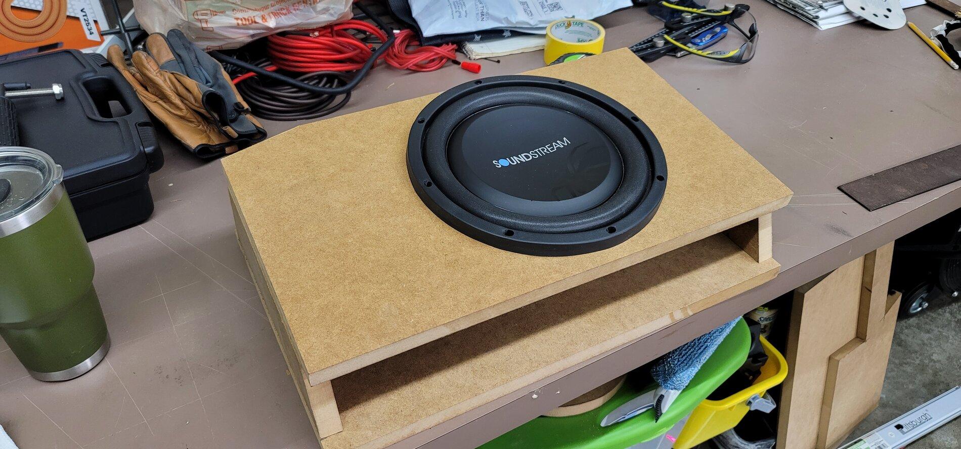

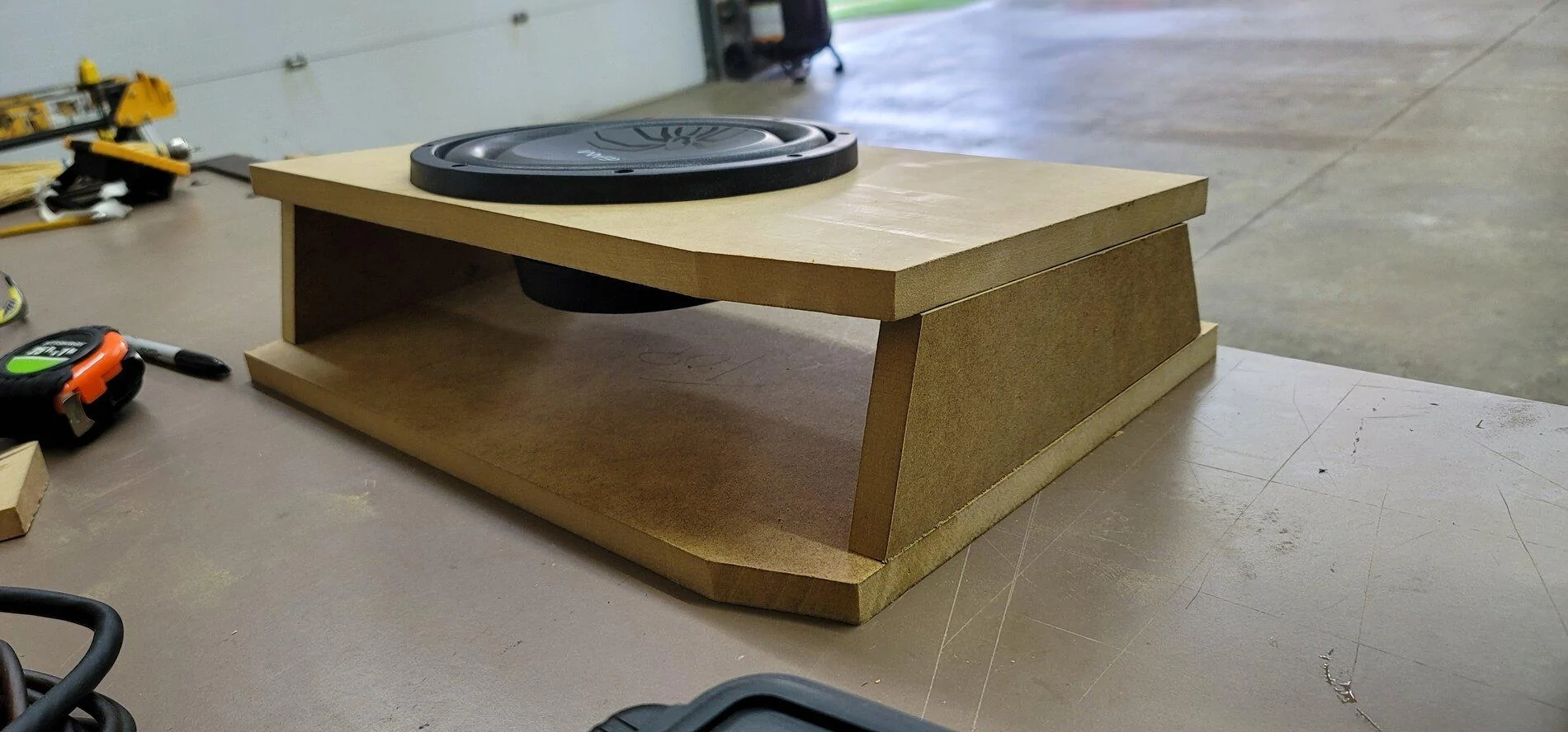

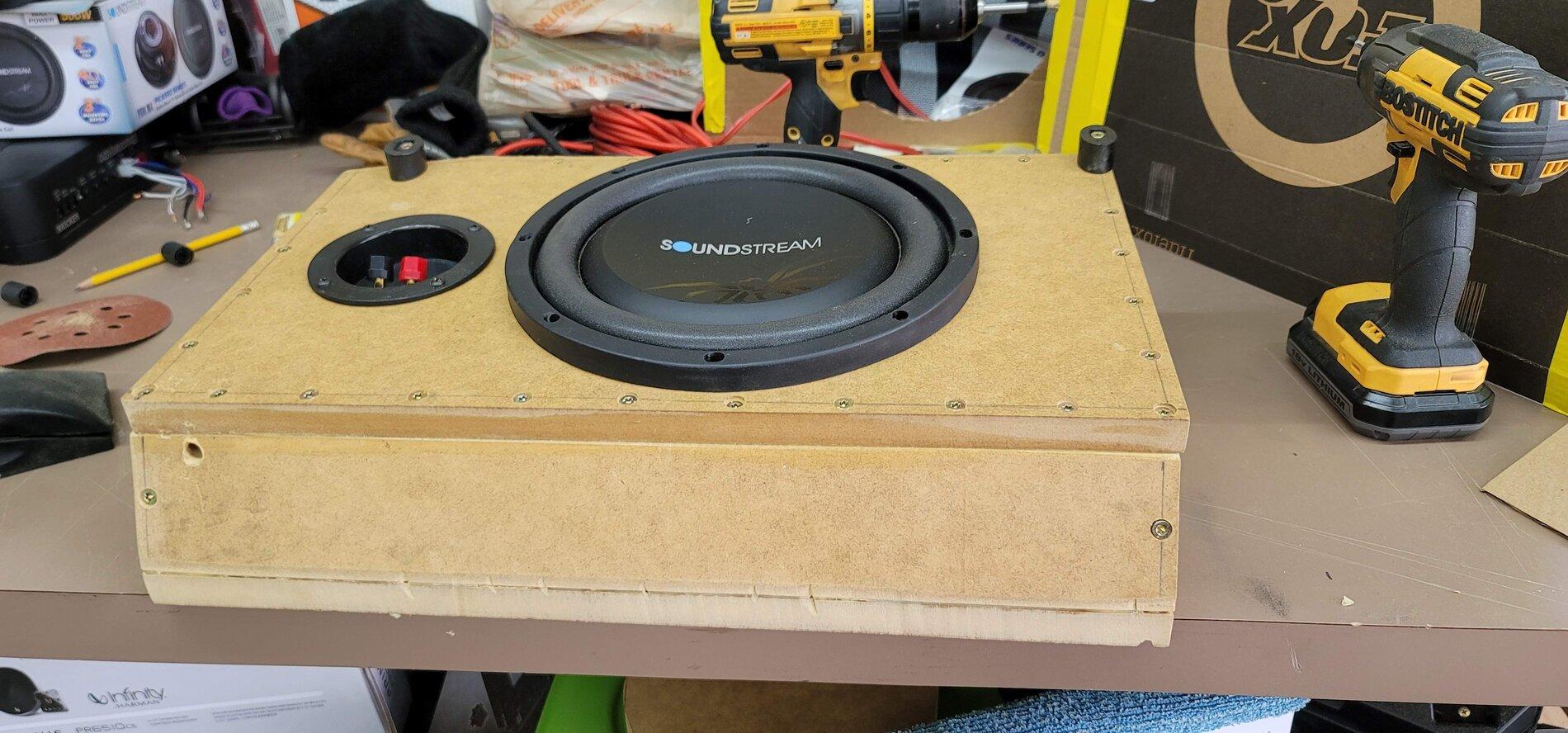

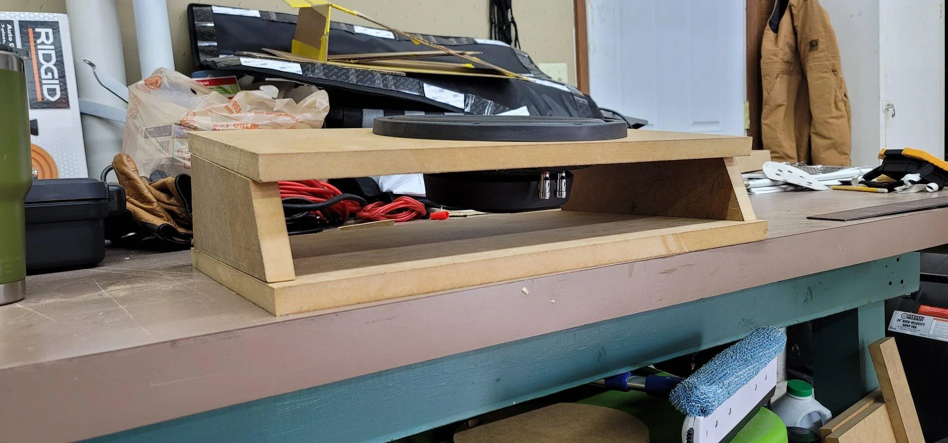

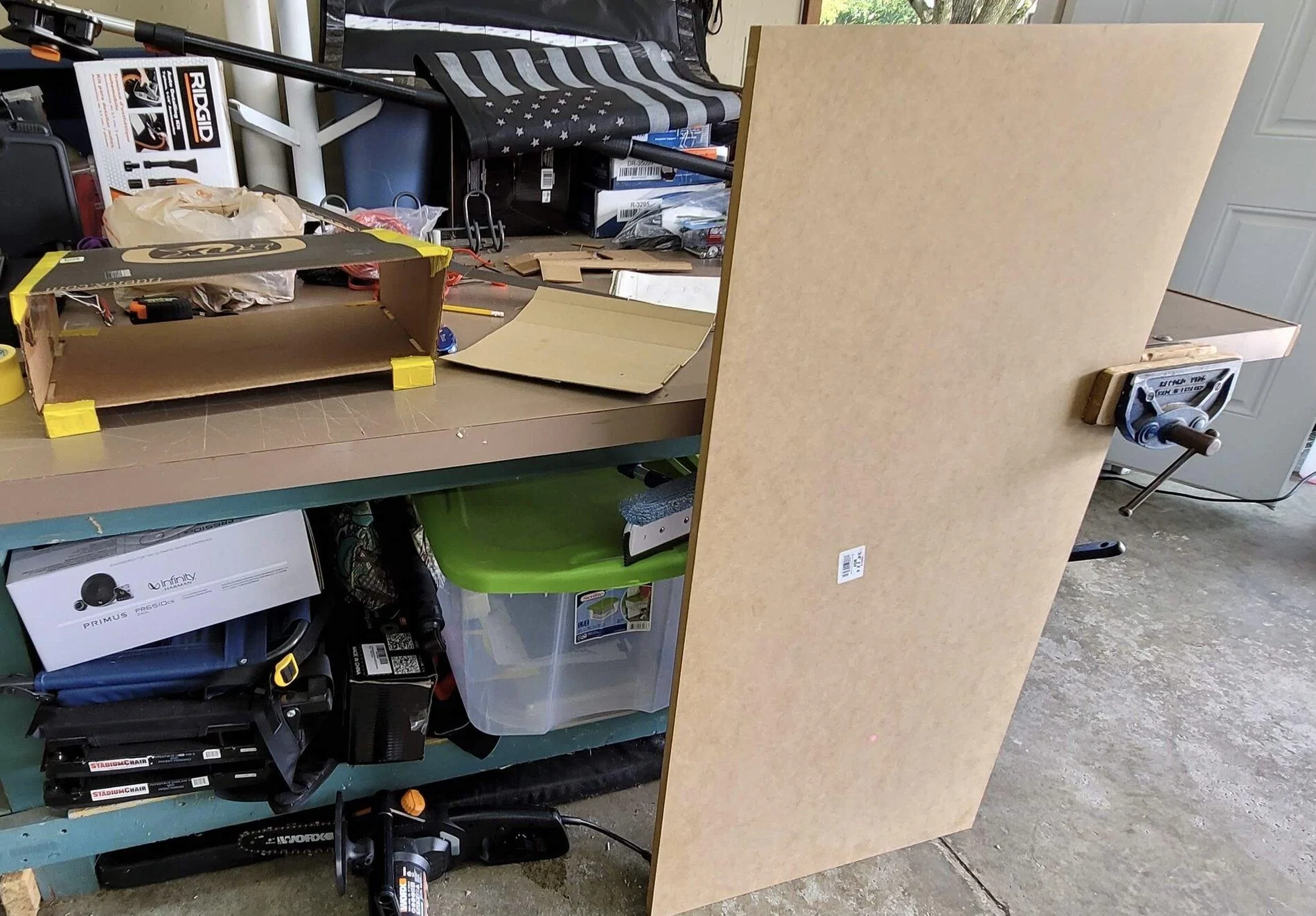

Here is my progress so far, it's coming along nicely considering I haven't built a sub box in like 15 years ?

I hope that I can get it finished up this weekend. I am taking my time getting it just right. I threw the board with the sub mounted in it under the seat and it sounds pretty good even with no box so I can't imagine what it will sound like in the box LOL

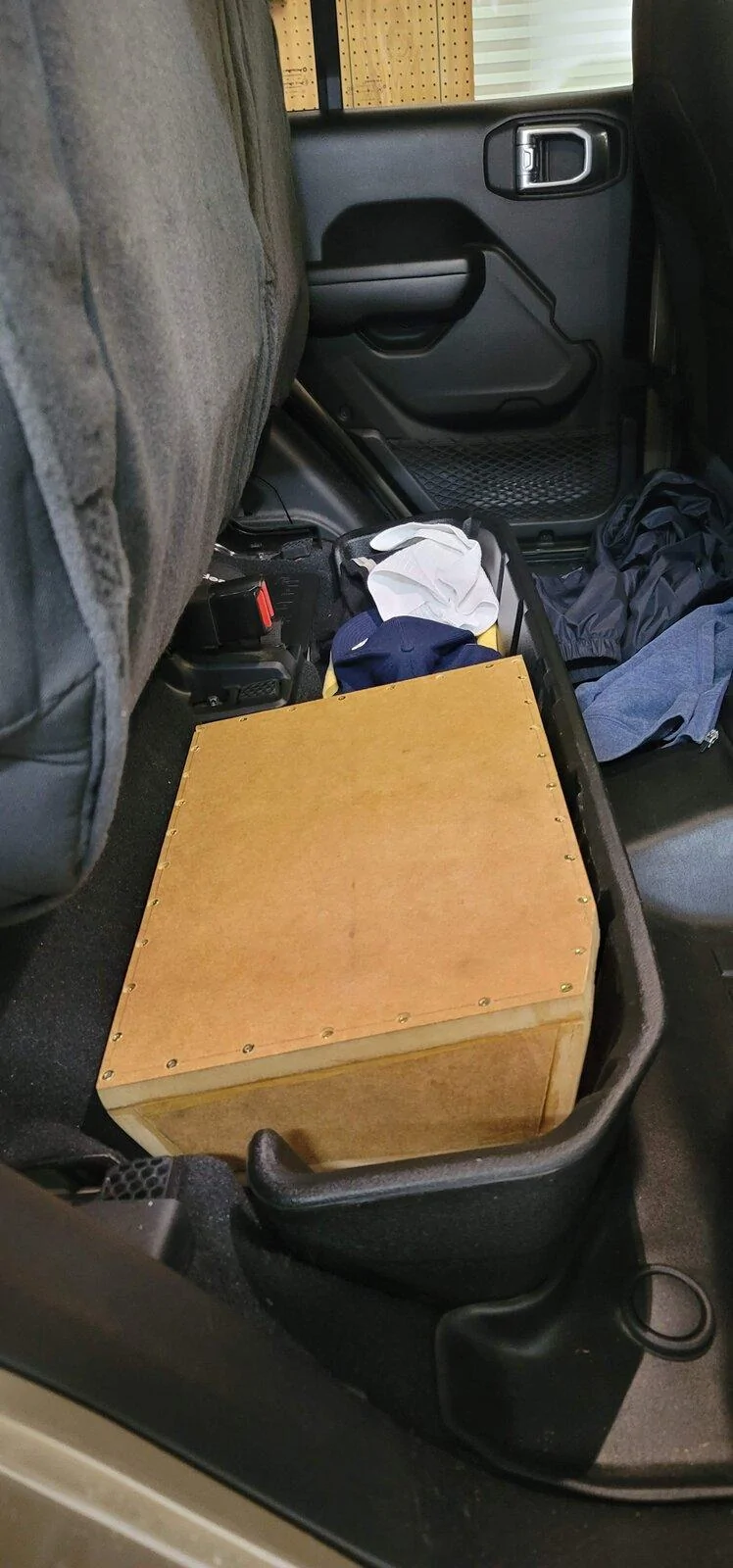

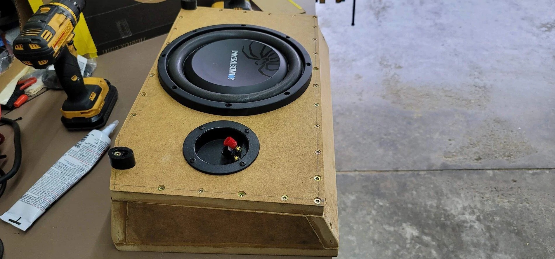

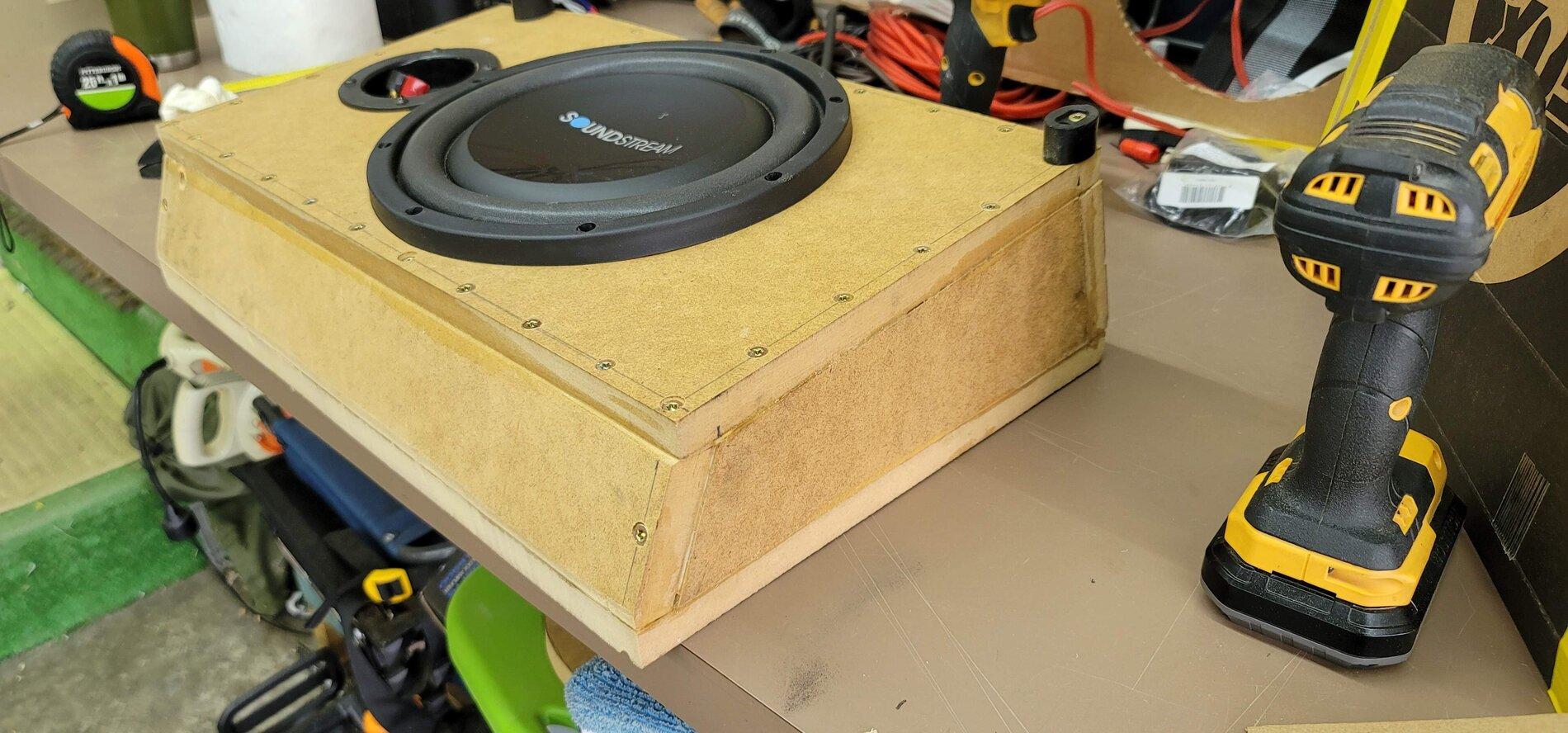

Not “Done” but its pretty close now, all the damn angles were a pain to get it all lined up. I glued and screwed it together, probably used way too many screws :LOL: and I also calked the seams from the inside. I’m going to clean up the edges and then I’m thinking I’m going to hit it with bedliner. It sounds so good, much better than I was expecting!

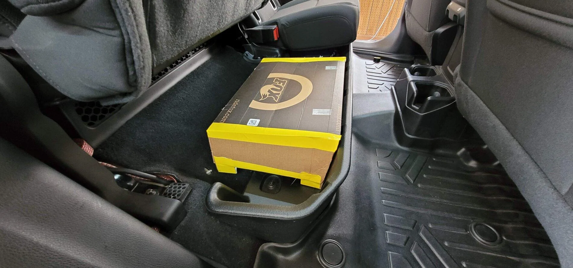

i went with the Fox acoustic box ported for a single ten. with the Skar Audio VD10 and their 5 channel amp. all the bass i need and more than i expected you will not be disappointed, i have used Fox boxes in my ram and wrangler also. they make a nice box.
are you still liking your box? What was the internal air space on it?

Love it, all the bass I could ask for! Still haven’t done anything with paint or carpet yet. My best guess is .5 cuft but it could be a little less. I added extra angles to it to try and get some more air space.
