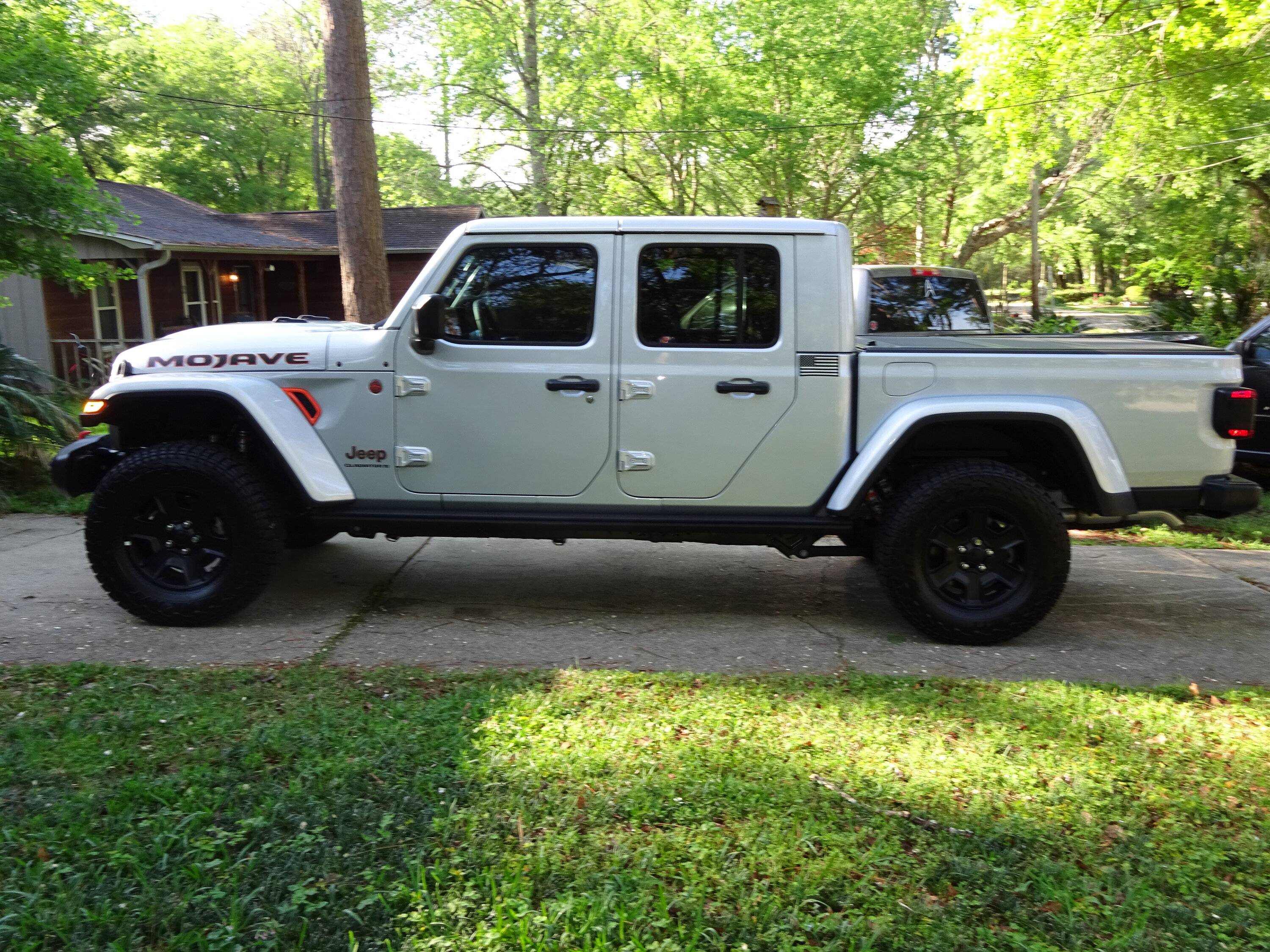

Well, dealer can't see it for about 2 weeks as they are booked up.
The not starting is getting worse and is 9 out of 10 starts. The only thing I can do when this happens is hit the start button again to get it to stop cranking then hit the button again. It always starts immediately on second try. No codes.
The stop feature works ocasionally but really no concern as I have trained myself to turn it off every time after it starts.
Well I have 2 weeks so I am just going to check connections and keep messing with it, maby I will get lucky. I did push down all the fuses and charged the batteries. Really a shame because everything else is just perfect. If any of yall think of something to check please let me know.
I have aux switches, CAI, and cat back
exhaust to install but do not want to until after the dealer sees it. No doubt they would blame it on the intake or switches.
Thanks for your time,
