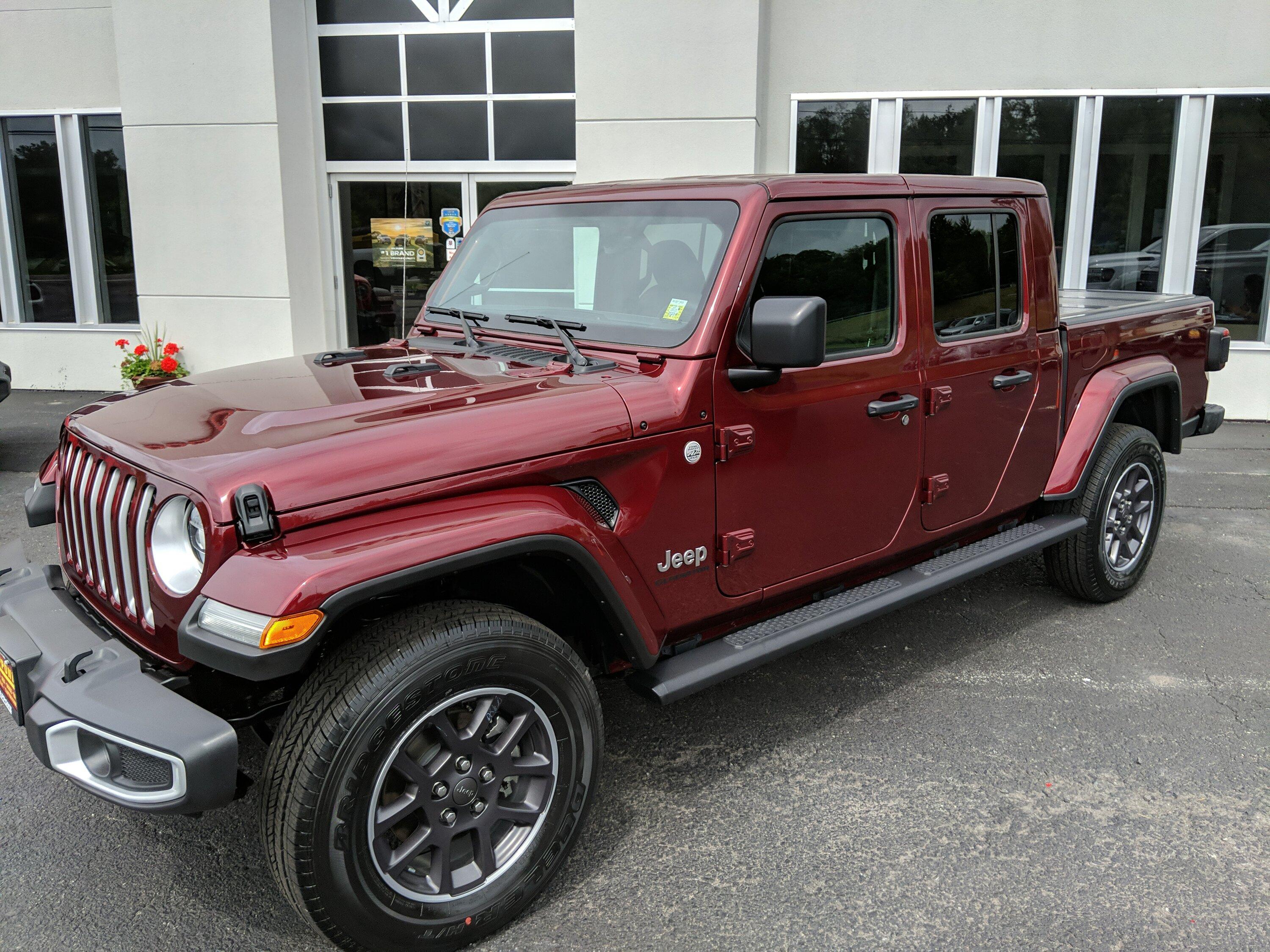

Traded in my 2020 Sport S Max Tow today, with just over three years behind the wheel.
Picked up a 2022 Overland in snazzberry.
I can -finally- stop regretting not having the proximity unlock function :)
Absolutely great looking Snazzbery Overland! Get ready for many, many compliments on that color choice! :like:
I am officially envious. When I ordered May 2nd, snazzberry was removed from the order screen, Could not order it in may. I asked him to look again and he sent me pictures of the order screens - it simply wasn't even there.
The outside temps showing on the system in their on-the-lot pictures made me think that this truck had been onhand since maybe April? The dealership is a bit out-of-the-way... Might have been the only snazberry Overland I saw locally available...
