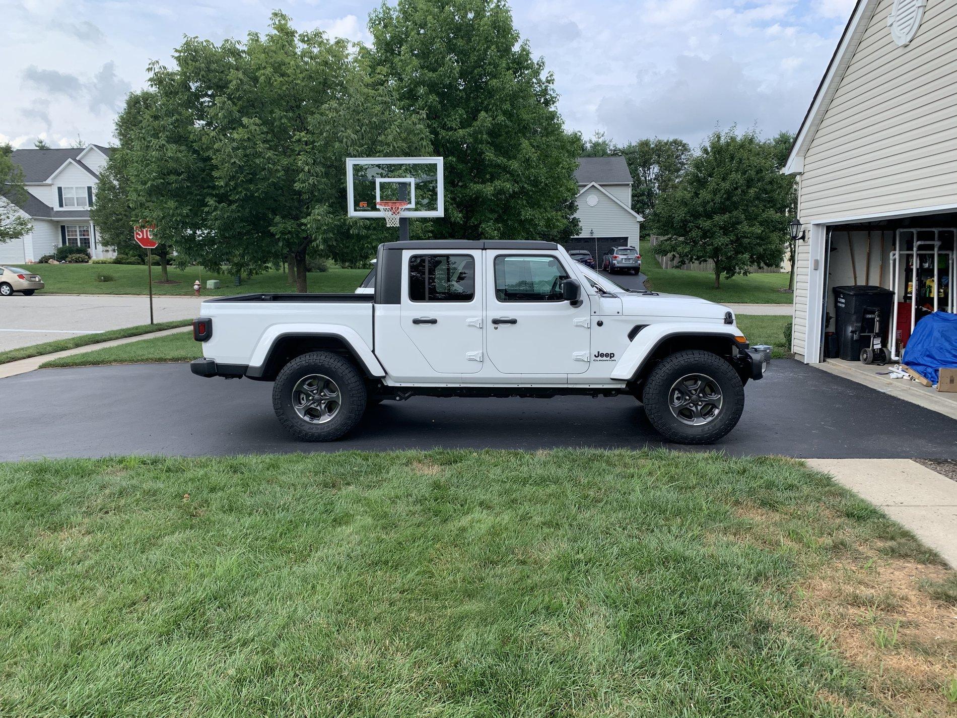

I have the 315s on my sport S on the stock rubicon wheels and really like the look. I haven’t done any off roading but I’ve had no rubbing. I have the 1.5 inch daystar level on it as well
Jeep Gladiator Upgrading tires after Rubicon suspension - Stuck on best fit:  285/75, 305/70, or 315/70? D26333CE-85C4-4BAA-A5A6-FFD89C39D33B

What did you get height wise when you put the rubicon suspension on? I’m very interested in doing that but it all gets very confusing when I start thinking about using the rubicon suspension with the 1.5 daystar spacer. The rubicon has less rake correct? Some say rubicon suspension plus 3/4 spacer in front levels it out but is that higher or lower than my 1.5 inch spacer on stock sport suspension?

@Ace310 I haven't installed the Rubi suspension yet. I've heard that it's anywhere from 3/4" to 1" but haven't heard that the front lifts higher. If that's the case, I might rethink the 1" and maybe go with the 1/2" spacer. I just don't want the "carolina squat" and I really only want to undo everything once.
Your tires look fantastic. That might put me in the 315/70 category. Is your 1.5" kit just in the front?

Thanks! I’m really happy with the look. Yeah the 1.5 is just in the front and it was super easy to install. Took me about 2.5 hours in my driveway with basic tools. I have about 1/4 inch rake still which I’m cool with. I also didn’t want the Carolina squat. I am interested in switching out the stock sport shocks with the fox shocks from the rubicon though as I hear the ride is much better.
