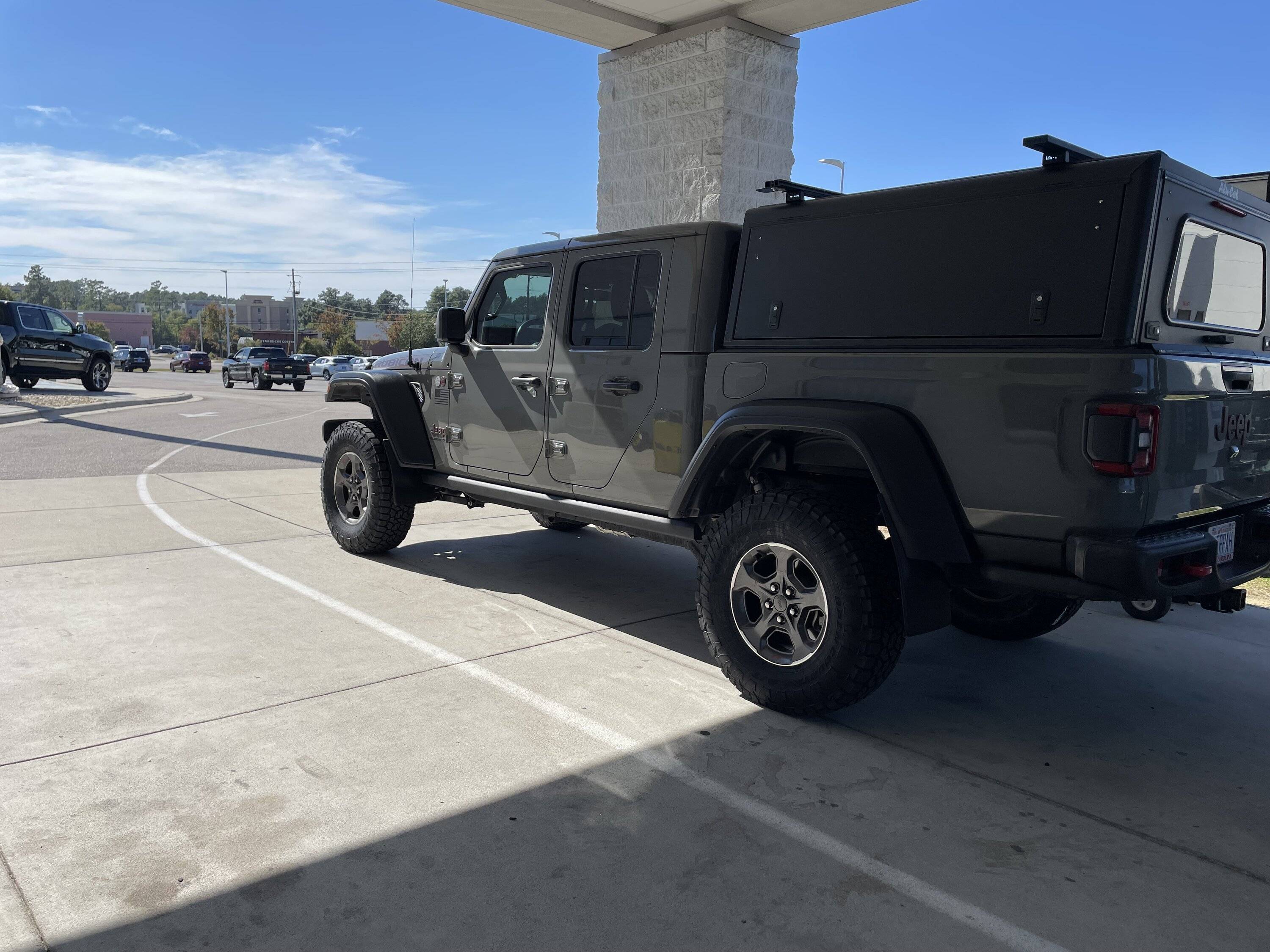

Have owned quite a few sets of KO2s, albeit they were all 32s or 33s. 2 months on the Toyos, and at least for me - I'd take the Toyos all day everyday. I just find them so much more comfortable and quiet. For the light off road stuff I do, I'm not lacking for anything.
As for tread width, the specs are on the website:
Toyo Open Country A/T III 35x11.5x17 (what I went to) = 9"
Toyo Open Country A/T III 35x12.5x17 = 9.8"
BFG KO2 315/70R17 = 9.9"
BFG KM3 285/70R17 (OEM I switched from) = 9.5"
