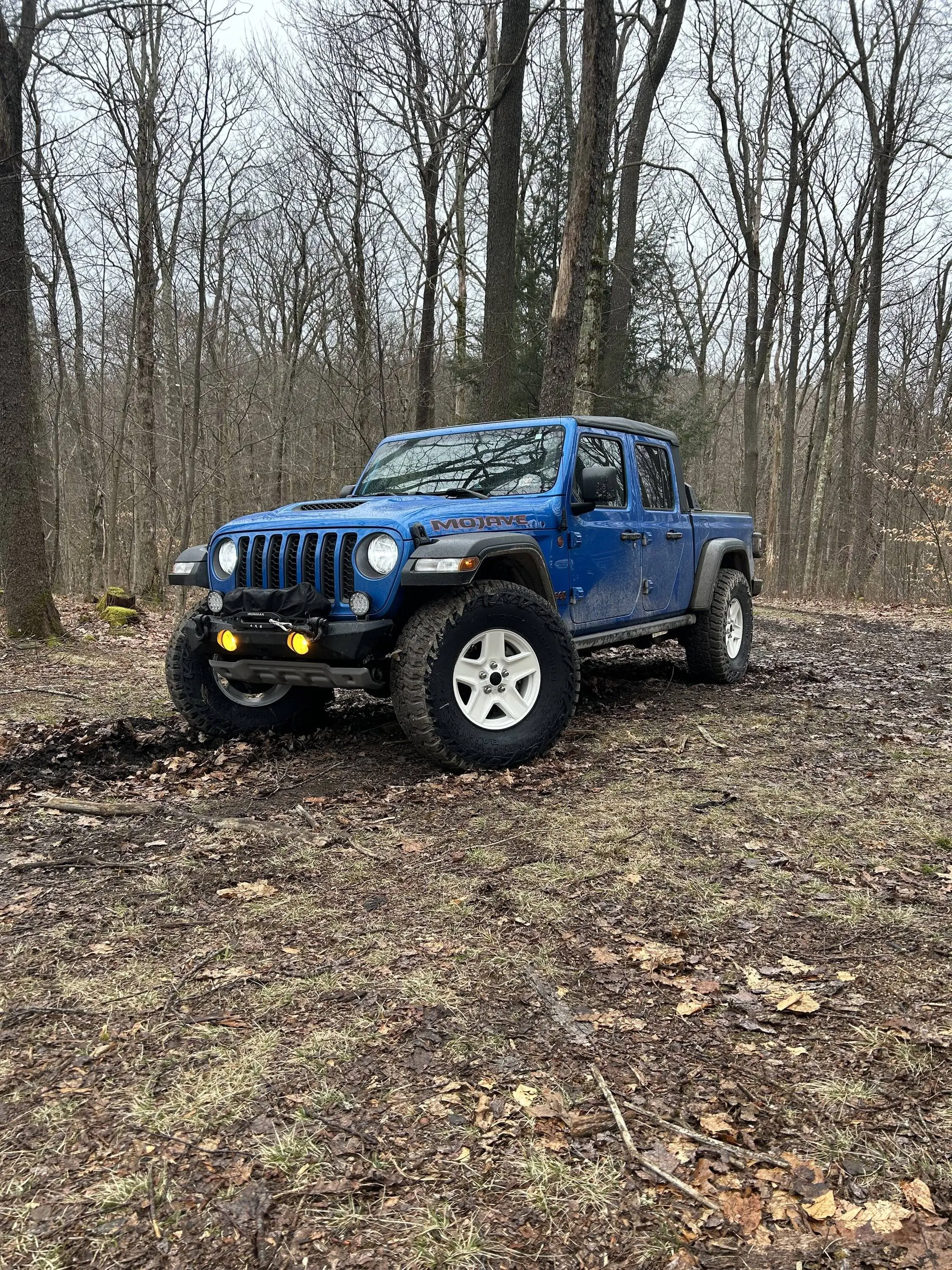

Here my jeep in stock wheels and 35x11.5 nittos. It disnt rub at all without a lift but I added a mopar lift with bilstein shocks. Jeep still feels peppy and mpgs didn’t suffer that much. Used to have a sport on 35x12.5 and 18 …. That thing was sluggish
I imagine that had more to do with the gearing, eh?
