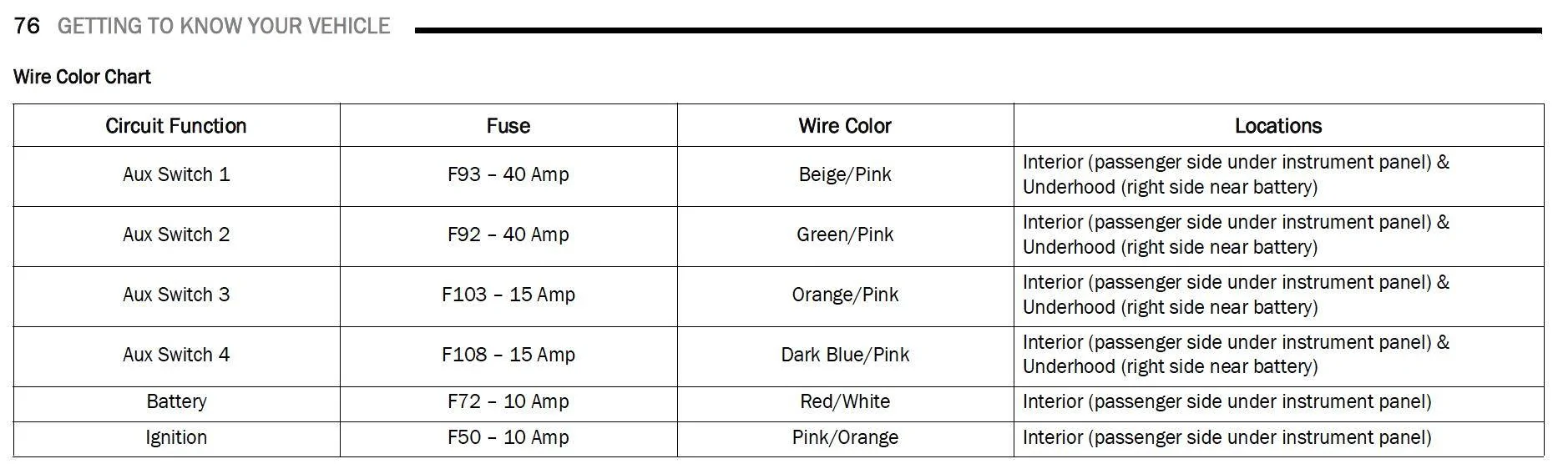

Your owners manual should have information like this:
Jeep Gladiator Using AUX to power Wolfbox 930 aux_wire_colors
