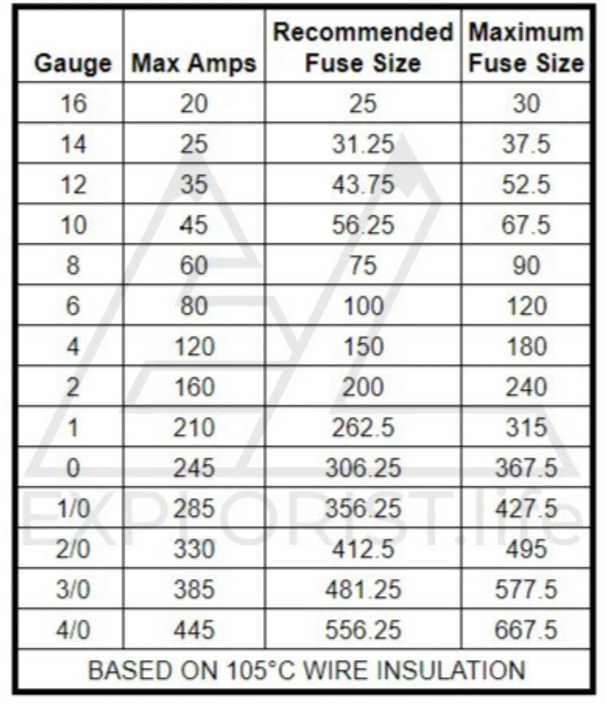

I would not be wiring an inverter if all you want to do is charge devices. Each conversion cycle erodes efficiency significantly. All devices charge batteries using DC and an inverter converts DC to AC and then the device charger will convert it back to DC with each cycle loosing significant power through heat. If you need the inverter anyway, buy one that offers USB ports also. The best of both worlds.
I’ve mentioned this before on this forum, But you always size the wire to the device and the fuse to the wire. The 40amp Aux switch uses a 40amp fuse and a 12ga wire, if you connect an 18ga wire to it, the wire will become the fuse as the fuse can handle way more amperage than an 18ga wire! That would be a failure and potential fire.
Below is a simple chart and while wire length also matterss, this will work for you. Since your chosen fuse is already set at 40amp, use a 12ga wire Which I hope is the red wire gauge that comes with the inverter.

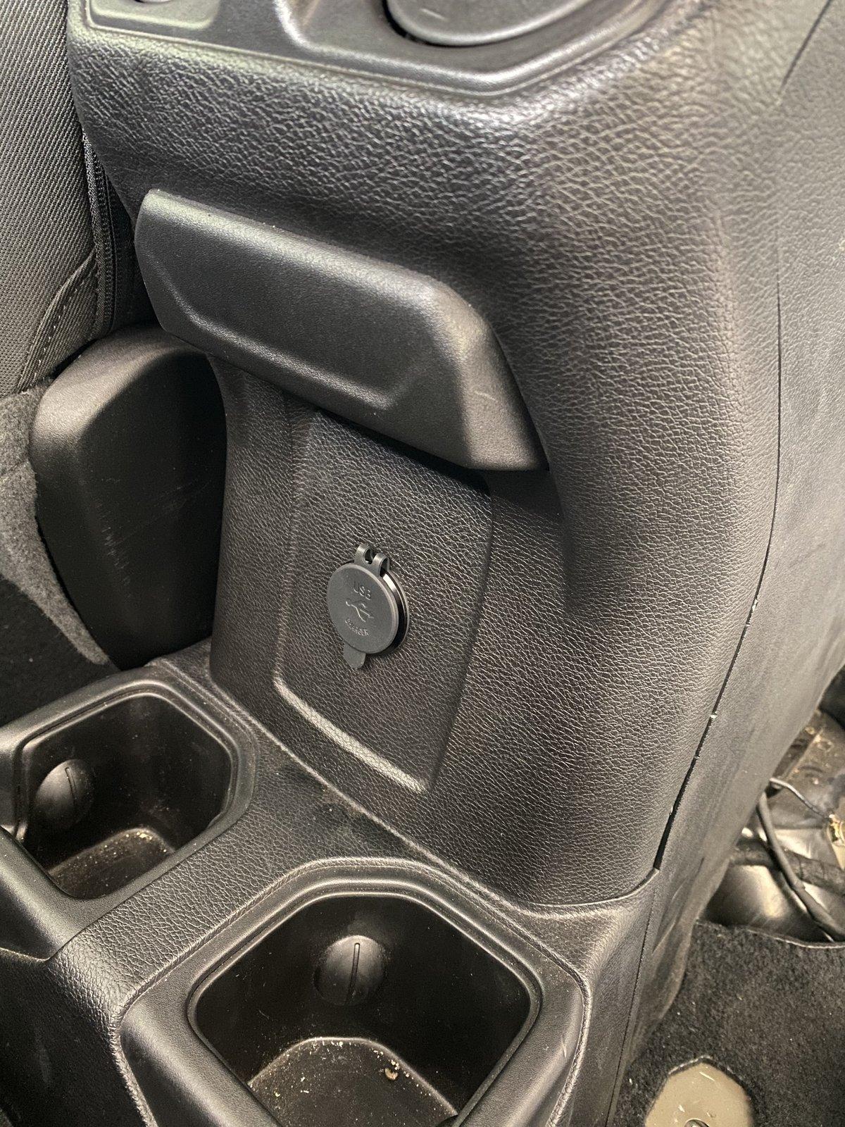

Thanks a bunch for the help. I decided to install a three port USB port in the back of the center console. It was super easy. I centered the port on the blank area of the rear facing center console, used a Dremel to get the port hole just right and mounted it. I ran the power for it to the wire bundle under the passenger side console ignition wire so it would be powered when the vehicle was on. I forewent the AUX switch option to leave those available for other accessories. I will keep the inverter for a future project later (110v option to power laptops, etc.).

Nicely done!
