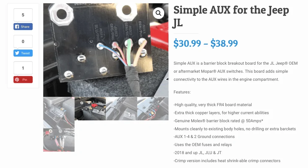

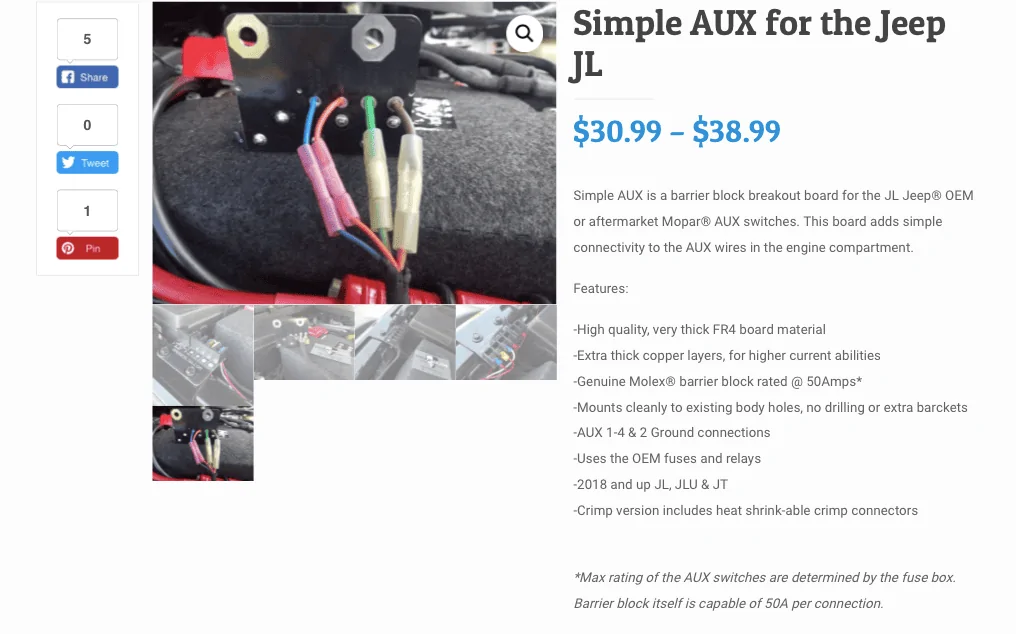

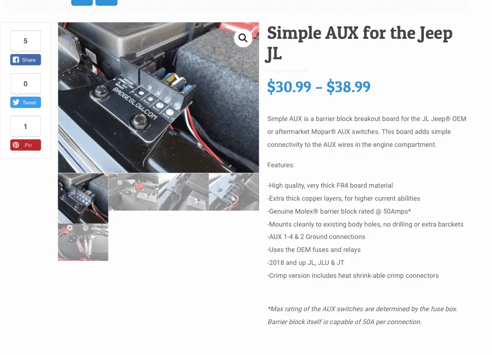

I found mine it the Glove compartment. However for a nice neat job I would consider something like this. Comes in two models soldered pigtails are on and connect to OEM wires with crimps, or you can solder the OEM leads directly on yourself.

Nice and neat. Now tell us where to get it. Tks
