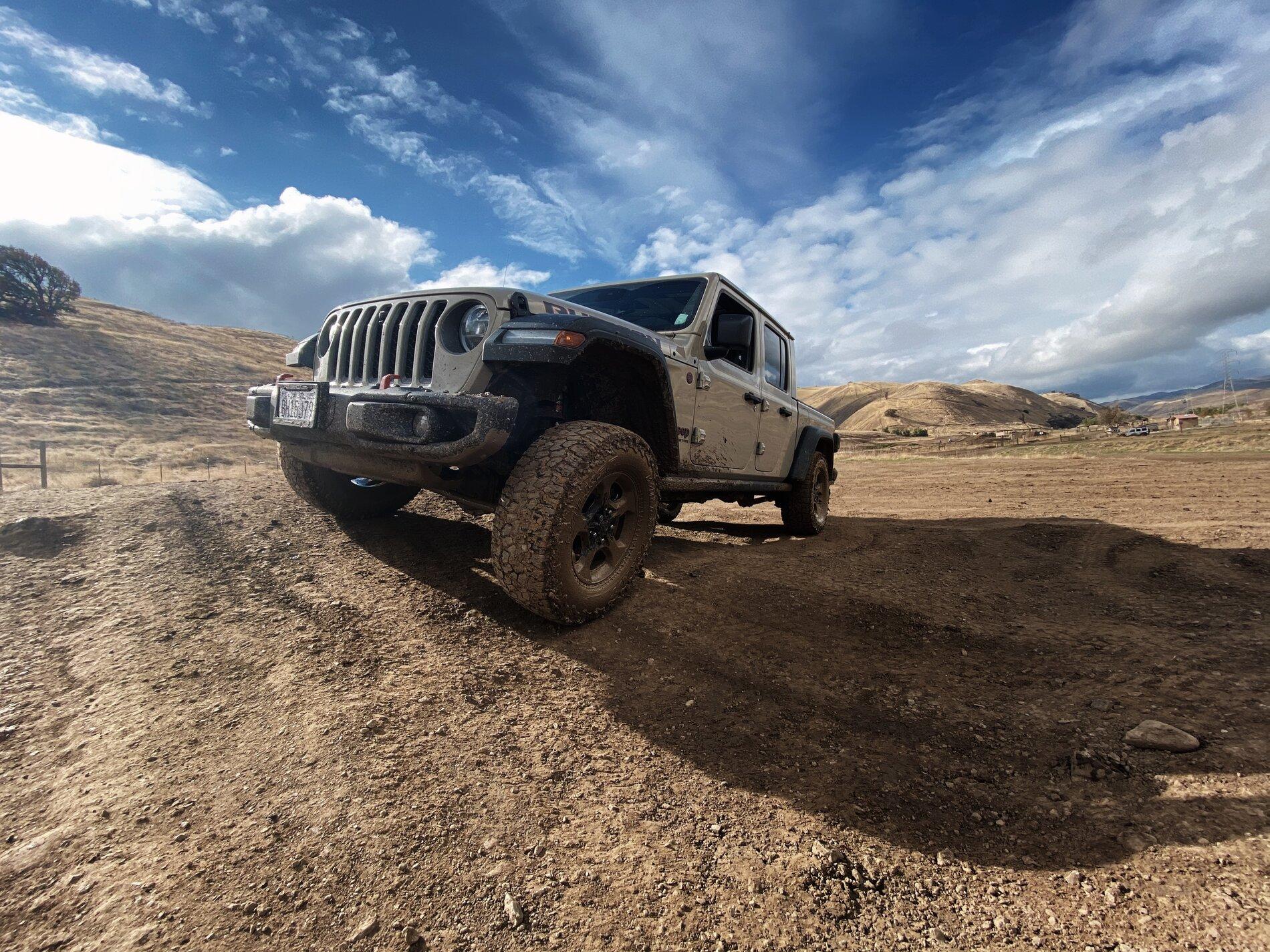

Updated on new teraflex suspension lift after my first 100miles. I installed the falcon 3.3 shocks and went 3.5” lift earlier this week. I contemplated getting all eight arms swapped over. But I decided on brackets over arms, as I’m not planning on taking trials that require a lot of crawling. The brackets that I chose were all from teraflex. 1. Front lower and upper control arm brackets 2. front and rear track bar brackets.
I’m happy with them. The caster in the alignment report is at 4.6 and the ride of the truck feels like a massive improvement from the stock rubicon. (I’m sure the extra volume in the tires help improve the ride quality as well)
Next up for the suspension mods is to do research on how to keep the rear from sagging with a permenant 500lb load in the bed.
I’m thinking I may need a rear spacer or airbags to help support the DIY drawer system, 75L fridge, lithium battery and topped off with a super pacific camper bed.
