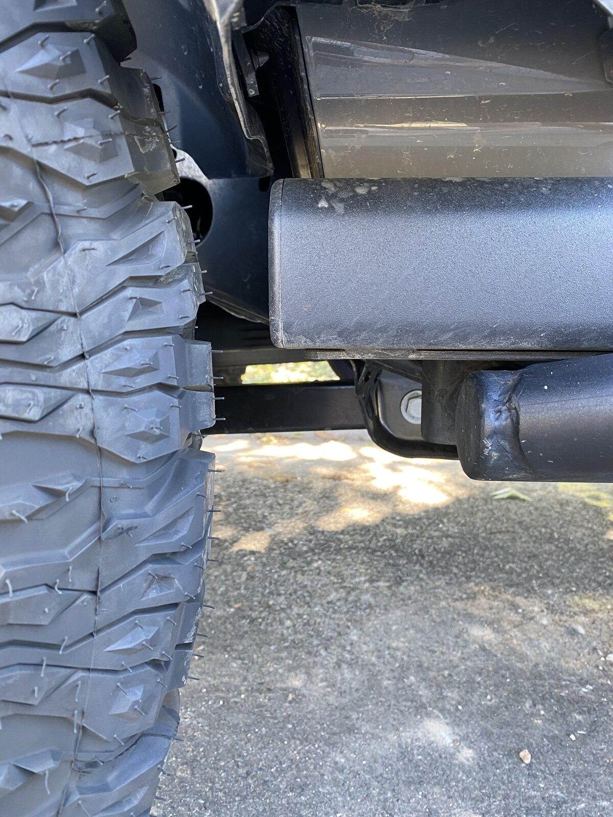

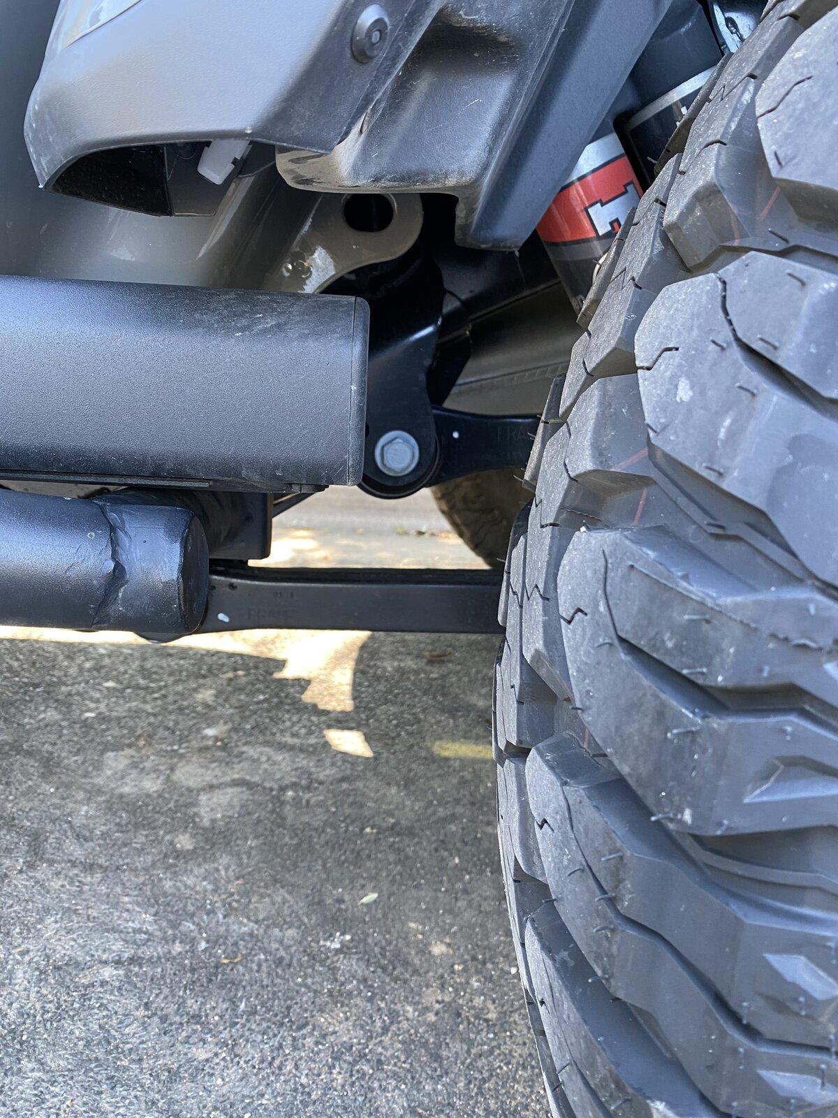

After installing the ACE rock rails for protection, I think I need to get rid of the stock sliders.
38’s are way too close, this won’t last off-road.

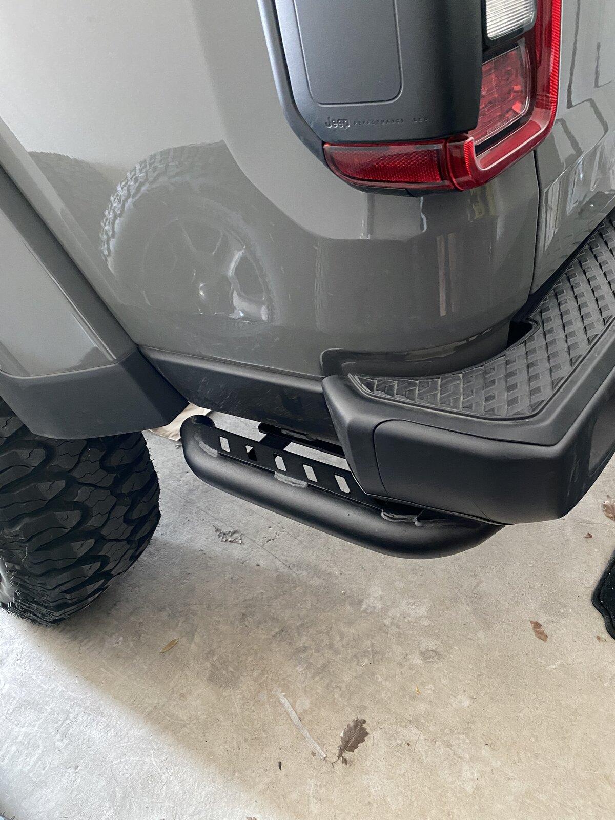

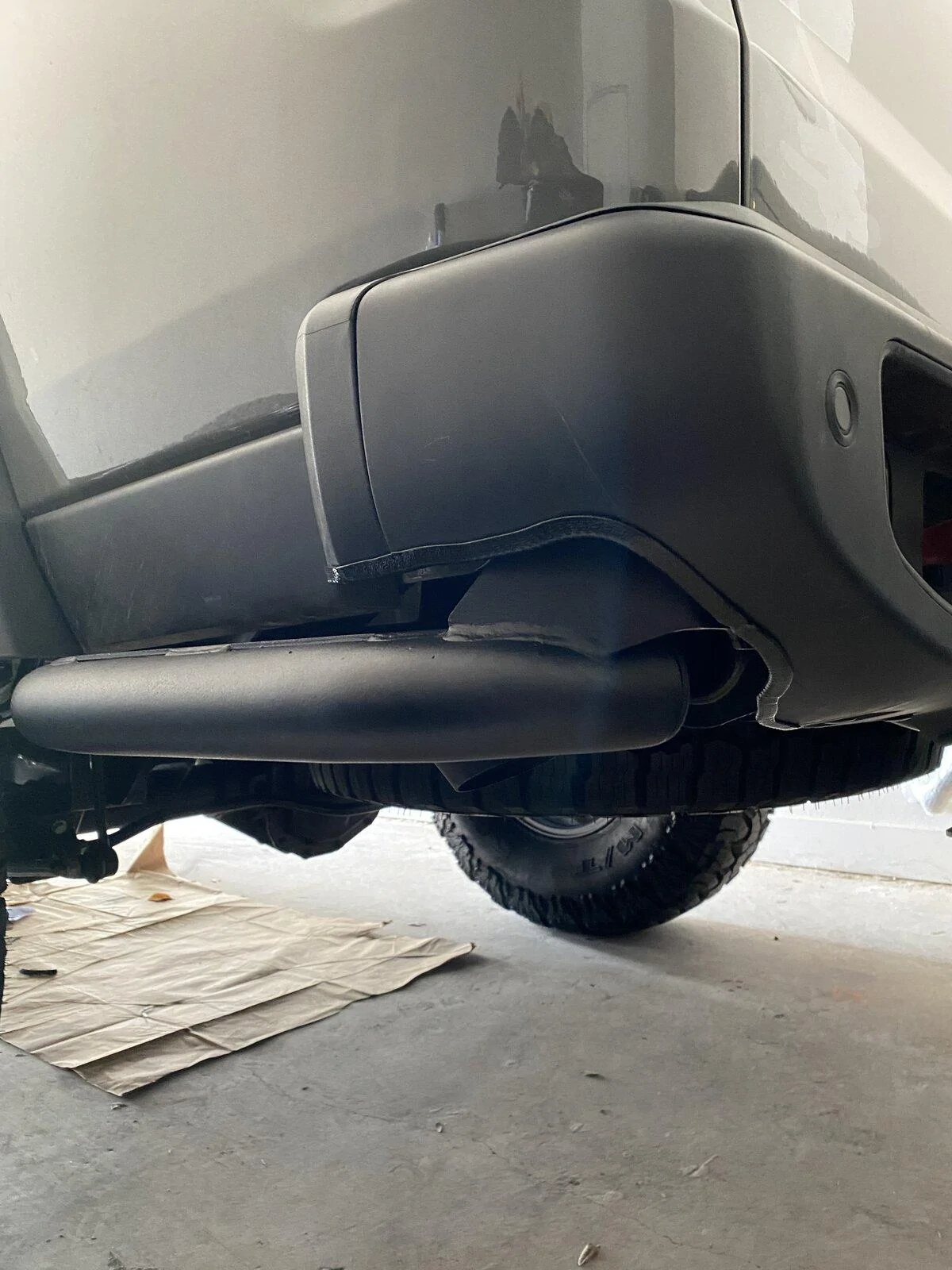

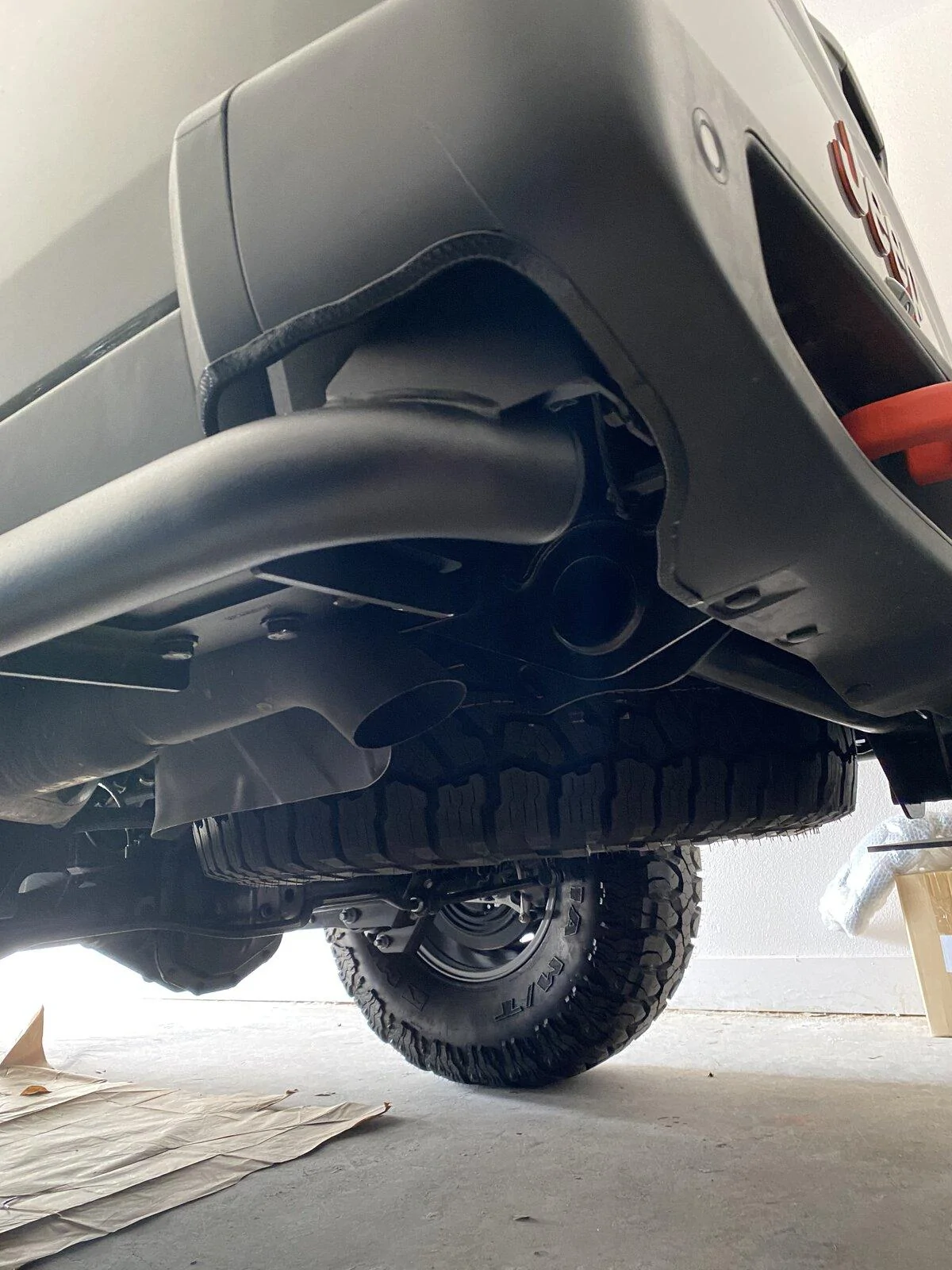

Installed the Red Rock Bedside sliders last night.
Easily worth the $200 but install is a pain in the ass, had to cut the Mojave bumper and there is little room for error if you’re using a razor.
Ended up scratching some of the bumper with the razor where there is no cut, but it’s solidified my decision to find a steel bumper which is something I’ve been looking to add to the list anyways.
I’ll have to make sure I can keep these with a more slim line steel rear bumper for best departure angle vs big and bulky that wraps all the way around.

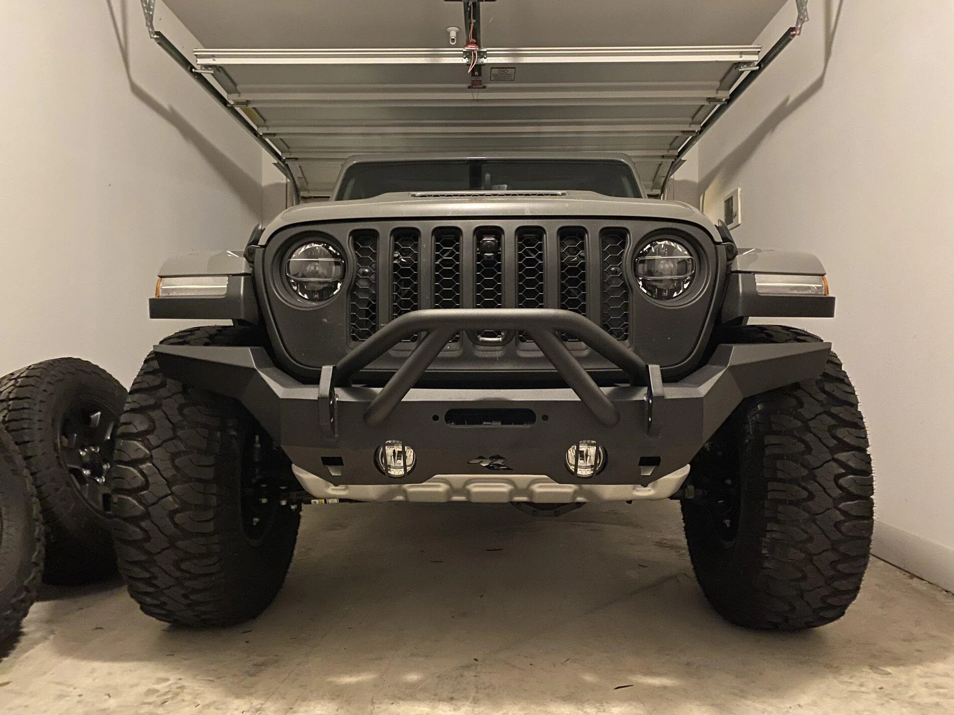

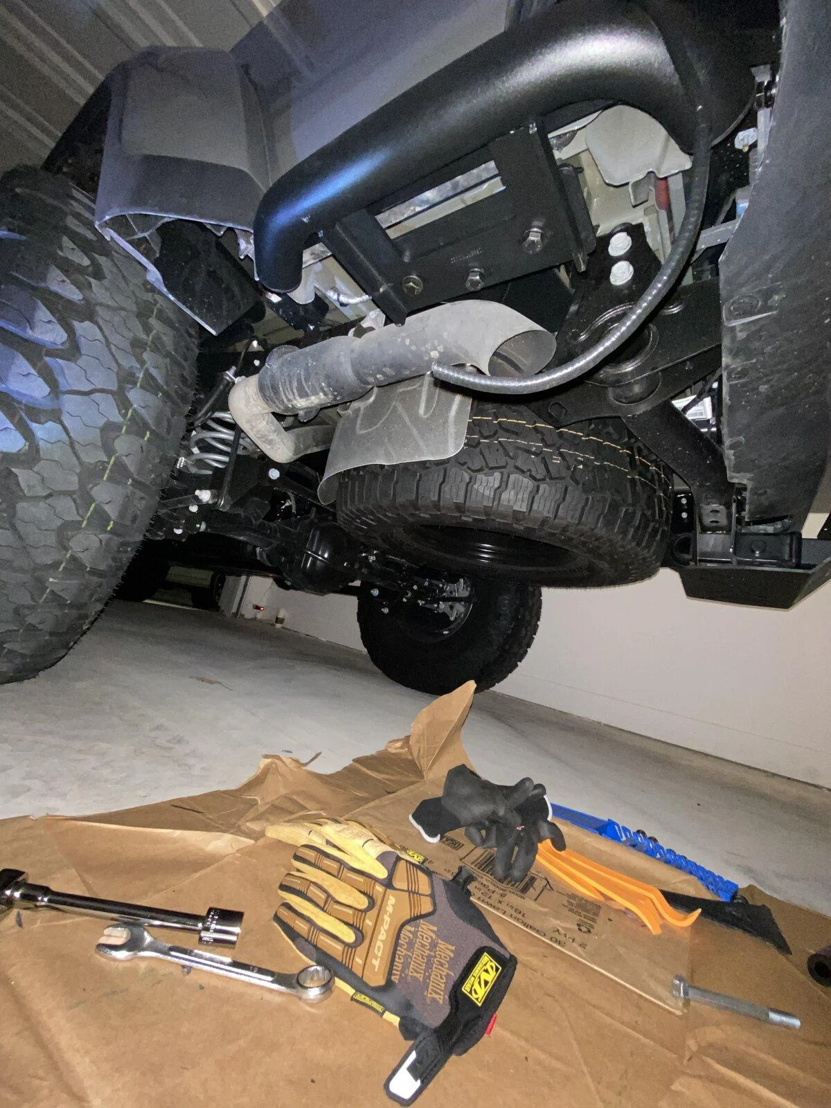

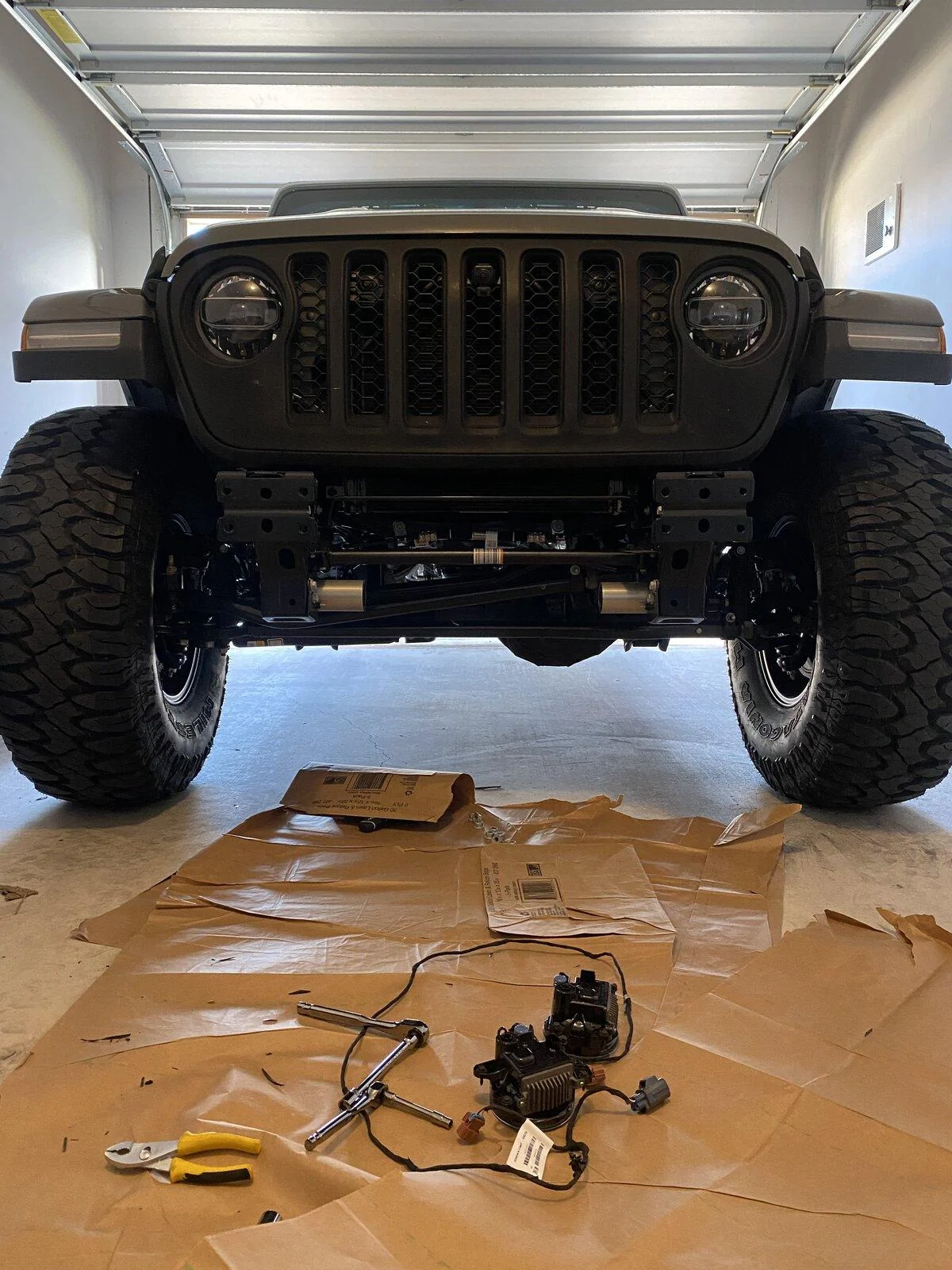

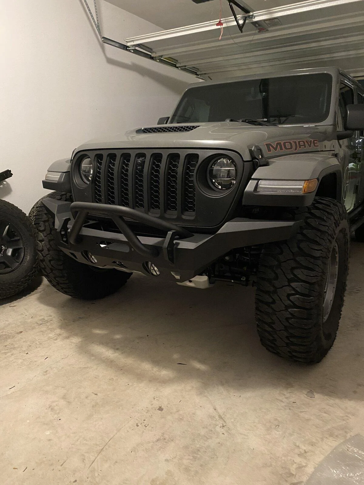

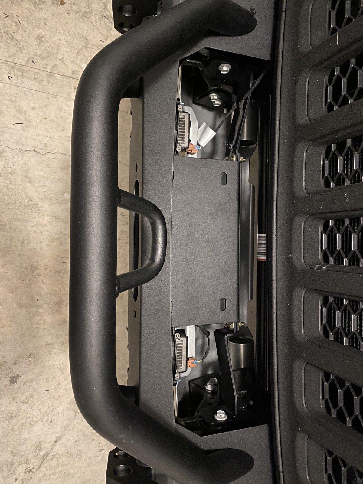

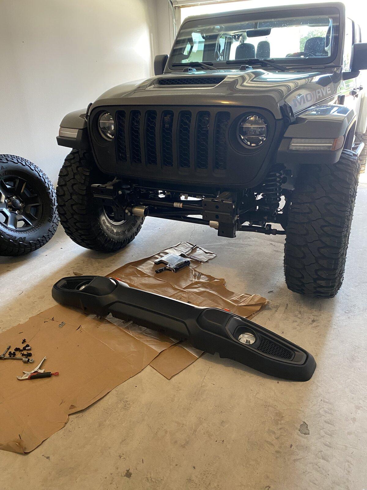

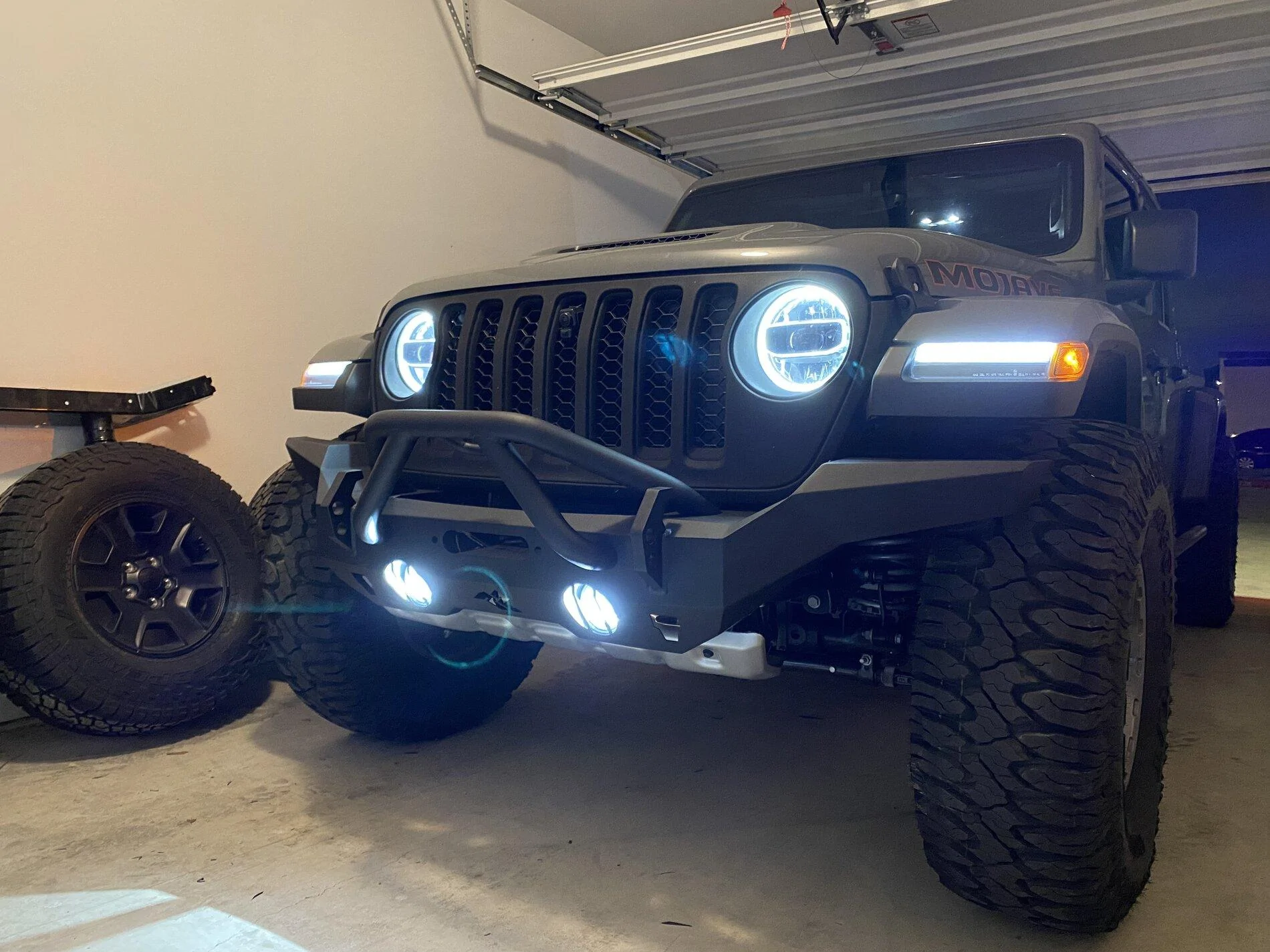

Installed the Rugged Ridge HD Full Width front bumper today with the X-Striker Bar.
Tomorrow will be the moment of truth with the 2” AEV spacer lift whether this bumper will work or not due to clearance.
I’m not a fan of the stubby style bumper because I like the protection the full width provides but if this doesn’t clear well with the 38s I’m going to be forced to sell it and buy a stubby.
I cancelled my order for the black Rugged Ridge front skid plate because it’s been delayed 3 times so I’ll deal with that later and find another solution.
The reason I mention it is because I’ve seen a lot of people talk about needing to cut small pieces out of the OEM front skid plate, that isn’t true.
Start with the top 2 bolts and keep it somewhat loose and then work on the bottom two, with some effort it will all fit extremely snug without any cutting needed.
Will know within 48 hours whether this experiment worked or not, wish me luck.
P.S. 37s wouldn’t have an issue imo, but the 38s are pushing it.

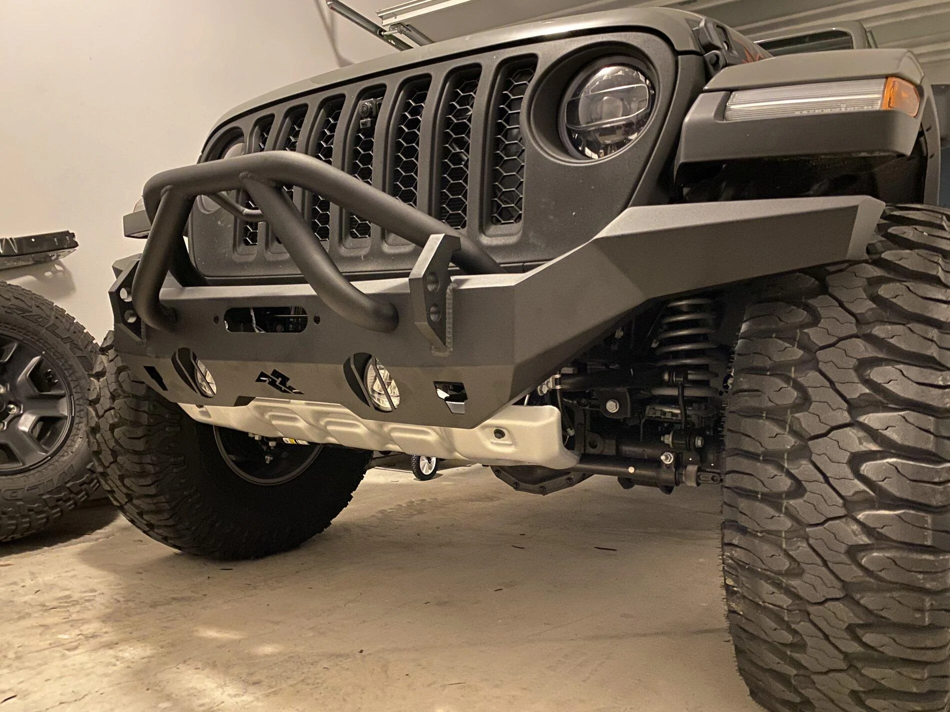

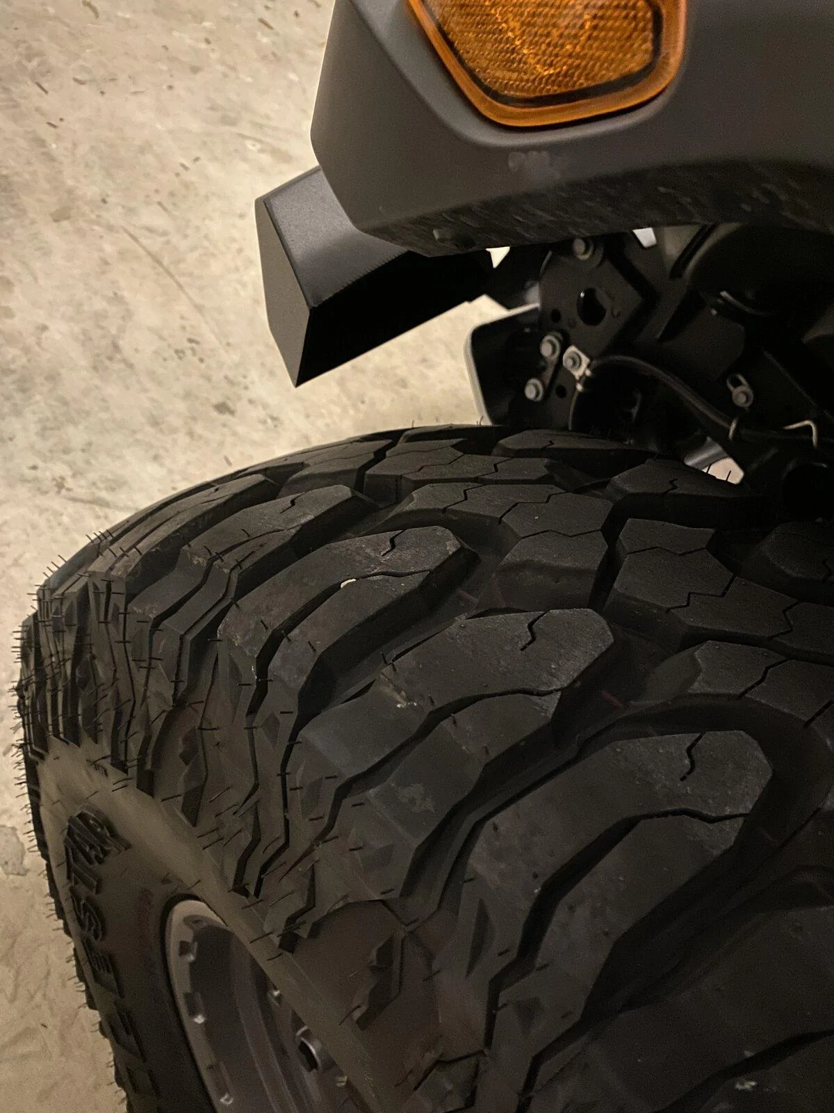

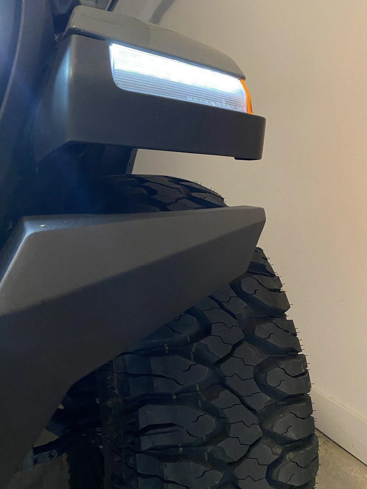

Unexpected morning, had to uninstall the full width bumper because it was rubbing as soon as I backed out of the garage and turned.
Going to install 2” AEV but I have a feeling that won’t cure this full width bumper issue.
So the Rugged Ridge HD Full Width bumper may be for sale soon.

Don't get rid of the stocks, just cut an inch or so off and re inset the cap. Keeps the pinch seem hidden and looks great.
Someone else on FB mentioned this and that's exactly what I'm going to do, thank you for the tip!
