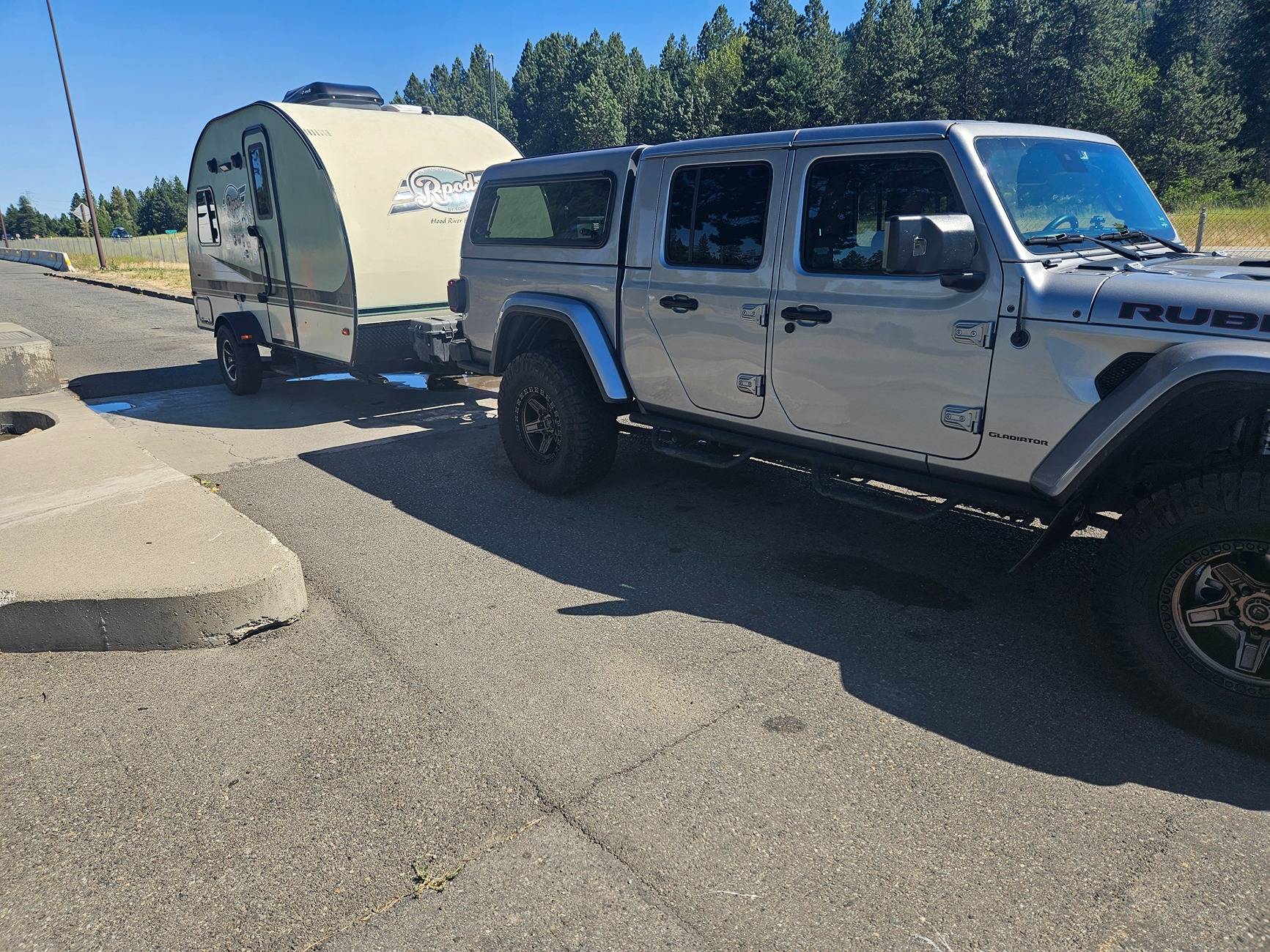

For that small of a trailer, I would consider the Curt friction bar sway system. It's all I use when towing our Rpod (approx 4.5k all loaded up) and I have had zero issues with sway or control.
Curt 17200 link
Jeep Gladiator Weight distribution hitch suggestions Rpod
