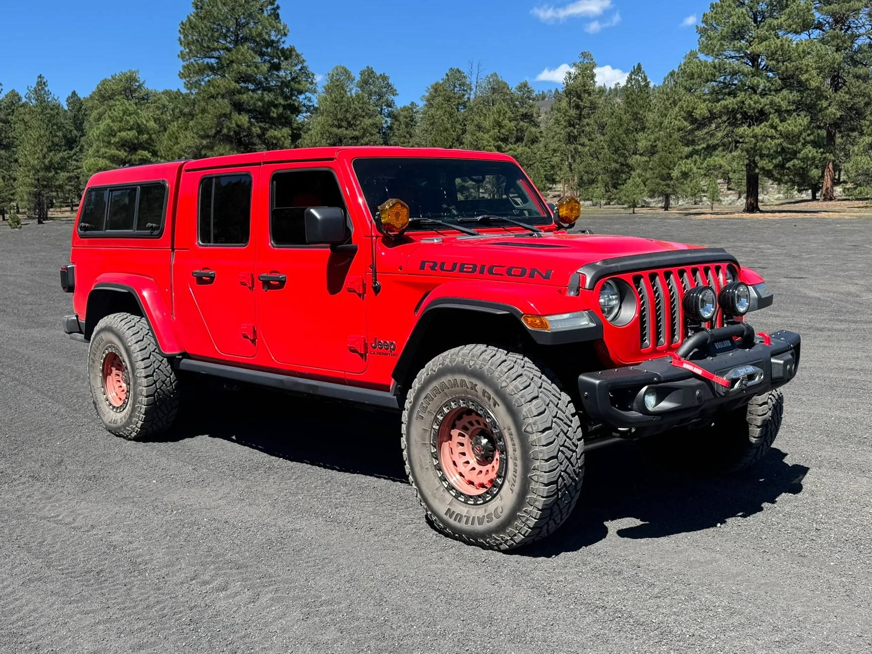

(2020 JT Rubicon 3.6, 106k miles. Aux battery is fully deleted.)
I experienced some strange electrical-related issues while off-roading last weekend. On the way to the trail, while driving on the freeway, the “Service Brake System” warning would briefly flash on the center screen. This happened several times during the drive.
While on the trail, I had the A/C and radio running. Several times, the blower motor would suddenly cut out and stop blowing air, and at the same time, the radio volume would stop. In some instances, both would automatically come back on after a split second. A couple of times, I had to turn the fan dial and adjust the volume knob before they would come back on, but they always resumed functioning.
The last issue occurred while I was stopped on the trail. The “D” for Drive on the PRNDL display started flashing, and I had to shift into Neutral and then back into Drive to get it to stop flashing.
I have never experienced any of these issues before and am not sure if they are all related. I would appreciate any thoughts on what could be causing these issues or if there is anything specific I should have checked. I have had no issues with the vehicle during my commute to work since then.
