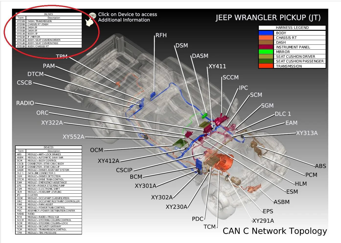

I think they are shotgunning parts with the PCM and guessing. Unless they scoped the can bus signal and started isolating the system, they are guessing.
