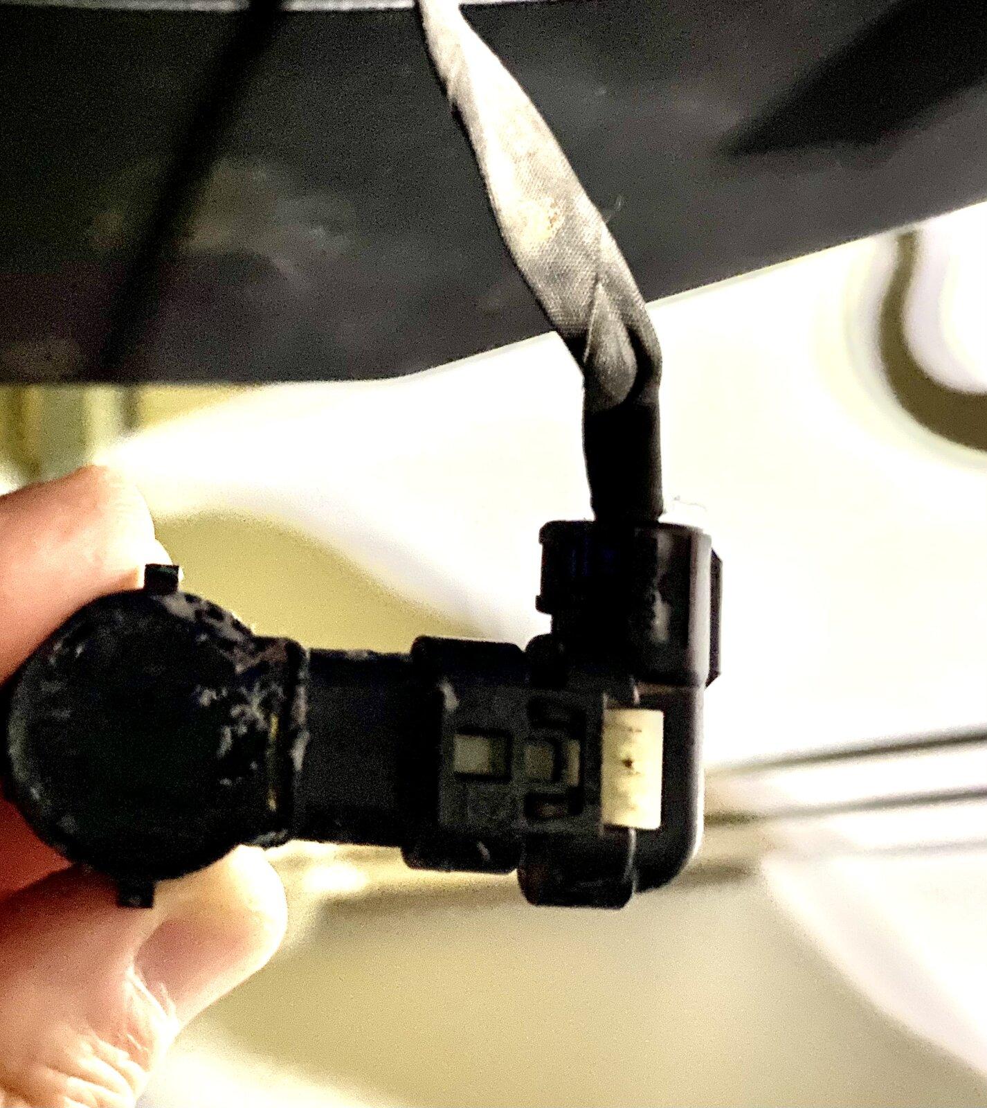

What is the super secret trick to disconnecting the “locking” wiring harness plugs? I use a tool to move the little white “locking” tab up and push down on the tab and for the life of me, the connectors will not separate.
In this case, I am trying to remove the rear sensors from the back bumper harness. Similar deal I had with the rear license plate lights and wound up cracking that connector.
I’ve never had harness connector issue every before until now. Is there some super secret code to do this on the Gladiator?

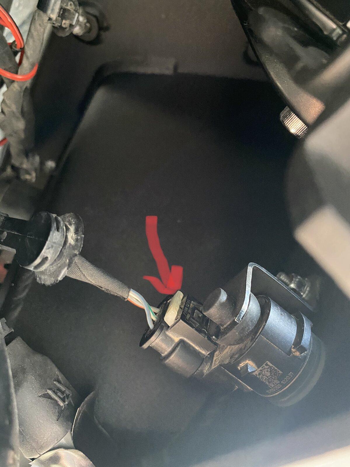

You need to pull back on the white tab then push down on the black pics above it

try pushing in on the plug then press down on the black tab and THEN pull it out.

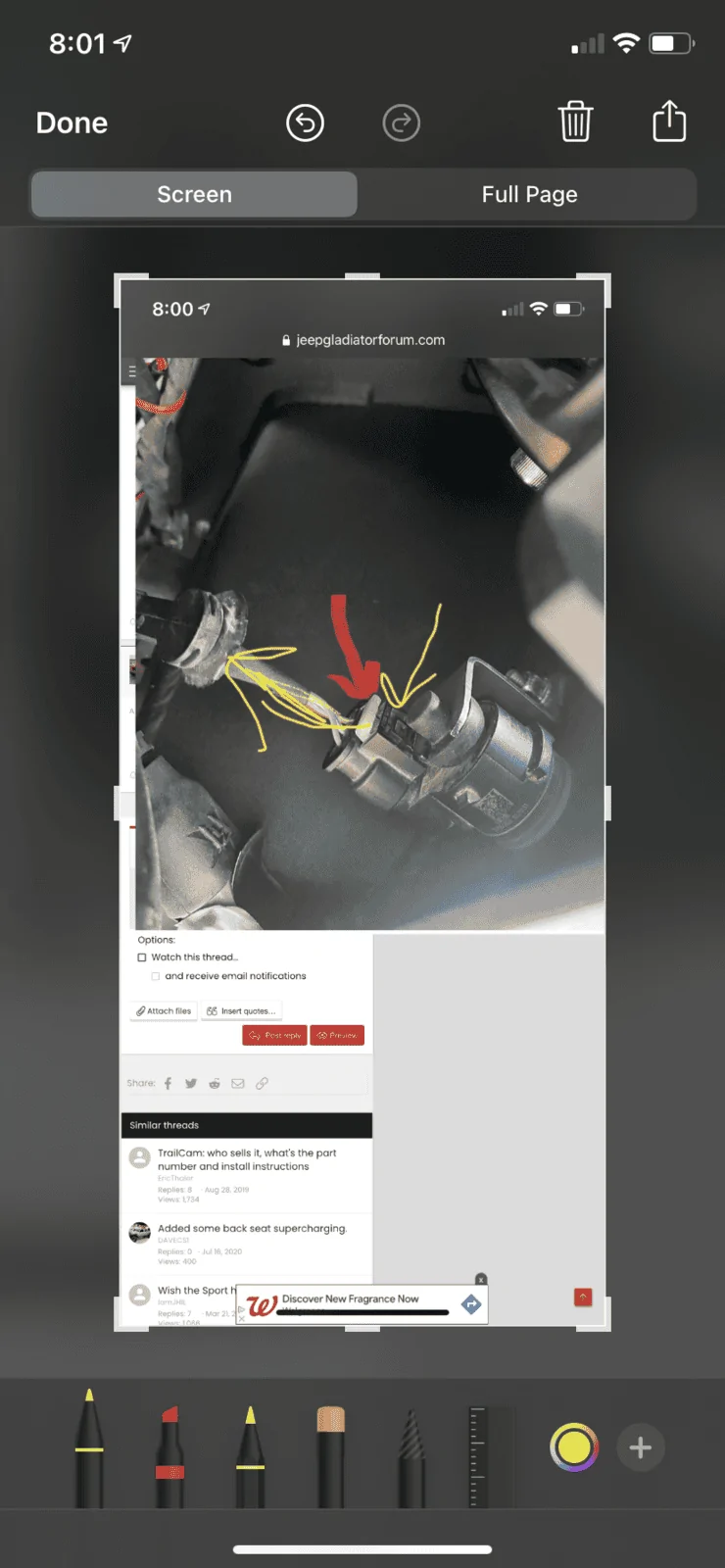

How far out should white tab come out? This is how far I can push tab up.
Having broken one on license plate lights has me thinking twice now.
Talk about making something so simple complicated.

Ok .... success. It did require some coaxing.. got one apart. Must be this super fine AZ that acts like glue.
Thanks for the assist !!
