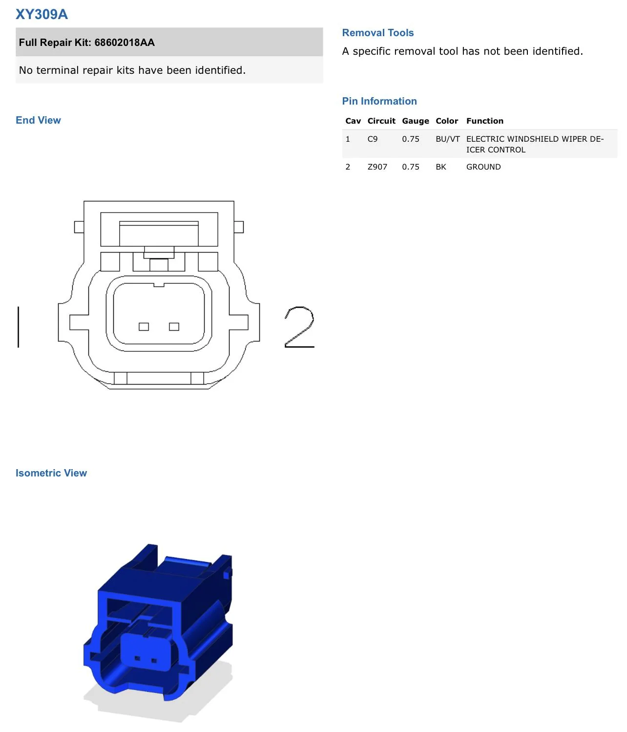

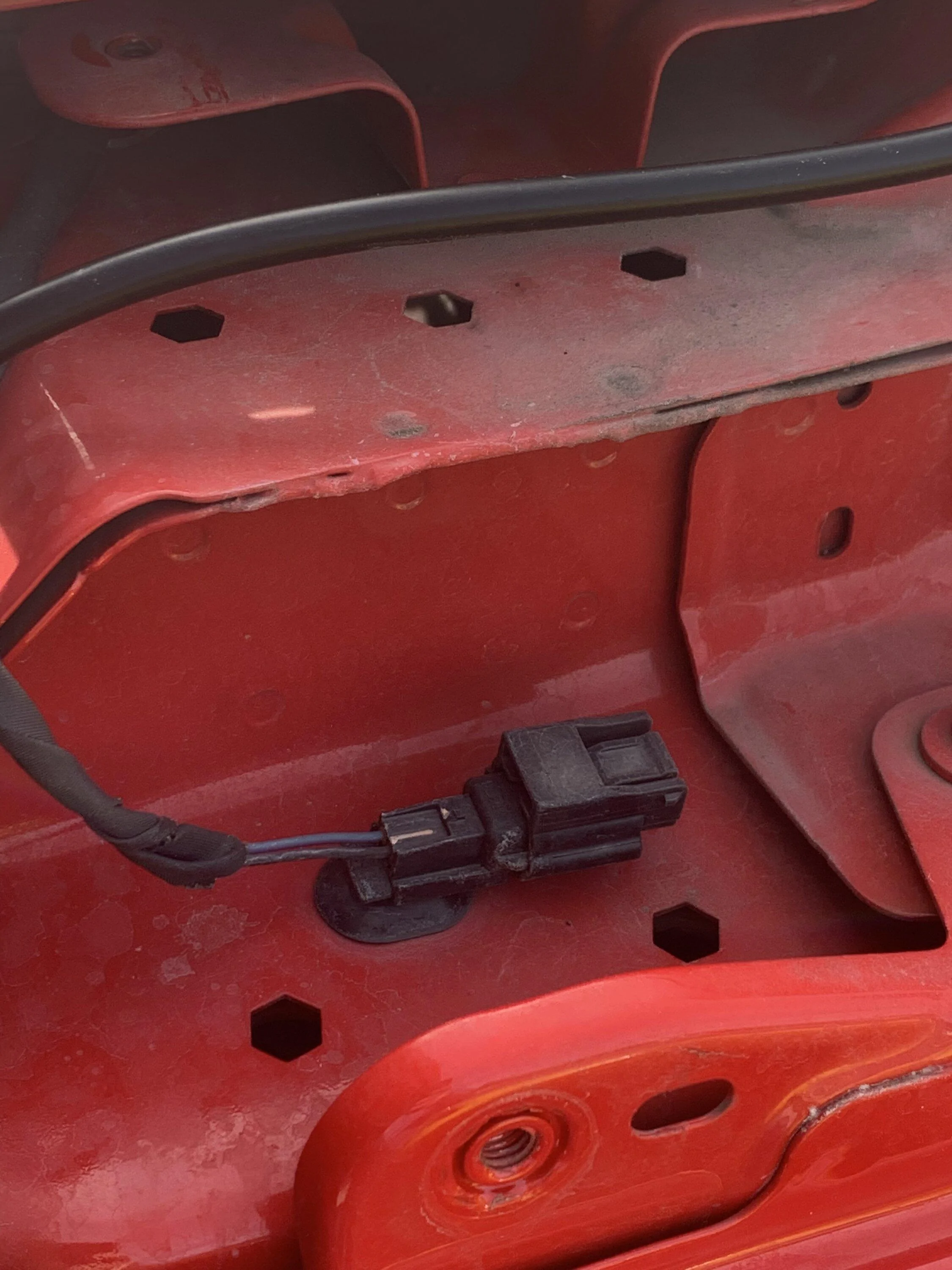

It’s for the electric windshield de-icer. It keeps the area of the windshield that the DASM camera looks through clear of fog/frost/ice.
The control wire originates at the BCM and runs to the relay trigger coil in the PDC. The output runs from the PDC to the connector shown in the OP, and that’s where it terminates on a non-ACC vehicle.

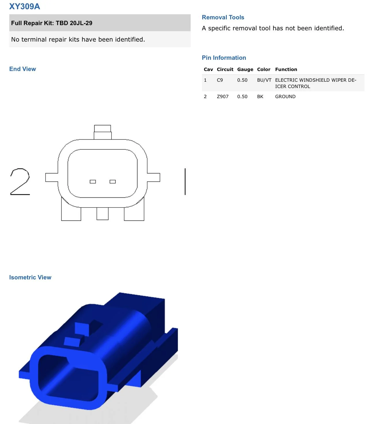

This is the connector that is populated with the wires:
Jeep Gladiator What’s this connection for? B4DB595C-6F98-4E84-A83B-8EEA0E9C893B
This is the connector that is terminated and weather sealed:
Jeep Gladiator What’s this connection for? 15177C00-3258-4B1A-9A16-67F286746588

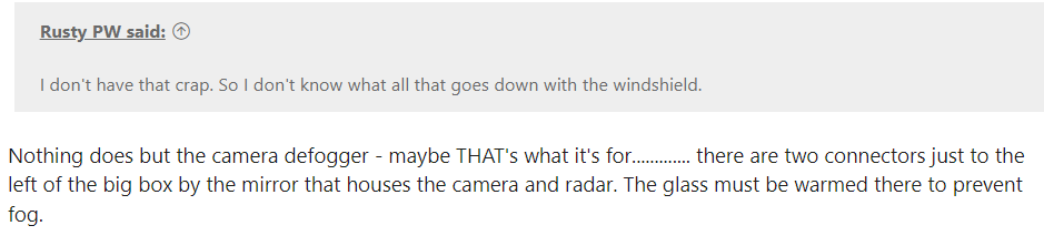

So that's where I was assuming if indeed it was connected to ACC vehicles - it's for the defog element on the top of the windshield on ACC vehicles.
The BCM being where it is, and the relay in the PDC being where it is, that makes sense.
Jeep Gladiator What’s this connection for? 1668297687073
