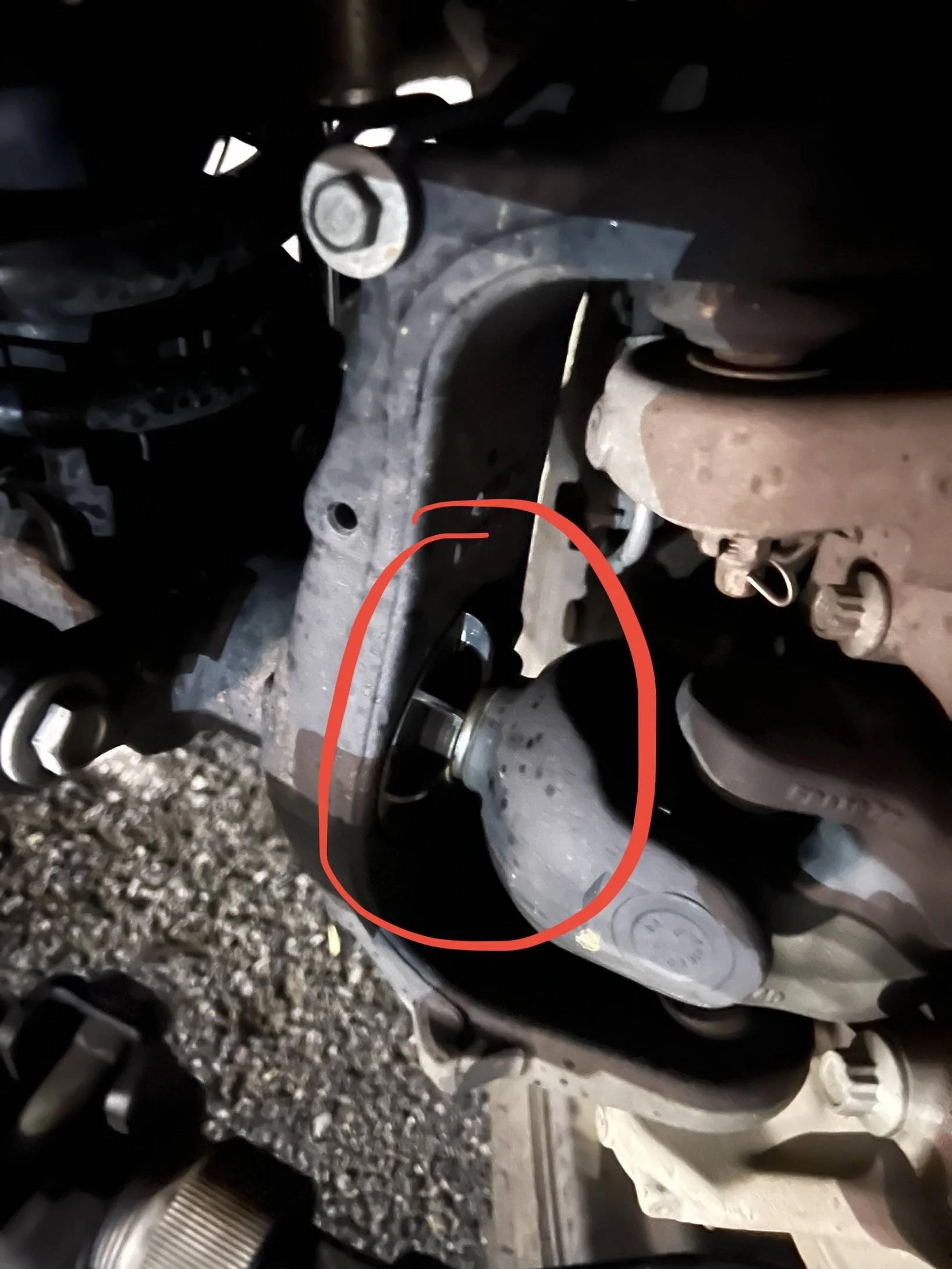

What’s this plastic piece on axle?
JTinVA
Ray
Mar 31, 2022
48
vA
2020 rubicon gladiator

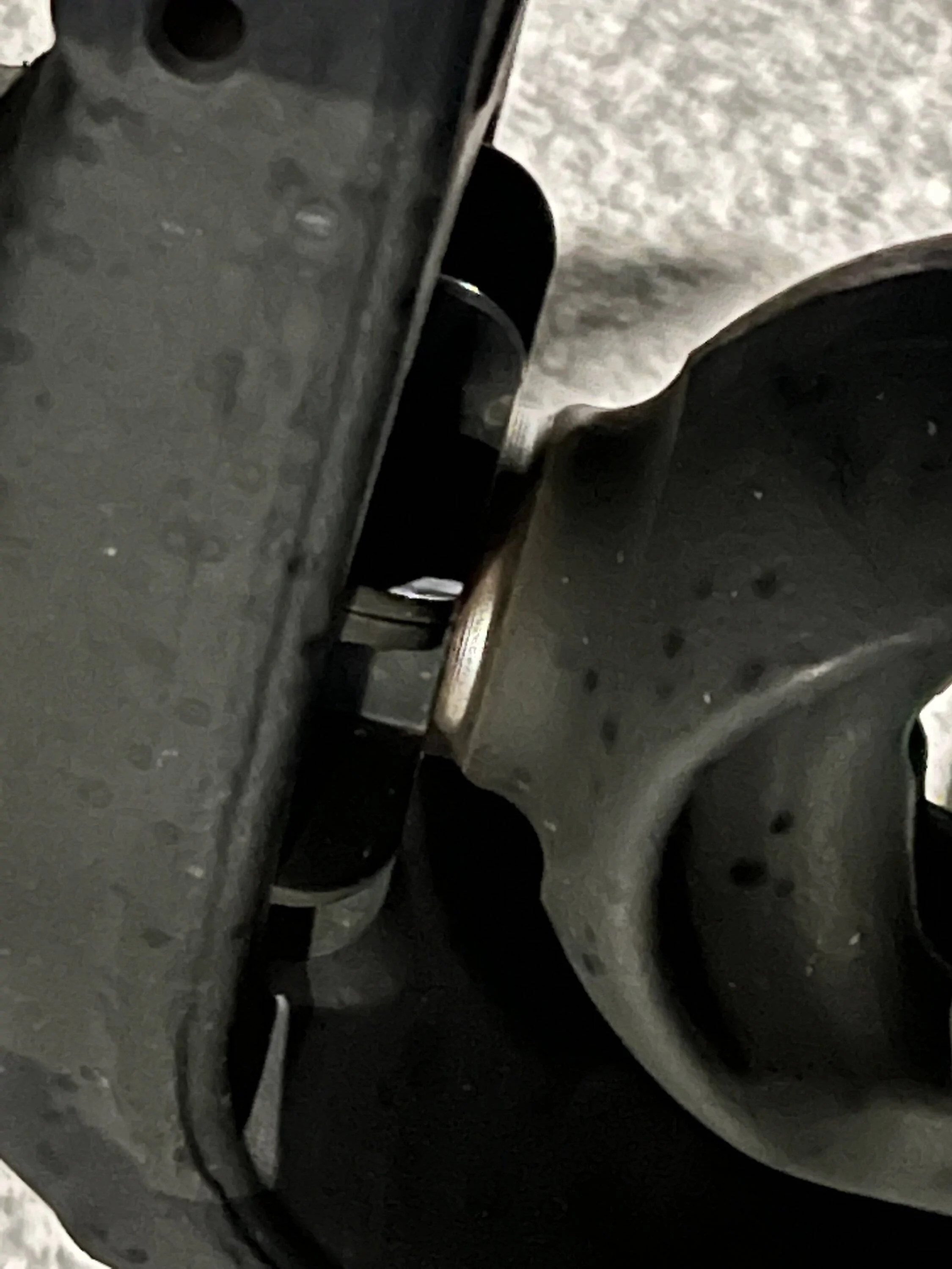

Is it supposed to spin freely and move back and forth? Mine seems to have a pretty big gap
Jeep Gladiator What’s this plastic piece on axle? 01A4B5E9-C447-48F3-9A41-9E81CC20CDC1
Jeep Gladiator What’s this plastic piece on axle? B5BECF53-22ED-4BAF-800D-7482C76B5814
11,434
30,464
It to keep the crud out of the axle tube and help the axle seal last longer. That piece of plastic just sits in one spot. It's free to spin, and to move a little laterally.
40,496
54,007
Is it supposed to be able to move forwards and backwards?
Yup - there will be a bit of end play in the axle so it can't fit tight against the tube.
In some applications it might be called a "slinger" as it slings stuff away from the seal and what it's protecting.
