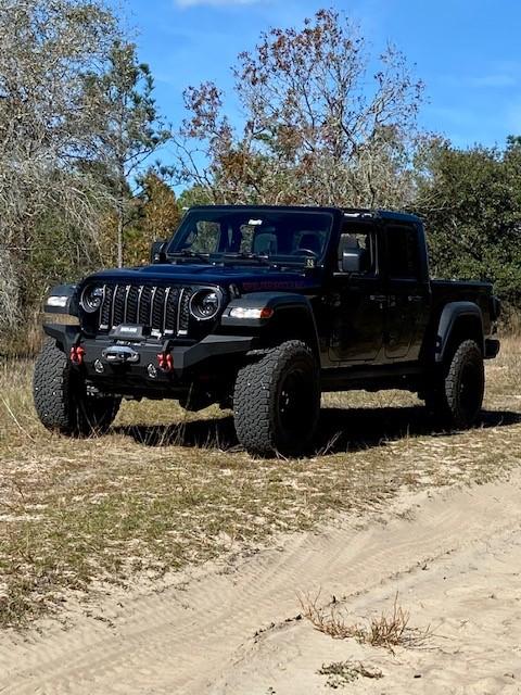

I installed the Mopar lift (latest rev w/ larger shocks) with a 1" teraflex spacer up front, and it ended up 2 3/4" lift from stock height for me. No more bottom out and the ride/steering are all much improved. With the bumper/winch (+95 lbs.) it sits fairly level with this setup.

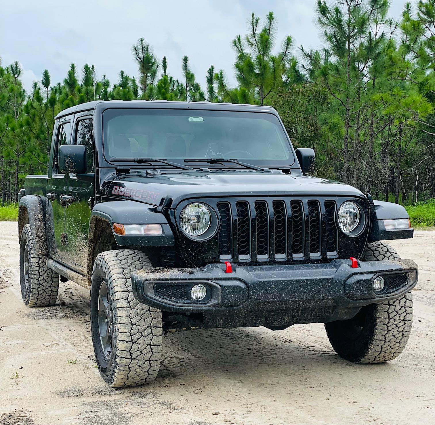

I just replaced the trackbar with Synergy, no particular reason, other than an associate was selling his for half price (he traded his in). The lift comes with the new LCA's and I'm very happy with how it handles on & off road. Here's a before & after.
