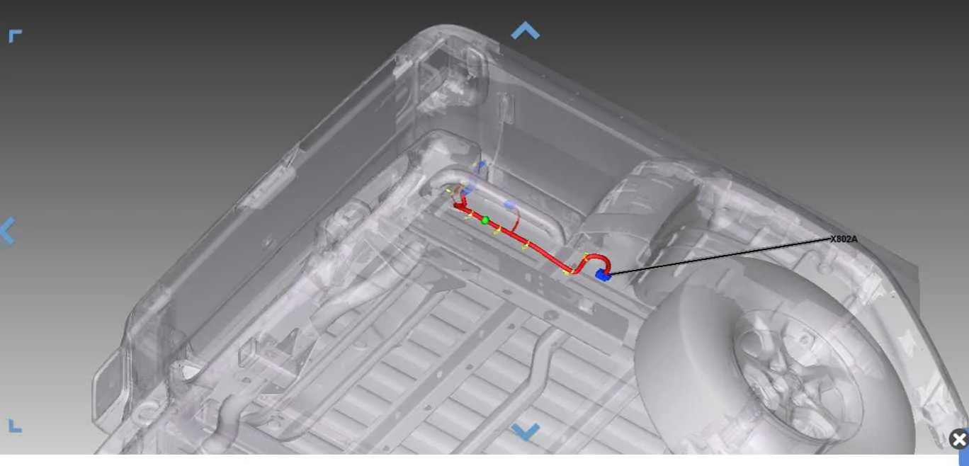

Hi Benny maybe you can help me out. I want to add the 115v outlet that goes in the bed. The tech at the dealer is saying that it's a factory only installed item, and there's no way to install it now. Is this true? I know I'd need the switch on the dash, the outlet and probably a wiring harness. I already have the 115v outlet in the rear of the console and from what I've read the bed outlet uses the same invertor.
Hi The tech is correct there is no add on "kit" but as with anything it's always possible.
There is a small harness available to purchase but the connection where this harness plugs into needs to be inspected to see if the opposite side is present in your harness.
See below image for that location and attached for the electrical diagram in the case custom wiring is necessary.
-Benny
Well I'm getting closer than I have so far, what about the wiring behind the dash? Or is there a way to buy the harness's that go to the dash, the invertor, and then back to the plug?
Well yes you can purchase any harness you want but the question is what is actually required and what may already be there? Have you checked for the connector under the bed first? Can you send me your VIN so I can checkout a few things.
