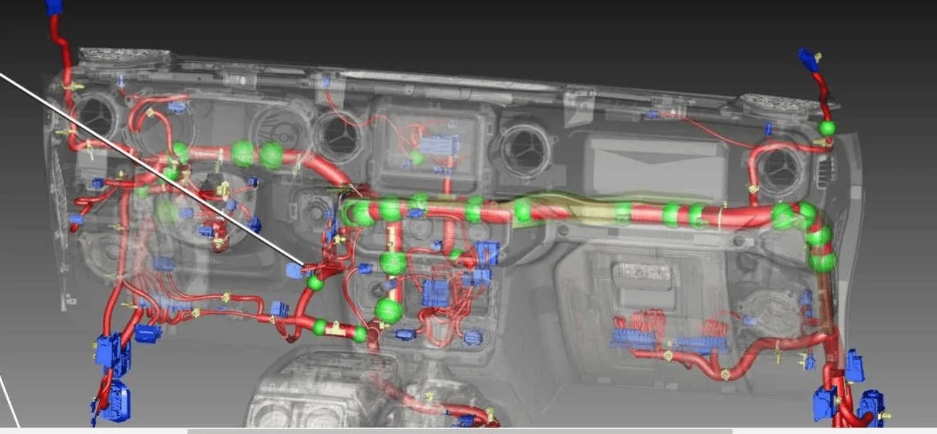

Is it possible to upgrade the standard center console in a 2021 to add the factory power inverter that comes with the media group?
I see the plugs and the rear trim are available, but do you know the part # for the actual inverter?
Edit - I think I found the inverter module
#68352379AB
Now... what about the harnesses?
Thanks!

The harness for the console is 68493761AB but the real issue is you would have to change out your entire IP harness. Below you can see the connector is part of this harness
Jeep Gladiator What can we do for you? 1621548884075
-Benny
-Benny
Soooo homebrew it is!

I wonder if that harness is just sending power/neutral/ground to the plug from the inverter. (I know it has other things but that's the thing I'm focusing on in) I could stick a regular inverter under the dash then cut the end off an extension cord and wire it to the factory plug.
Might spend a little $ to find out.

Here is the connector pinout
PinCircuitWire ColorGauge/SizeFunctionOption
1A401RD/GN5.0FUSED B(+)220VAC INVERTER
2P805GN/DB0.35115 VOLT AC LINE 3110VAC INVERTER
2P825GN/BU0.35220 VOLT AC LINE 3220VAC INVERTER
3F982PK/YE0.50FUSED IGNITION SWITCH OUTPUT (RUN-ACC)
4D403OG/DB0.35LIN BUS CBC 3
5P812BG/BU0.35INVERTER ENABLE 2
6Z910BK5.0GROUND220VAC INVERTER
