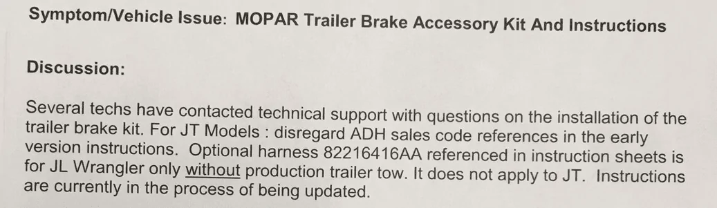

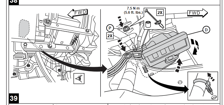

It will take just a few minutes for you to confirm that you have the harness. In that video when he is working under the steering wheel, he highlights the plug that you need. That kick panel under the steering wheel just pops off towards the rear of the Jeep.
Since you have trailer tow, you have the trailer connections by your rear license plate right? So you should have the plug under the dash, unless FCA did an FCA thing. Even then, if you don't have one, you just have to run the harness under the frame. It isn't a horrible job. The instructions outline it and give you the part number.
Install was straight forward. Getting the cigarette outlet out was a PITA. Took an alarming amount of force with three pocket flat heads. But the two videos I watch, neither had issues.
I have no idea where the box is supposed to mount. Maybe someone else knows.
ALL JTs have that harness, even with no "tow package".
It's normally found along the left kick panel. I didn't have to remove any panels, the pigtail/connector was taped to a larger wiring harness that runs up the left kick panel area. Pulled the tape loose and plugged it in. It was simple to plug in. Mine had nothing to do with the steering column area wiring at all.
You do not need any additional wiring harness.
Jeep Gladiator What did you do TO your Gladiator today? [ADMIN WARNING: NO POLITICS, NO GUN TALK] 1642369311394
The controller mounts on two existing studs on the left side by your left foot. It may not clear if you have a manual transmission???
But it mounts right next to the harness connection.
Jeep Gladiator What did you do TO your Gladiator today? [ADMIN WARNING: NO POLITICS, NO GUN TALK] 1642369471675

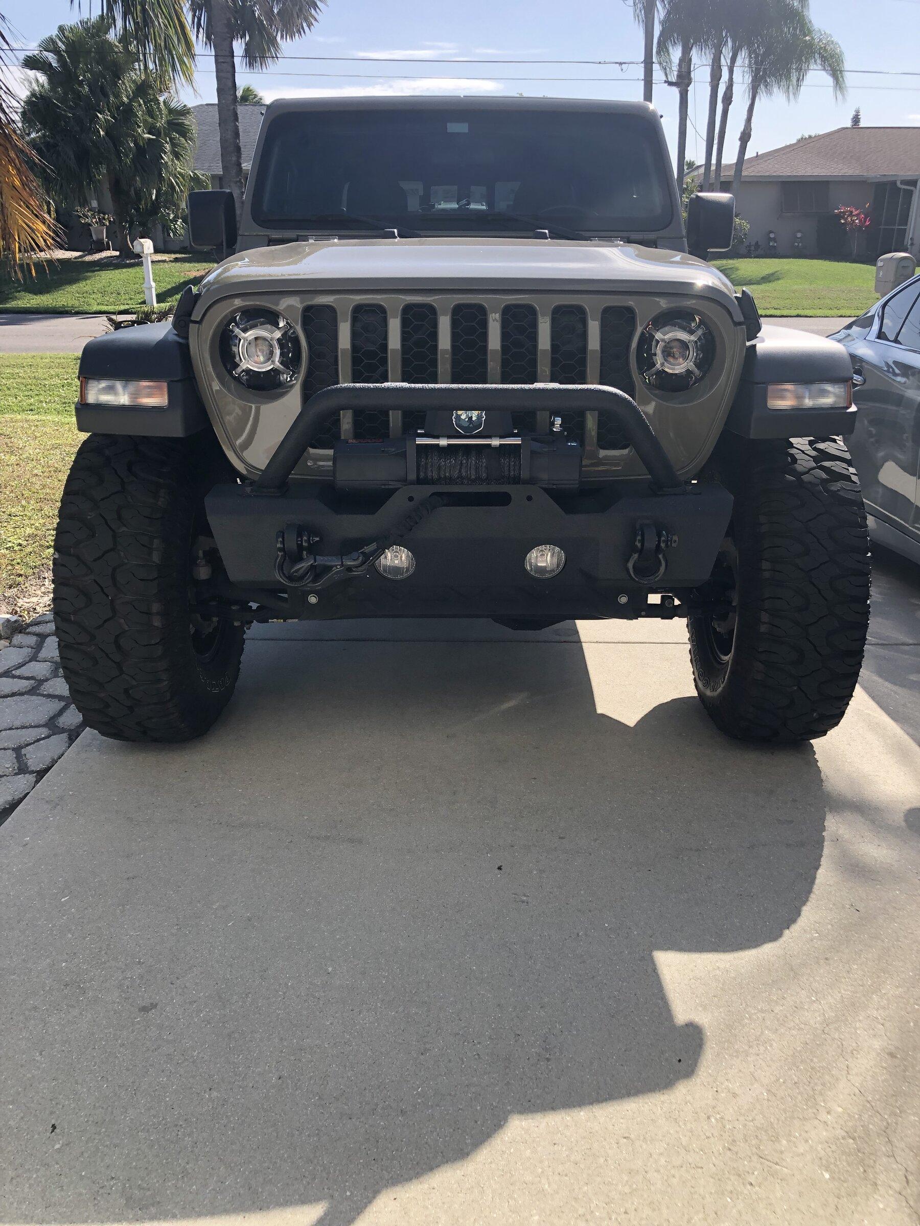

Installed a new to me 13000 Zeak winch with synthetic rope. Found it on OfferUp for a steal. Still awaiting my black hawse winch fairlead to arrive and finish it off. I also have DV8 LED fog lights to install, but I got rained out today.

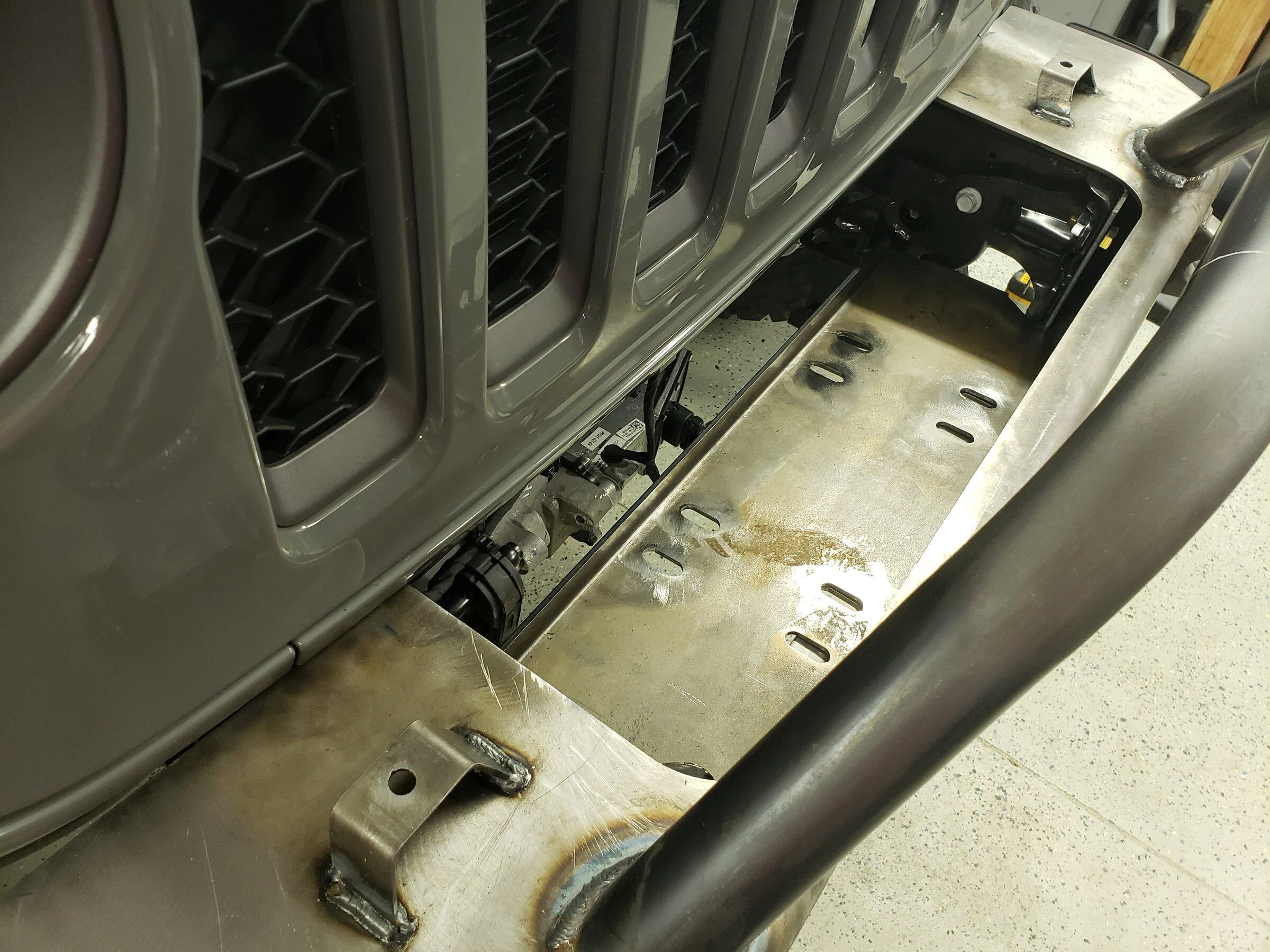

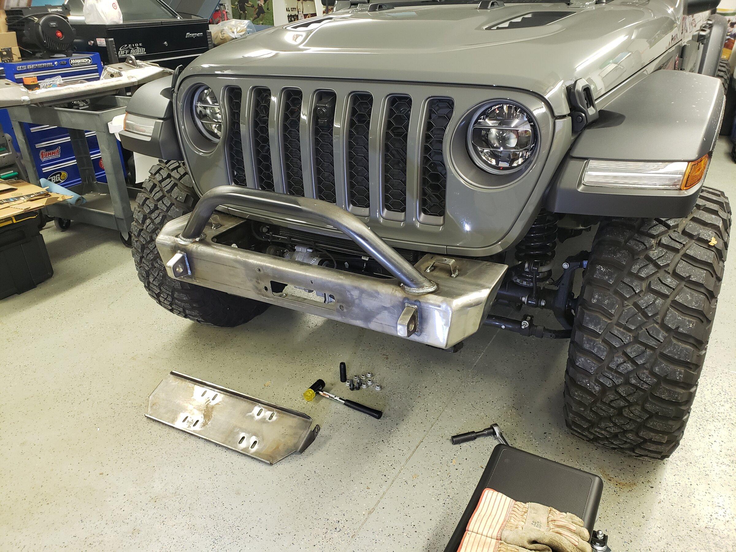

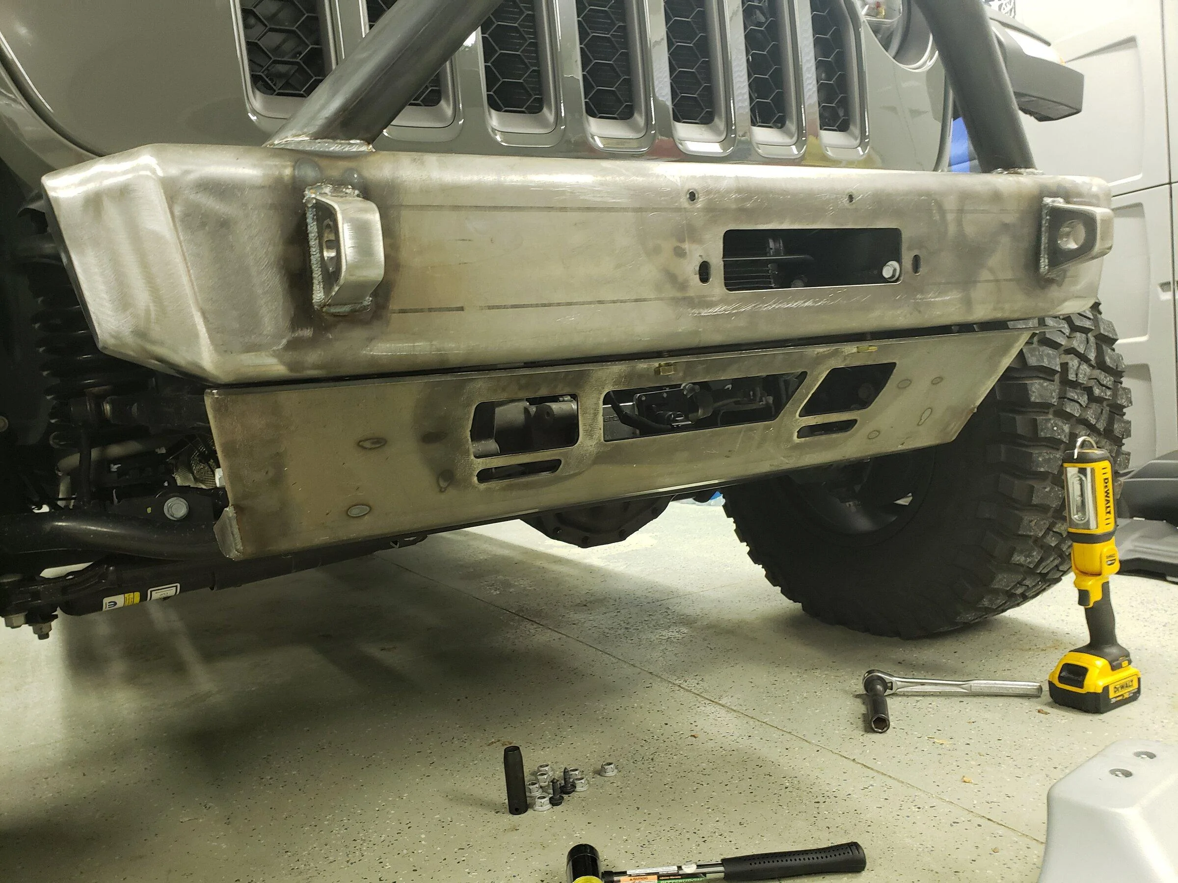

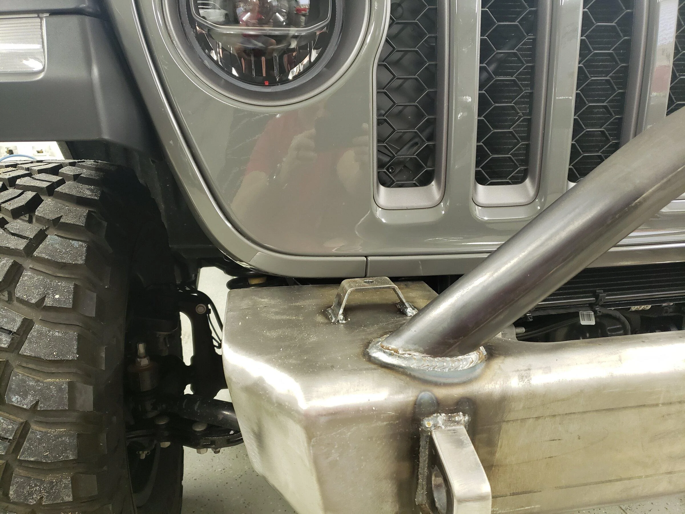

Mocking up the front bumper before getting powder coated. Shrockworks bumper utilizing factory LED fog lights. Tabs on top are for light pods which will probably get added in the future. Ordered bare metal to match the powder coat of my White Knuckle Sliders.
