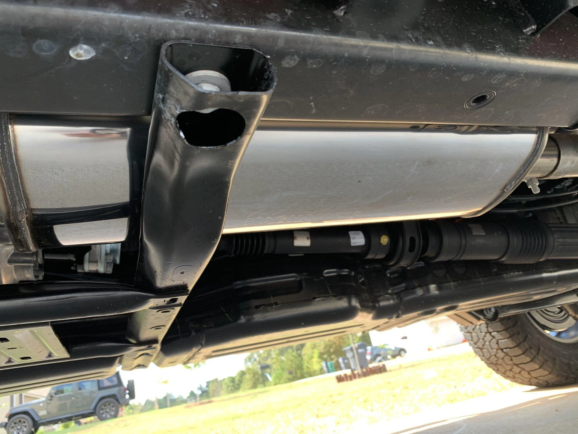

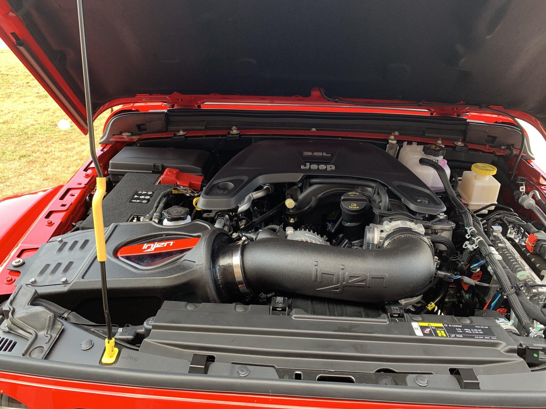

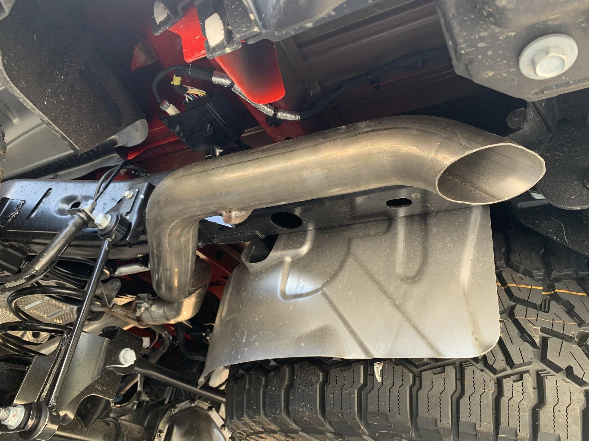

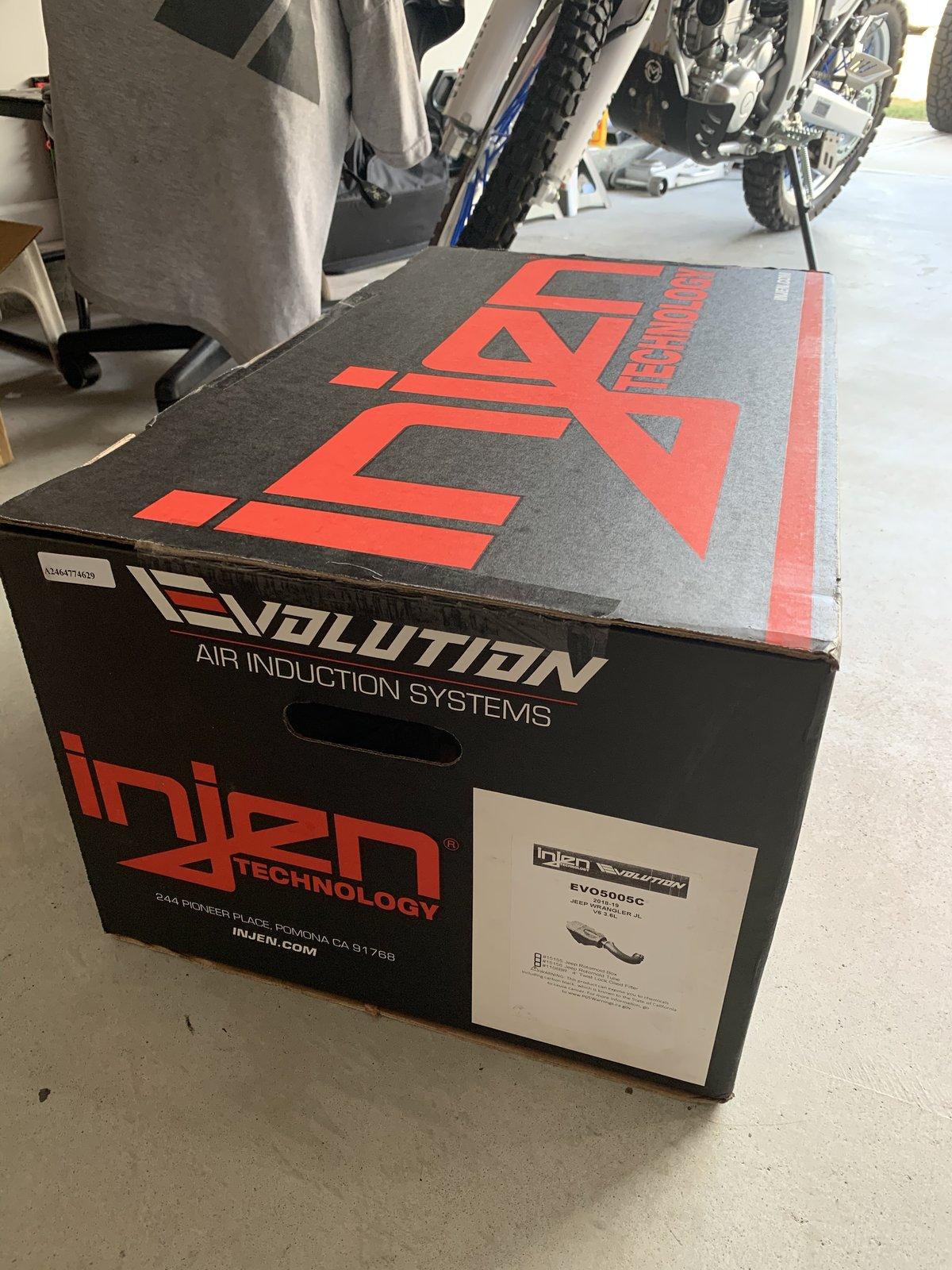

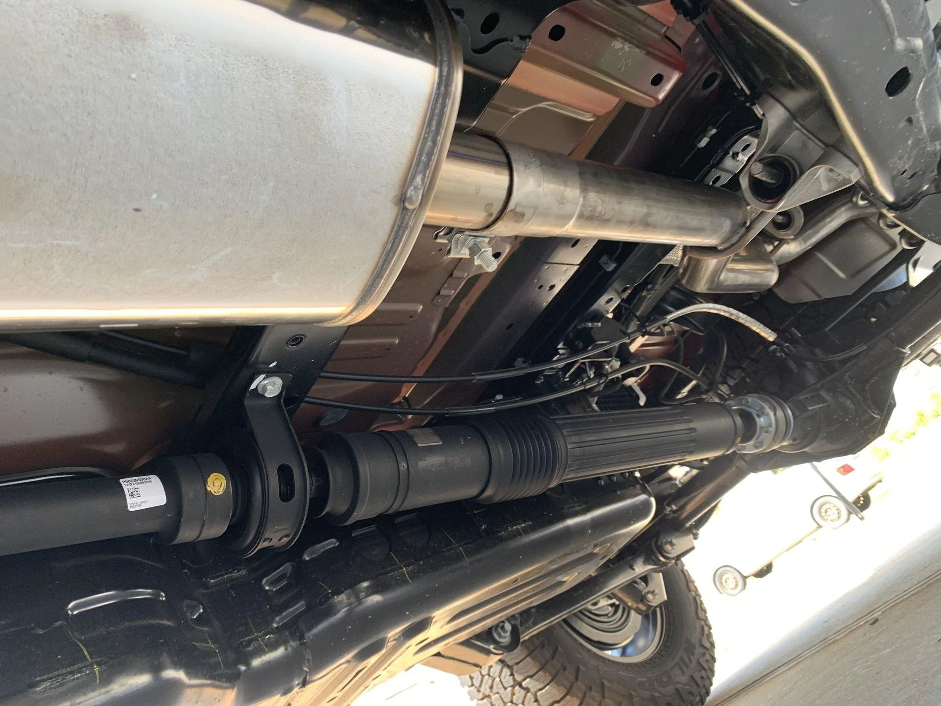

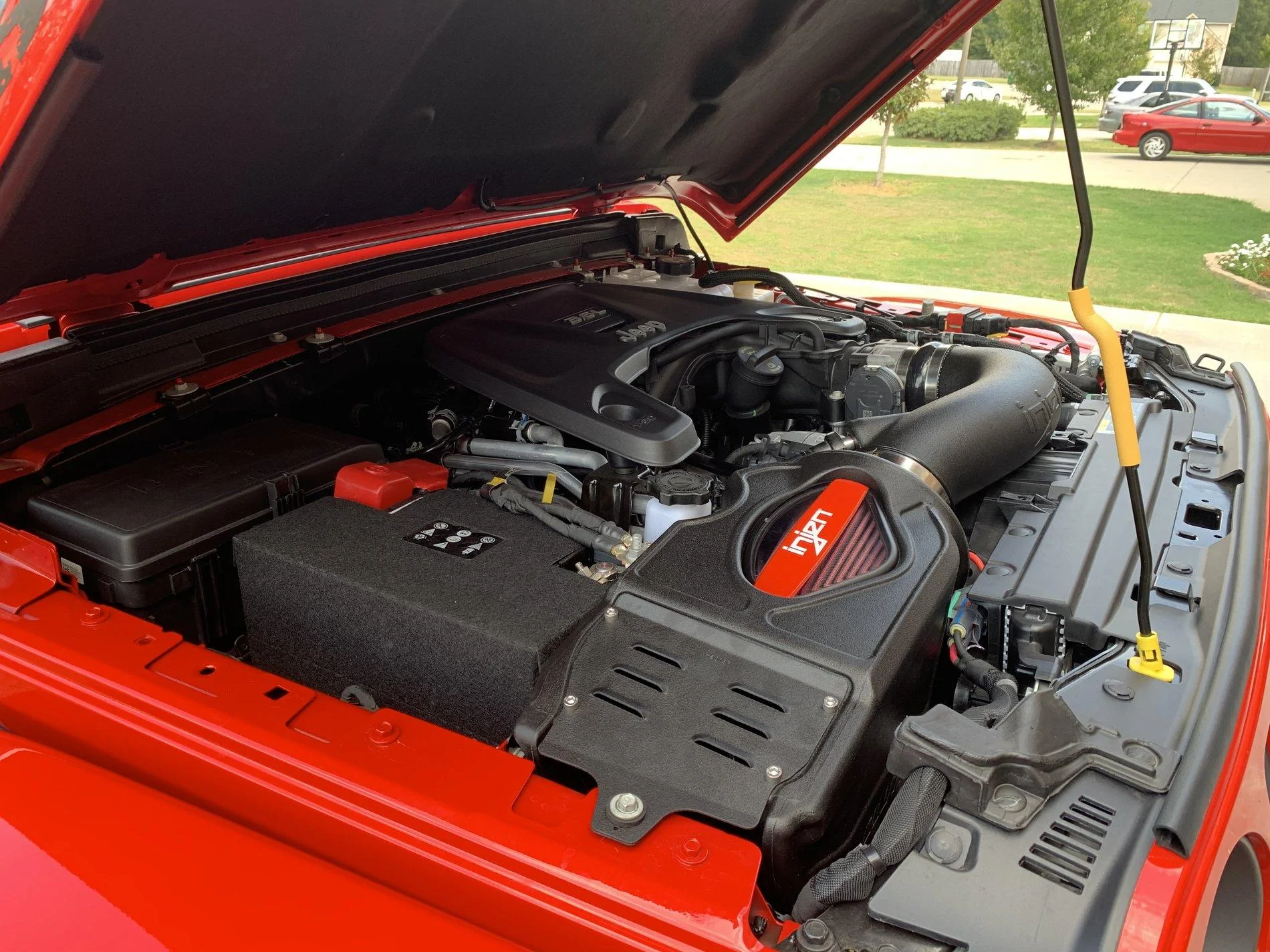

Just finished installing my Injen 5005C CAI :). Also took some pics of the exhaust

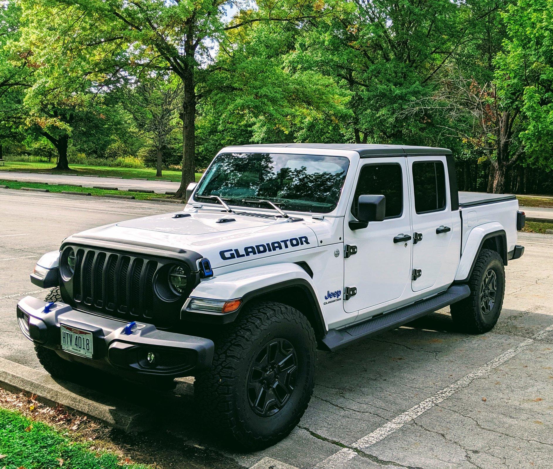

Winch installed. Zeon 10. Steel cable for now. Would have gone synthetic but could not wait for backorder as I needed it installed now in preparations for a 2 week trip in 14 days. This was actually a pain in the ass to install. The Winch did not fit as the housing is too wide for the space between the bumper mount flanges. Not due to the bumper but due to the Gladiator's bumper mount flange. This bumper does not use the center top holes to mount, luckily. I had to grind off a half inch of steel from both mount flanges to get this winch to set on the mounting plate. I scratched the crap out of the sides of the winch due to fit testing and trying to get it in but there was no way without grinding. But now it is set and seems to work fine.

Also of note is that this setup dropped the front of the jeep 1/2" measured at the front of the rock rails.

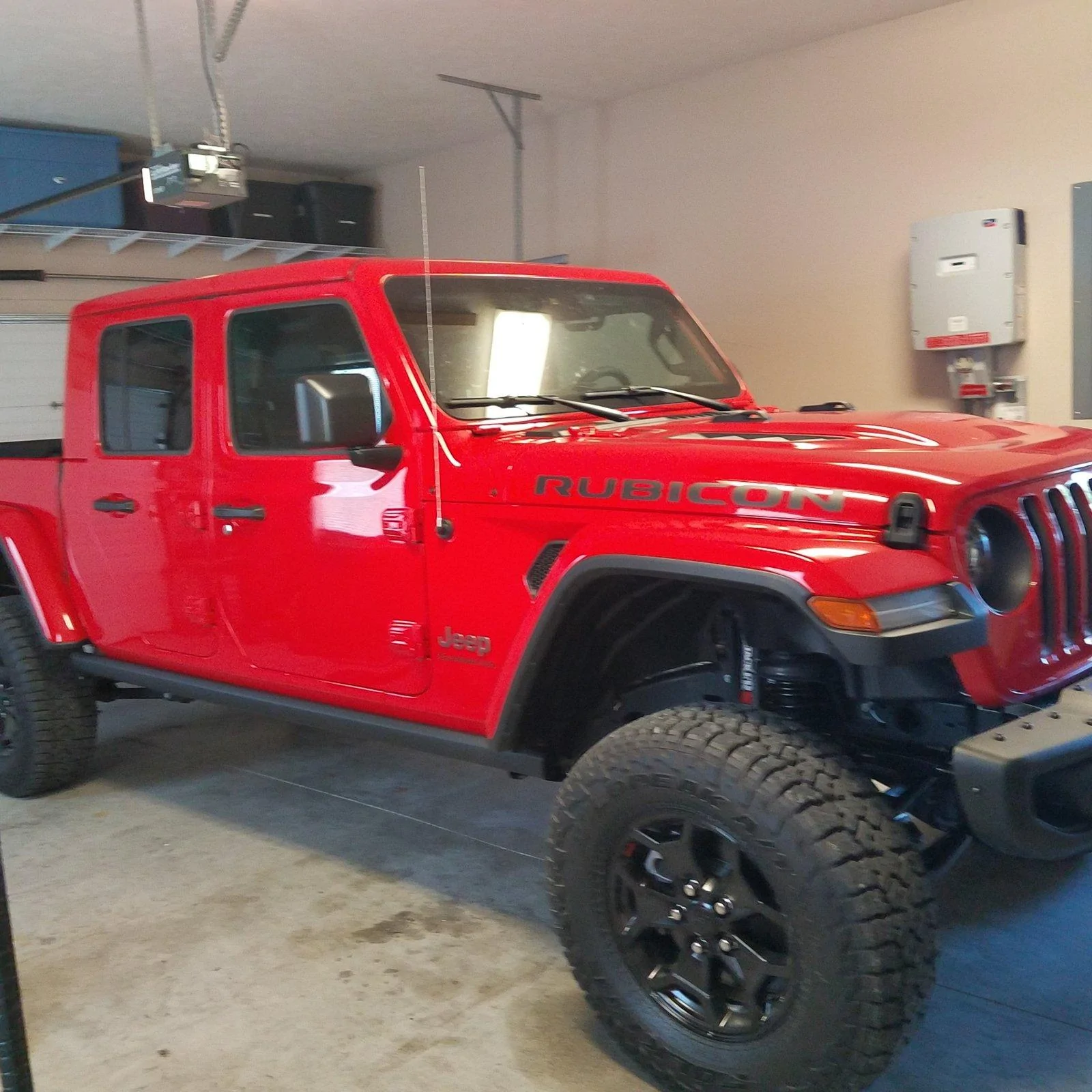

Finished up installing the 4.5 skyjacker lift. I tried to get it aligned but my local shop says there computer can't do it with the current firmware. Guess i will have to take it an hour to the dealer :facepalm:

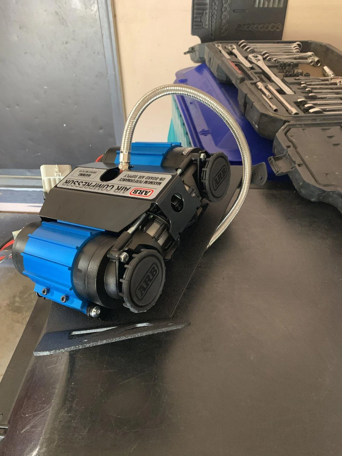

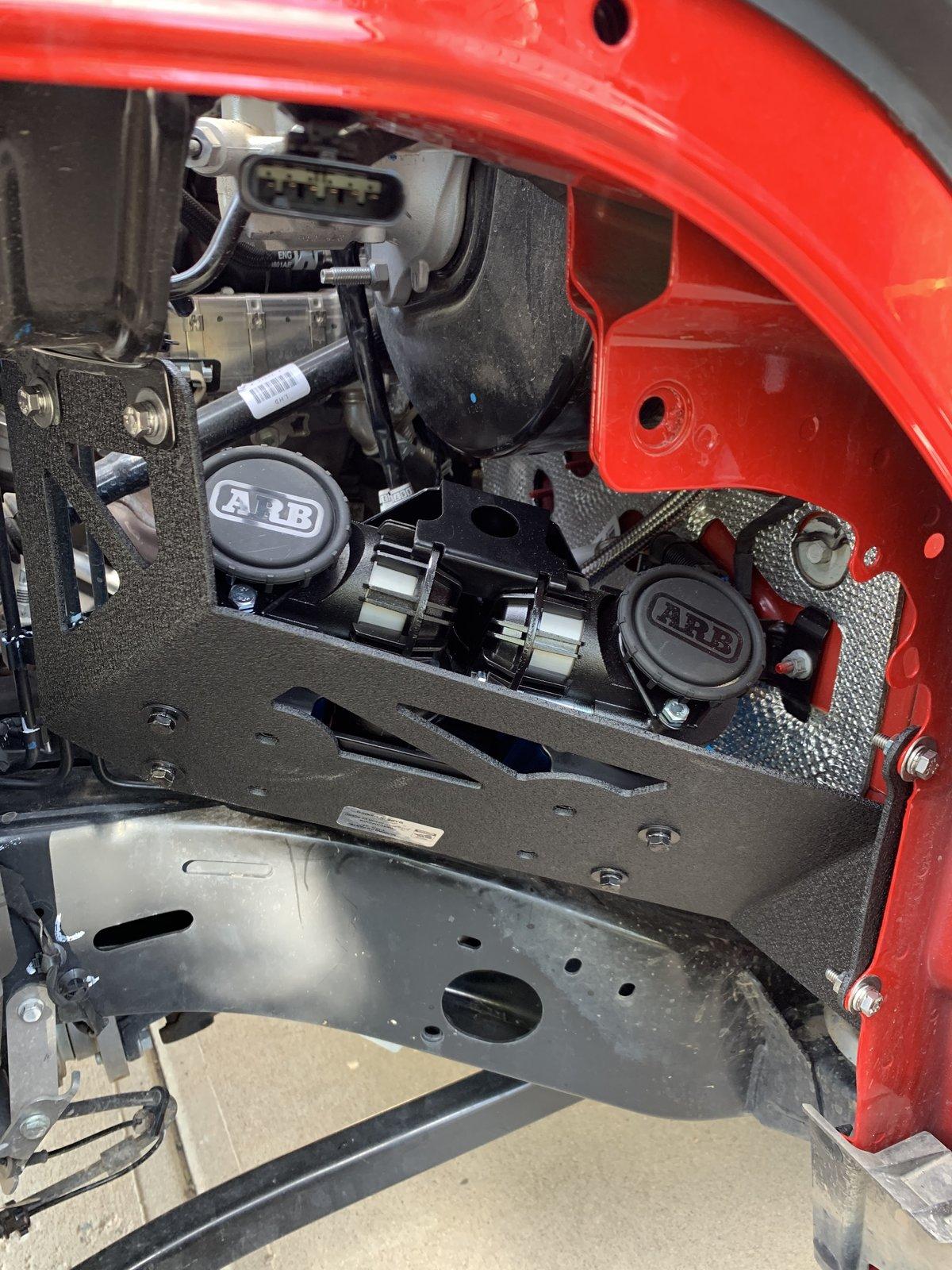

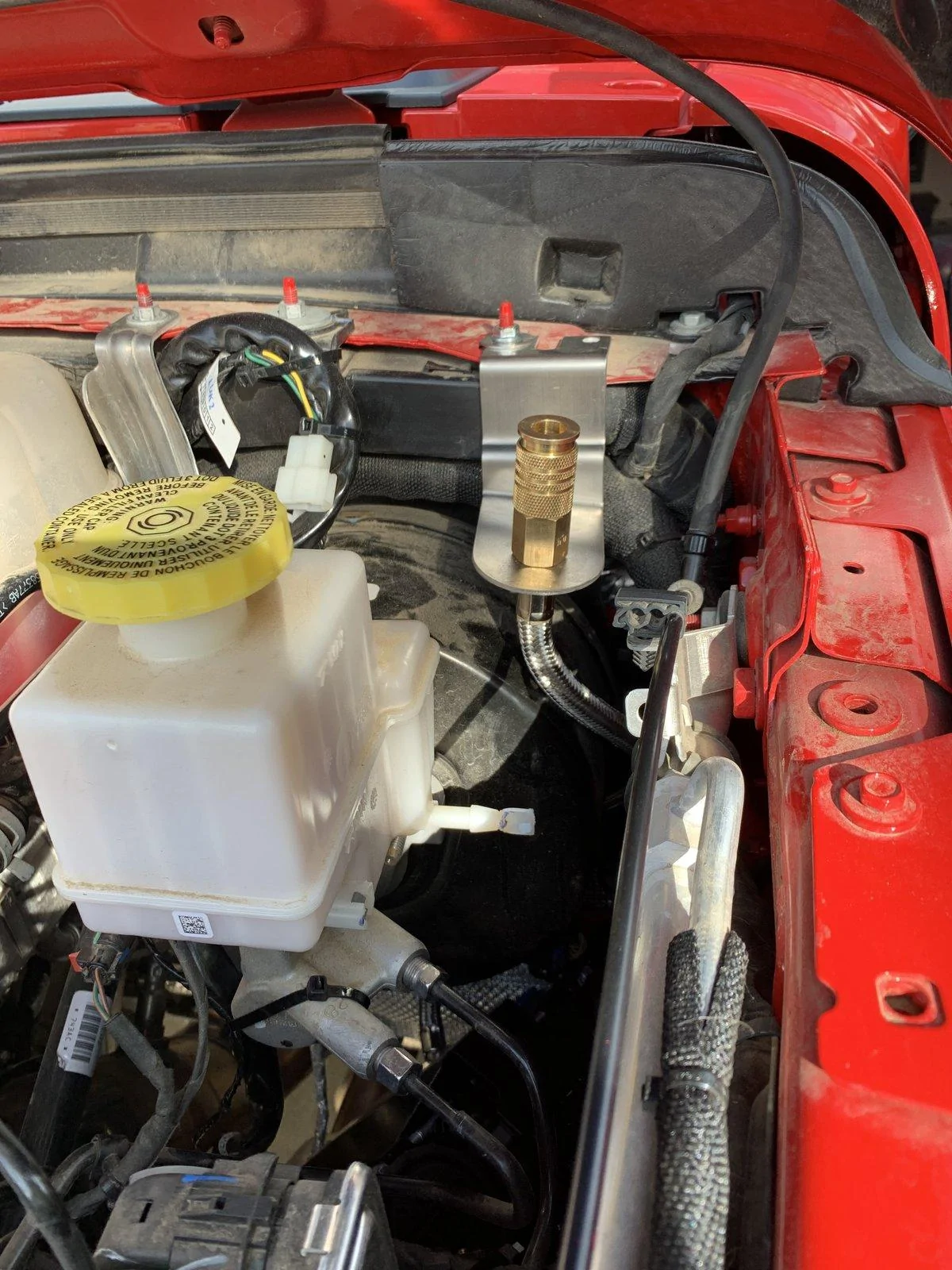

Added some jewelry to the “red queen”... on board air. DV8 bracket, arb twin compressor, braided air line, a left over cb mount bracket and a air coupler.

Where did you source the bracket? Looks awesome
